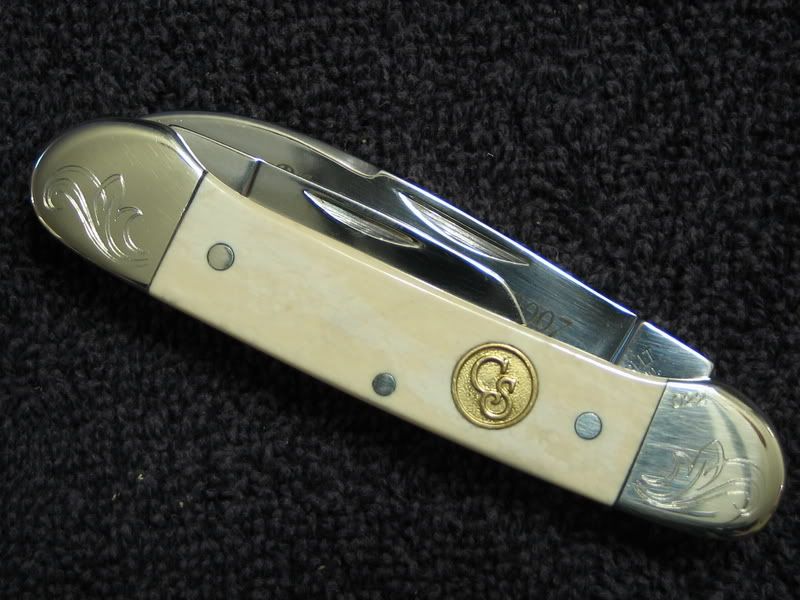

Little surprised to see that the grinds are significantly off, clean, but not centered at all, anywhere (I take that back, the coping blade is relatively centered). I never expect perfection from a knife in this price range, but Cases etc usually have better symetry.
I've looked these grinds over and I'm going to go out on a limb here and say the small blades are ground off center for a reason. On my knife the mark side of the small blades barely have a plunge line while the pile side has a deep plunge(almost a chisel grind). In effect, for a right handed person, this makes a better angle for whittling. It's so far off center that it had to be done on purpose.
Mine has the main and the pen blade just a tad above the liners as well. I too will probably file the kick down a wee bit on down the road.

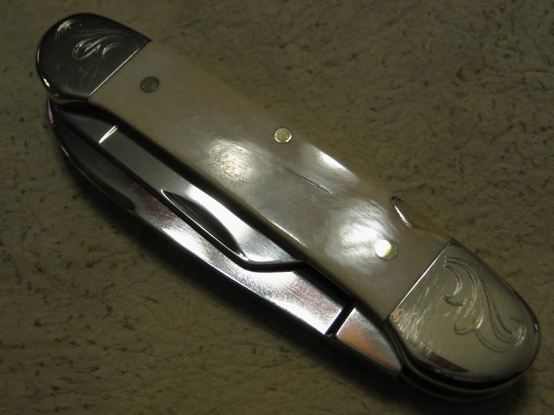

After carrying my Canittler for a week (since I got it), the scales are getting worse. When I got it it had some "crazing" in the ivory, and a few faults where there was no "surface finish" for lack of a better word; Dark spongy bits showing through the ivory surface.
Well, now several of the "crazes" have shown themselves to be cracks, and one in right near one of the pins. I just had to push a piece of the ivory back into place. :( I guess I'm going to have to send it back to be rehandled.

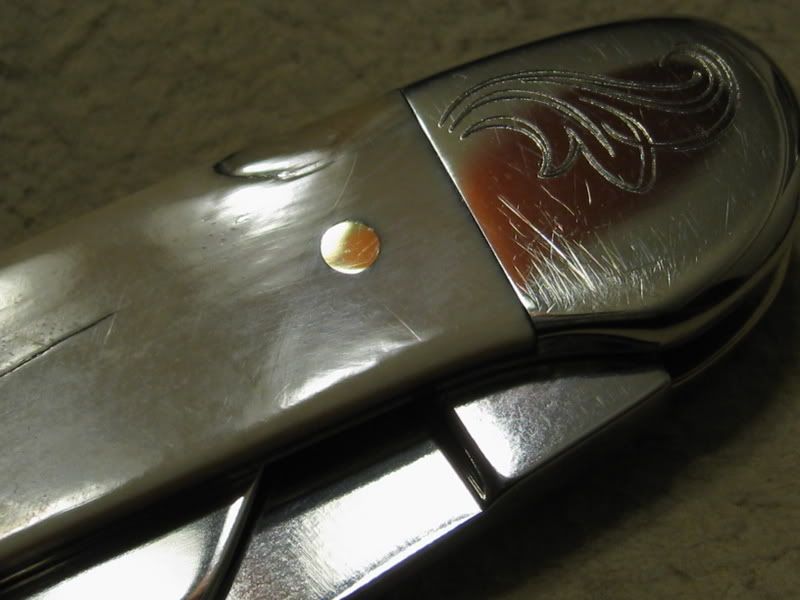

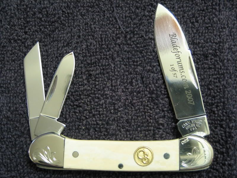

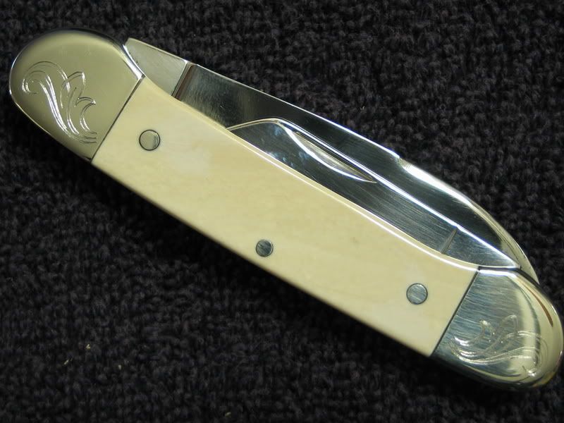

Just got back my #022 from CSC. As you may recall, I had to send it back (shipping and insurance costs at my expense) to repair the scratched bolsters, and heavily cracked ivory. The ivory was cracked and splintered surrounding the shield and reverse side.
Wally Gardiner, one of the owners of CSC said he would take care of it, and he did.
Below are pictures before and after. The before pictures are only of the reverse side, as that was the side I was documenting the scratched bolsters.
Jay
Before.....
After....
Looks great Beaver, I like the color. Glad they took care of you:thumbup:

They replaced my cracked scales, and it looks fine. The new ones don't have the lines and "crazing" of the old ones, but that's fine with me: All that "character" turned into cracks and broken bits of ivory.
