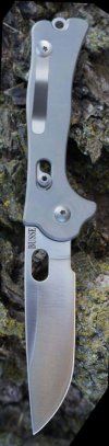

Here is a pic of the ambidextrous clip. It is tip-up carry only.
Tip-down carry is not possible with this lock mechanism as the clip will cover the thumb button.
Spine release or liner locks are the only designs where a tip-down carry will work.
The location of the clip in this pic is slightly more forward than we currently plan to have it located.

Interesting. So is that screw exclusively used for the pocket clip or is it dual-purpose? Also curious where the second point of contact is to keep the clip from rotating. Will it have a machined channel like a Sebenza, or a secondary hole and tab like a Strider? Or something uniquely hog-like that surpasses my imagination?

Clips.
That little guy? I wouldn't about that little guy.
You generally want the clip either centered or closer to the belly than the spine on a tip-up folder though, so this one is concerning. For example, Toor Knives very quickly made this correction to the Merchant 1.0, putting the clip near the belly of the Merchant 2.0.
But I'm not too worried about the clip: the aftermarket will probably jump at the opportunity to provide custom bent and milled clips to suit various carry options.
Alternatively, with a 4.7" handle, this is going to energize the folding-knife slip-sheath and belt-sheath market. Kydex too. I bet Dave Brown can do something that integrates a molded kydex keeper for the lanyard hole.
