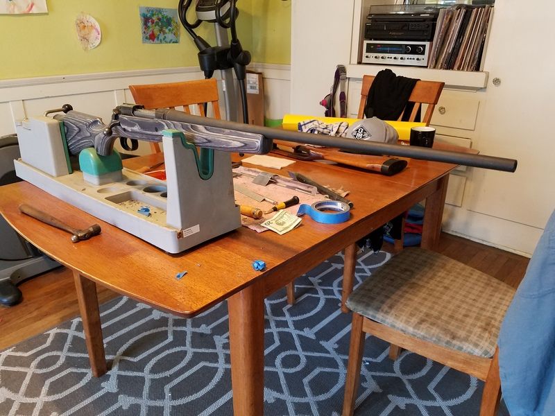

Got the day off, so I started early this morning working on my new rifle stock. Needed to modify the inletting so my aftermarket trigger fit in there as well as open up the barrel channel a bit to give the .040" clearance away from the barrel as that's the amount I think looks right. Got it fitting pretty good now. Fits snug and everything lines up nicely.
I think I'm going just mount the scope and leave it right now, work up a good load for it and worry about sandblasting and coating this winter after the hunting trip.
I do inletting the old school way, sharp chisels and lots of test fitting. I don't have a vise to clamp the stock and use end mills.
New barrel is nearly 3 inches longer, should get me just about 100 fps more velocity.
Hope this thing shoots good, as much work as I have put into it over the last decade... but being built in October 1918, I'm not going to give up on it, it deserves it!

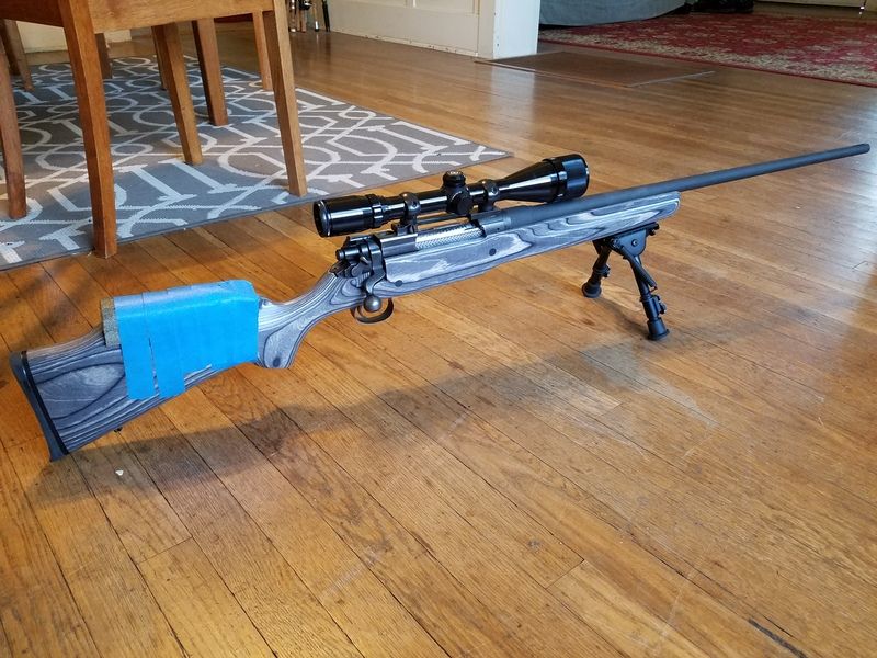

And it's now functional! Excuse the blue tape over the foam, I do that to figure out how much elevation I need to add to the stock with a cheek rest. I need 7/8" rise for this one, a 1" slip on tactical riser will work perfectly. Metal needs to be coated, but that's just cosmetic. Scope leveled and bore sighted, should be on paper at 100 yards from the first shot.
Getting excited about this gun again!
-X
Xander that is looking good!!! Nice work!
