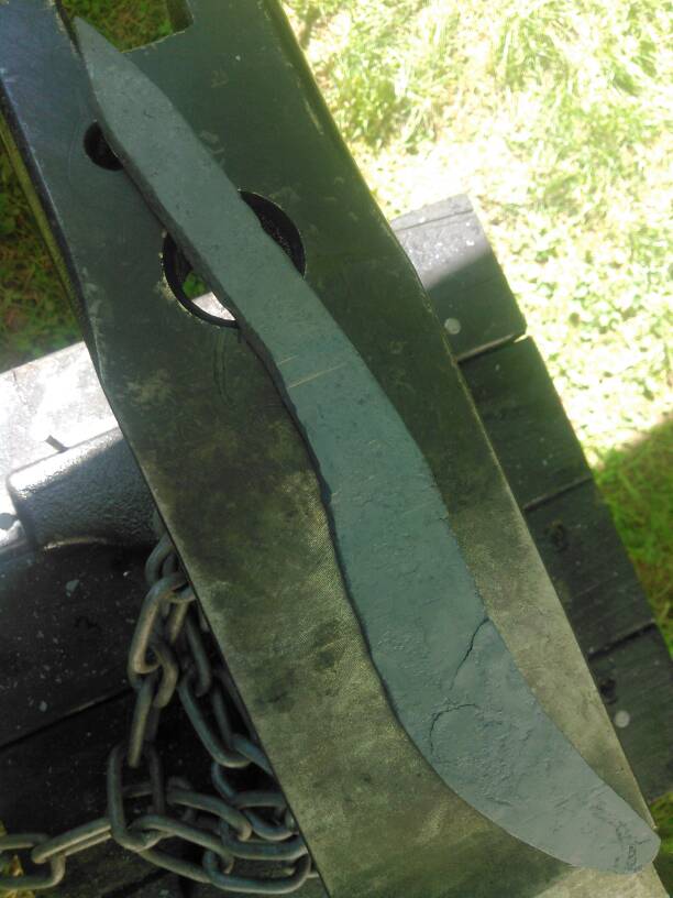

Working on a rail road spike knife right now. Almost done with the forging, then comes the grinding.
Sent from my KYOCERA-E6560 using Tapatalk
Nice.
I've thought about doing one, but it's not as easy to find the higher carbon spikes as one might think. Around here most of the time all I find are low carbon spikes, so anything made from them can't be hardened.
Even the so-called high carbon spikes can't truly be hardened. But it's a fun exercise and the knife can still be useful.
Yup, either as letter opener or a stabby thing 😝
The "High Carbon" railroad spikes have a maximum allowed carbon content of 0.30%. This makes it essentially A36, or at least very similar, as A36 has a Carbon range of 0.25% to 0.29%. A chart I found a while back lists the break down of A36 usage. The thinner stock has only a trace of manganese, where the thicker stocks vary between .8% and 1.2%
3/4" and under - 0.25%
Over 3/4" to 1-1/2" - 0.25%
Over 1-1/2" to 2-1/2" - 0.26%
Over 2-1/2" to 4" - 0.27%
Over 4" - 0.29%
A36 is called "mild steel" and is usually what the steel billets at Lowes or Home Depot are. The lower carbon content prevents brittleness. A statement I saw a while back on the internet about the subject said that the railroads want steel that bends, not breaks. "A bent spike will still hold rails. A broken spike will not." Or words to that effect. :D
I use a lot of A36 for prototyping my knives. It's a lot cheaper than any "real knife steel" and I can figure out balance points, overall weight, tang/handle thickness, etc. Some folks can figure that stuff out with mathematical equations, but not me. :D I need to hold it in my hands and make determinations and changes by hand/eyeball.
The "low carbon" railroad spikes have a maximum allowed carbon content of 0.12% carbon, so it's really soft.

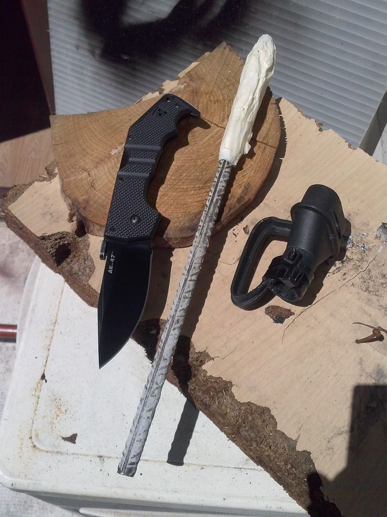

These in the pics have been widely used, and carried during years, did them when I was younger, had wilder thoughts and much free time... :D
Being so cheap, and easy to find, many lengths and sizes available. They're the classic cheap bonebreakers.
You can try the one that best fits your strength and body size
Easily replaceable, and not hard to conceal or carry (I have made some "belt attachments" with hard plastics and a hot air gun, darn efective
And also important: they are disposable, use and throw
Steel is stronger than bone, always. Wood is nice to practice and check for vibrations hurting your hand/compromising grip
Really quick handles work just fine, and you can find the tape/wrapping for $1 at any convenience store or wallmart...
The only problem with such is that it's very hard to keep your fingerprints off the tape used in making the handle.
