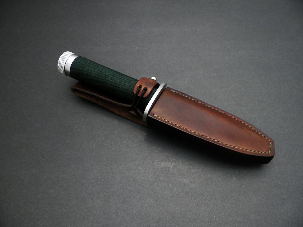

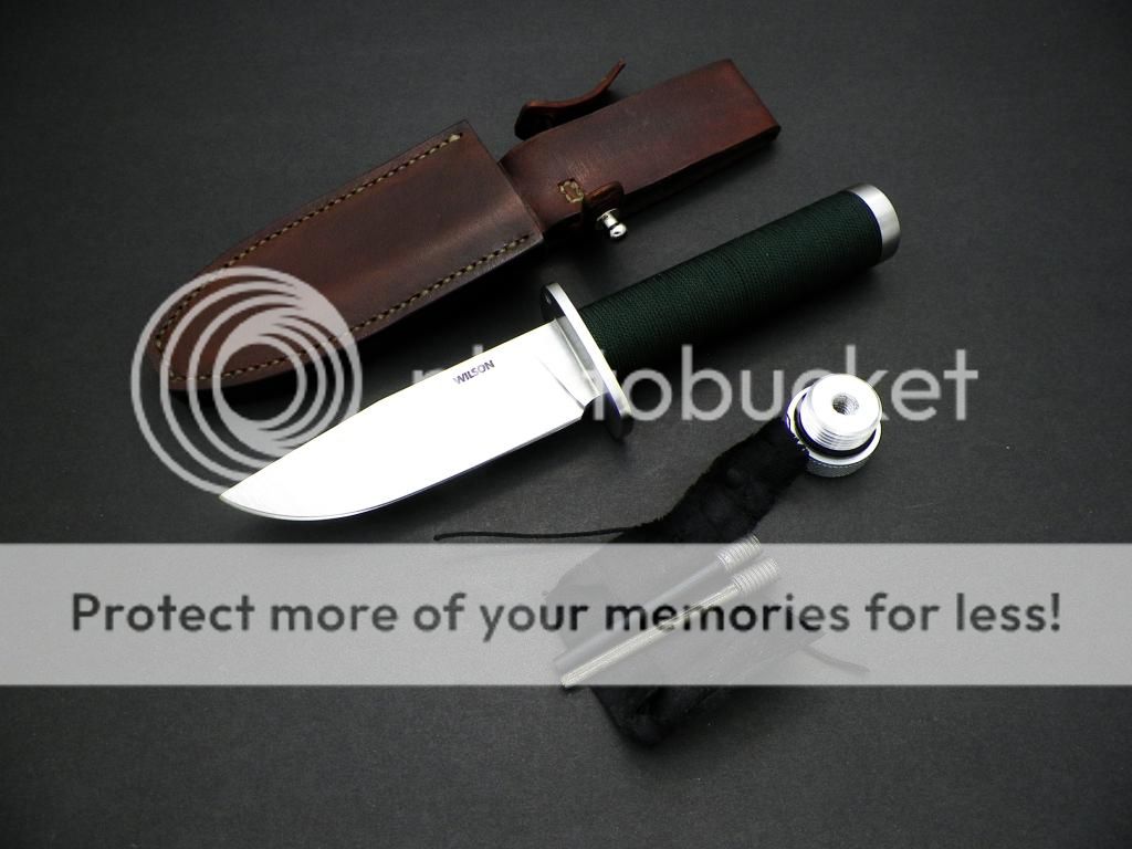

Hey Guys,
I just got my new knife from Sam and I am very impressed with his work. This one has the lanyard holes in the guard. The angel of the blade is 19 degrees, which I think is perfect for a knife like this. I will be posting more pics, comparing Sam's knife with some other hollow handles, when I get some time.
Pictures are courtesy of Sam Wilson
Welcome J-Utah. Great looking knife! One of the most practical, sensibly sized HH knives on the market.
Sam, you knocked this one out of the park. Really like the green cord and brown sheath. Well done....as usual. You know you could change it up a bit and make an ugly knife at some point. The visual perfection of your knives is starting to bore me. :D
Guns, thank you for the honest review. I have to agree with the others, that was a really well done writeup. Covered all the bases, including pros and cons, and wasn't just a fluff piece. I appreciate the fact that you actually used the knife, too. That's what I made them for. I also appreciate not being penalized for not being able to baton through 6" rounds :D.
J-Utah, I am glad you are happy with it, and welcome to the thread. Looking forward to more pics of your other knives, and of any of the SAFE knife in use. Let me add a couple of yours to my post, if you don't mind.
Thank you, Tom. The green and brown go really well together, I agree. I've made plenty of ugly knives, they just never make it out of the shop :D. But I'll try to change it up for you, lol. For those that don't know, Tom was involved and very helpful in the design of the S.A.F.E. System, and for that I am very grateful. Thank you, Tom.

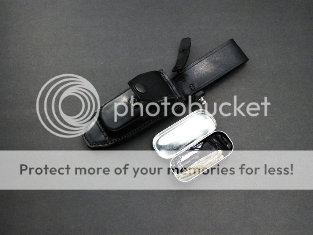

I did a pouch on the front of Guns’ sheath for an altoids tin, as you saw in his pictures. This obviously allows the storage of more gear than just the hollow handle. That being the case, and I know this has been discussed a number of times, but hey, this is a pretty free-ranging thread and we all love to talk about survival stuff. So what do you guys like to put in your sheath pouches in the way of additional gear?
I have wanted to get some opinions on what I call my Basic Kit, which obviously goes in the tin. Now, just like what goes into the hollow handle, this is not meant to be exhaustive, nor your only kit. But it is some extra gear that is easily carried. Additionally, I know that survival kits are usually very personal, so this is meant to be just what it’s called, a Basic Kit. I didn’t jam it full of stuff, both to allow people to fill it themselves, and to keep cost down.
I have included some of the things I think are most important, and the best versions, size/quality wise as well as economically, in this kit. There is still room for additional gear, and/or substitutions.
So first, here is a pic of it all assembled. Guns had posted a pic also, but that was on the last page.

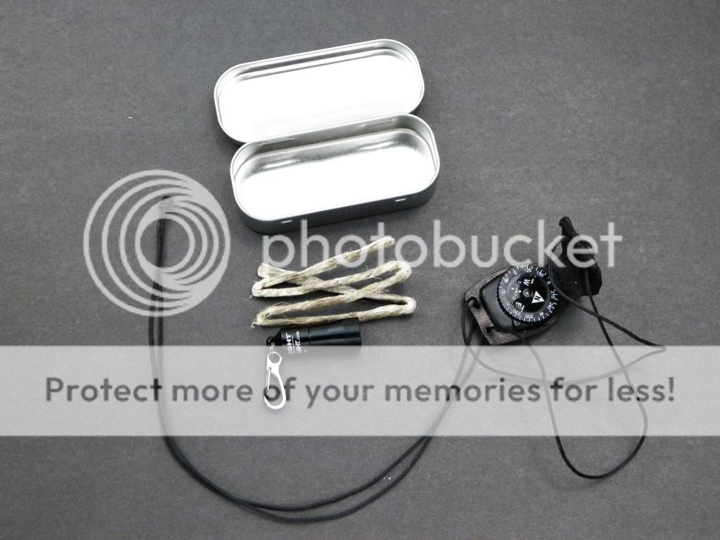

Opening up the tin, we have the Basic Kit itself. I have only included three basic items. However, based on all the research I have done, and personal experience and talking with others, most “survival situations” last approximately 2-5 days or less, with 72 hours being the actual number that is given most often in the articles/books I have read. That being the case, I wanted to focus on the extreme basics, and honestly, food or hunting just wasn’t very high on the list of priorities.
Now, I am not saying that someone wouldn’t get hungry in that time, obviously they would. But if we’re truly talking 72 hours or so, food is not going to be very high on my list, personally. Obviously, opinions vary. I would be more concerned (I think) with staying put, not getting injured, conserving what water I may have, and staying warm/dry/safe. That’s just me.
So all that being said, in no particular order, we have:

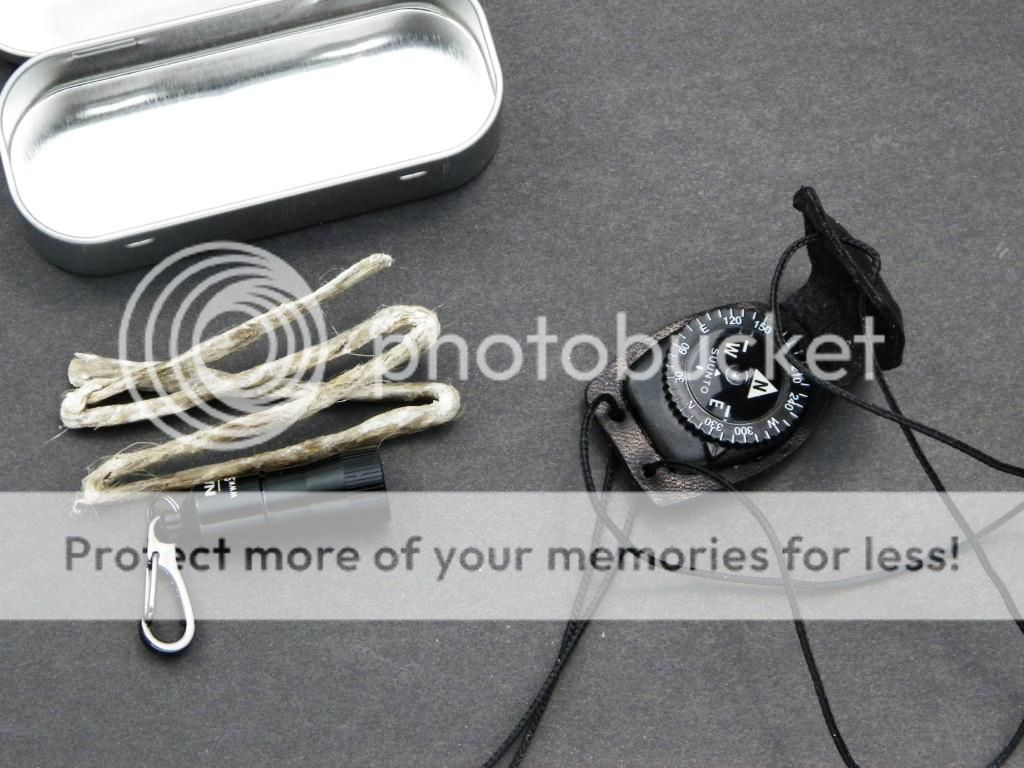

1.) The flashlight. I think a flashlight is very important, not just for safety, but also morale. Especially if you don’t have a fire yet, or can’t get one going for whatever reason, or have to try and start it at night, a flashlight gives you an instant source of light, available immediately. The clip also allows it to be hooked onto things for suspension, and can also be taken off and used for other purposes.
2.) Tinder. There are many different types of tinder, and everybody has their personal favorite. I’m not saying this one is better than another. I do believe this particular type offers some advantages, and that is why I chose it. This is jute twine impregnated with wax. Unlike cotton balls covered with petroleum jelly, which work great, this is practically mess free, all things being equal. Also, it takes much less space to store. I made this having five equal lengths of approximately 3” each. I did this so that at each bend, you can just cut it and have a 3” piece, which I have found to burn approximately 1 ½ minutes, at least. Obviously, they can easily be lit with the included ferro rod, or whatever source of ignition you have. That is plenty of time to light your next bit of tinder, and will burn long enough to even dry damp tinder out and ignite.
3.) The Compass. I really enjoy this part, because this is a departure from the usual navigation aid that accompanies a HH knife, which is often a small button compass in the buttcap. There is nothing wrong with that method, but I will just say that I have had less than stellar experiences with several button compasses over the years. The only one I would really recommend, and do so heartily, is the brass NATO compass. This is the compass that I offer with some of my knives, and works great.
That being said, I much prefer a larger compass, and carrying it outside of the buttcap. This prevents the compass from being damaged if you pound with the buttcap of the knife, and also avoids having to remove the buttcap every time you want to take a bearing. I make a leather pouch or sheath to hold this one, and it has some cordage that allows it to hang around your neck. To me, this is infinitely more convenient and faster than in the buttcap.
When you want to take a bearing, lift the compass, open the protective flap, shoot your bearing, and then close the flap again. The weight of the compass while hanging will help to keep the flap closed, and in an emergency, the cordage can be used for other purposes.
OK, that was my .02, what do you guys think? Suggestions, critique, your own kits? Let’s have it.

My basic, on knife kit is very simmilar to Sam's. No matter what knife I am carrying I always have:
1) Tinder (I have used dryer lint or cotton balls with petrolium jelly, but will probally switch to twine based on Sam's reasoning)
2) Fire Starter (Usually ferro rod. Ocassionaly waterproof matches)
3) Sharpener (Small diamond rod or stone)
4) Duct Tape (A few feet pressed into a small square. This could be used for gear repair, bandages or blister control)
5) Sewing Needle (This item takes up virtually no room and has a ton of uses. Used to treat blisters or dig out splinters. Could be used to repair gear, although I have never bothered in the field. Rambo could use it to sew up a wound. YouTube Guy could use it to make a fish hook or a compass floating on a leaf)
6) A couple of water purification tablets to be able to treat 2 or 3 liters of water. Again, these take up hardly any room in the kit.
Sam's SAFE knife has the ferro and diamond rods along with wax impregnated cloth rolled up neatly in the handle with a ton of room left over.
When I carry a hollow handle with an outside pouch, I will usally add some single use antiseptic pads or salve and a micro flashlight.
I don't carry a compass on the knife, unless it is built into the cap, but usually have a small brass one attached to an article of clothing or gear and a large one in my shirt or cargo pocket.
My kit is heavy on fire making supplies, but the other items that Sam and J-Utah mentioned would be next in line.

J-Utah, those are some excellent additions to a kit. In my personal kit, I keep a small sewing kit, which I wind up using more than I should, for the reasons you mentioned. A sewing needle is very handy. I have also repaired my clothing and gear several times over the years, so I may need to add a sewing kit apart from my pouch so it stays untouched.
I also keep about water purification tablets as well, and a zip lock bag to use them. I had not thought about the duct tape, though, so that is something I will be adding soon.
I also have a small fishing kit, basically a length of line, a couple hooks, and a sinker or two. I have thought that if I'm ever in that situation, they would probably be more useful for helping me keep my mind off the situation, I don't know.

BTW, I really like the pouch you made for the compass. Another great idea! That Suunto compass is the best liquid filled compass on the market. I have several of them and none have formed a bubble.
