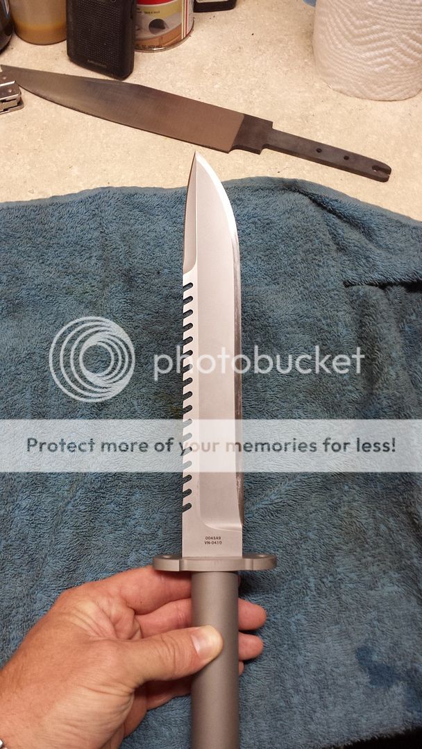

2 of my hollow handle knives.. A South African Shadow I, and a USA Shadow II, numbered and hexagonal cap.
I know these are not Lile, Neeley, or Colin Cox or Martin, but I love them anyway... And I love ALL of the hollow handle, thanks for this thread, it is one of the most interesting I have ever read..

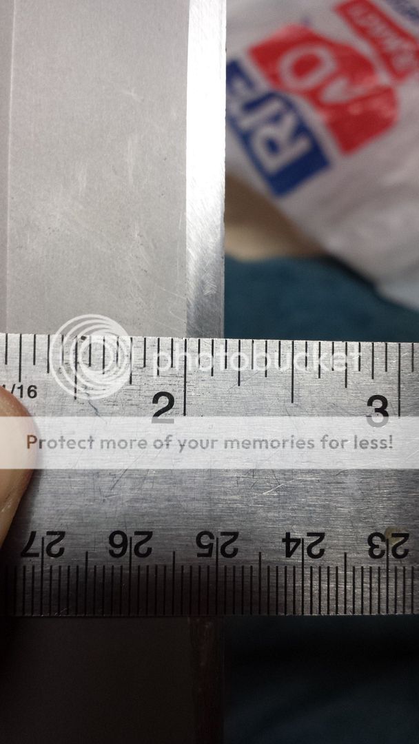

Below is a picture of the ridiculously oversized bevel you put on the knife. I explained to you very clearly that it was far in excess of "ideal," especially for a heavy knife like that made out of 440C and being used for heavy chopping.
You keep coming back over and over about that tall bevel, yet you always fail to mention the edge shoulder was 0.060" thick. Now why would that be?
When I examined the knife, the cause of the edge damage was very clearly the fact that it had a paper thin edge and the secondary edge bevel was nearly 3/16" wide, as is clearly shown in the photo below. I'm sure you're going to explain how this is ideal for some bizarre purpose, but in short, the answer is No, it's not. It looks hideous, it performs poorly for the heavy work you're subjecting it to (as evidenced by the repeated failures you have experienced), and in general is a real waste of a fine knife.

Neeley: 0.060" edge base, 15-17 per side edge angle, and severe damage in 30 hits.
Model 12: 0.020" edge, 10-12 per side edge angle, and no damage in 800+ hits on the same wood...
I doubt that the "paper thin" 0.060" edge on the Neeley was even below 17 per side... By the way, just how thick are the edges on your knives?...

Pretty simple here. That secondary bevel and edge thickness are too thin to support the kind of chopping and work that you are doing. This is evidenced by the fact that it is failing while you are using it in this fashion. You can go round and round all you want about the hideous bevel you put on there, but it doesn’t work. So you should be arguing with yourself, since you did it. I’m simply telling you it won’t work, which it doesn’t, as you have just confirmed. I don’t see the problem.
But what were the measurements of that bevel, or are you about to concede you have no argument?
Hardly addresses why other much thinner knives are succeeding.
