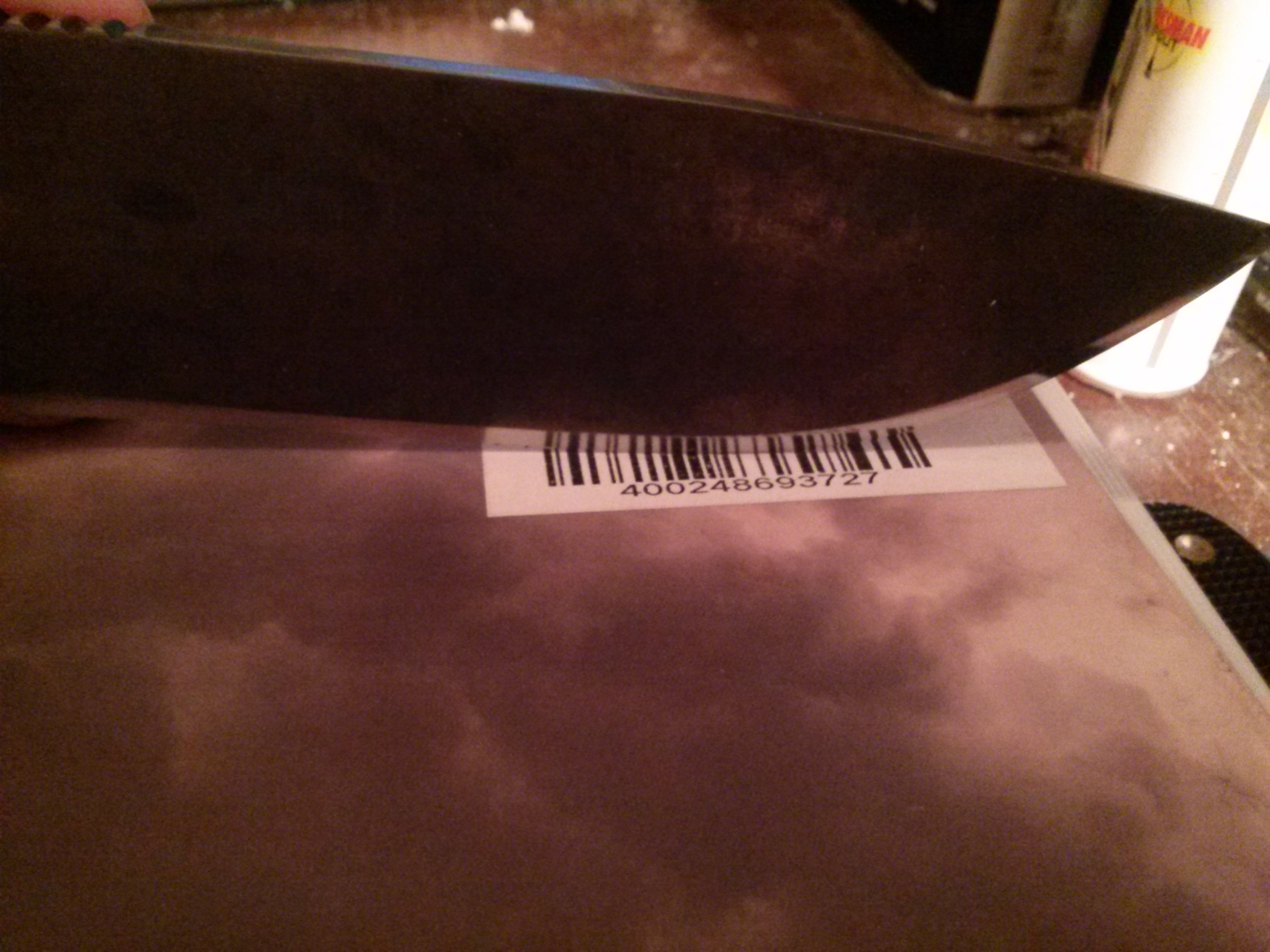

So I decided to touch up my esee 4 on some old 2000 grit paper, and I ended up with by far the best polished edge I've ever done. It figures the one time I'm not trying to get it and it happens. I wasn't able to get rid of all the scratch marks, but progress not perfection I suppose.
Looks great man! I love sharpening with sandpaper. It's super easy and gets great results. Plus, touch ups are a breeze!
If you had a sharper edge part way through and when you got done it wasn't as sharp, you may have been feeling a bit of a burr or wire edge. On the other hand, you may have felt the edge (when it felt sharper) BEFORE it developed a wire edge, and now it has one? That could be the case. Try stropping it more and see what happens. It sure won't make it duller.
All that said, I wouldn't obsess over it. Just try again next time it needs it. Otherwise, you risk taking years of usage worth of steel off of your blade chasing "perfect sharpness".
