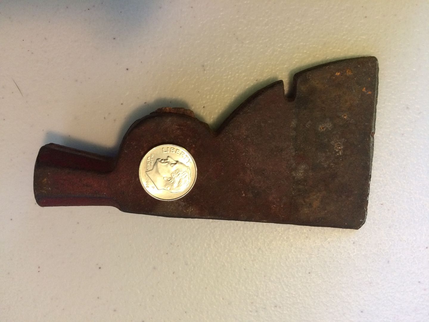

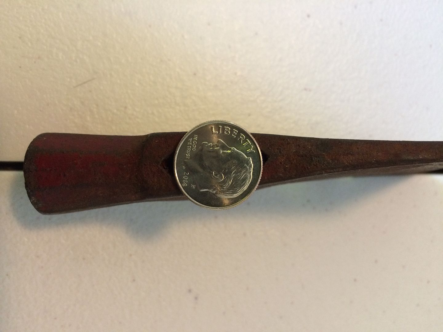

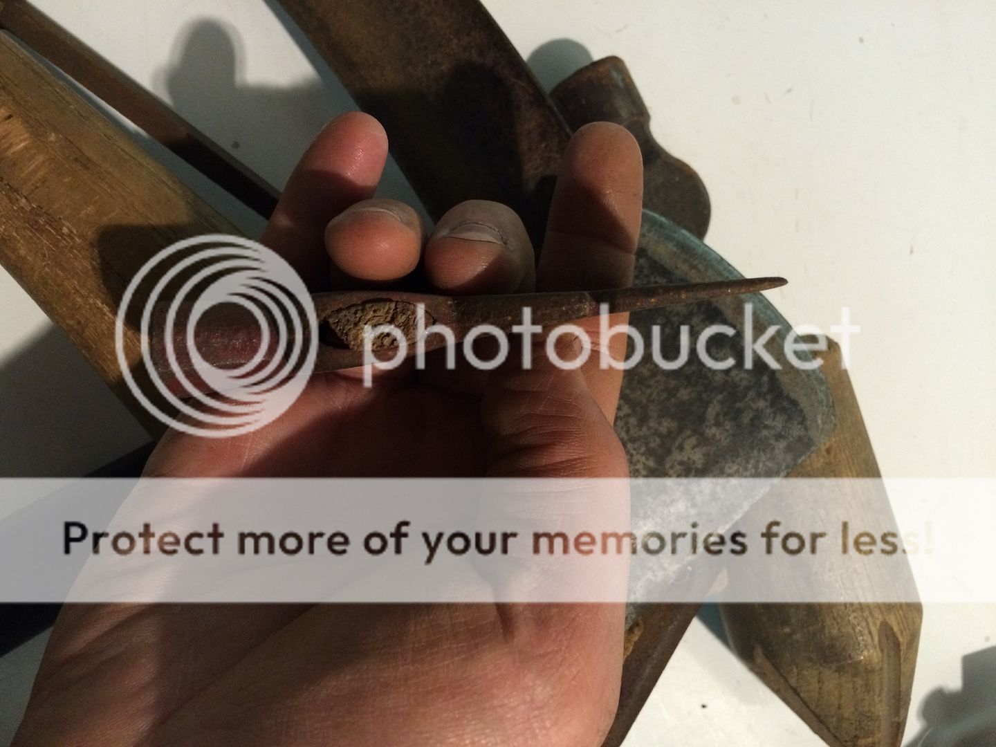

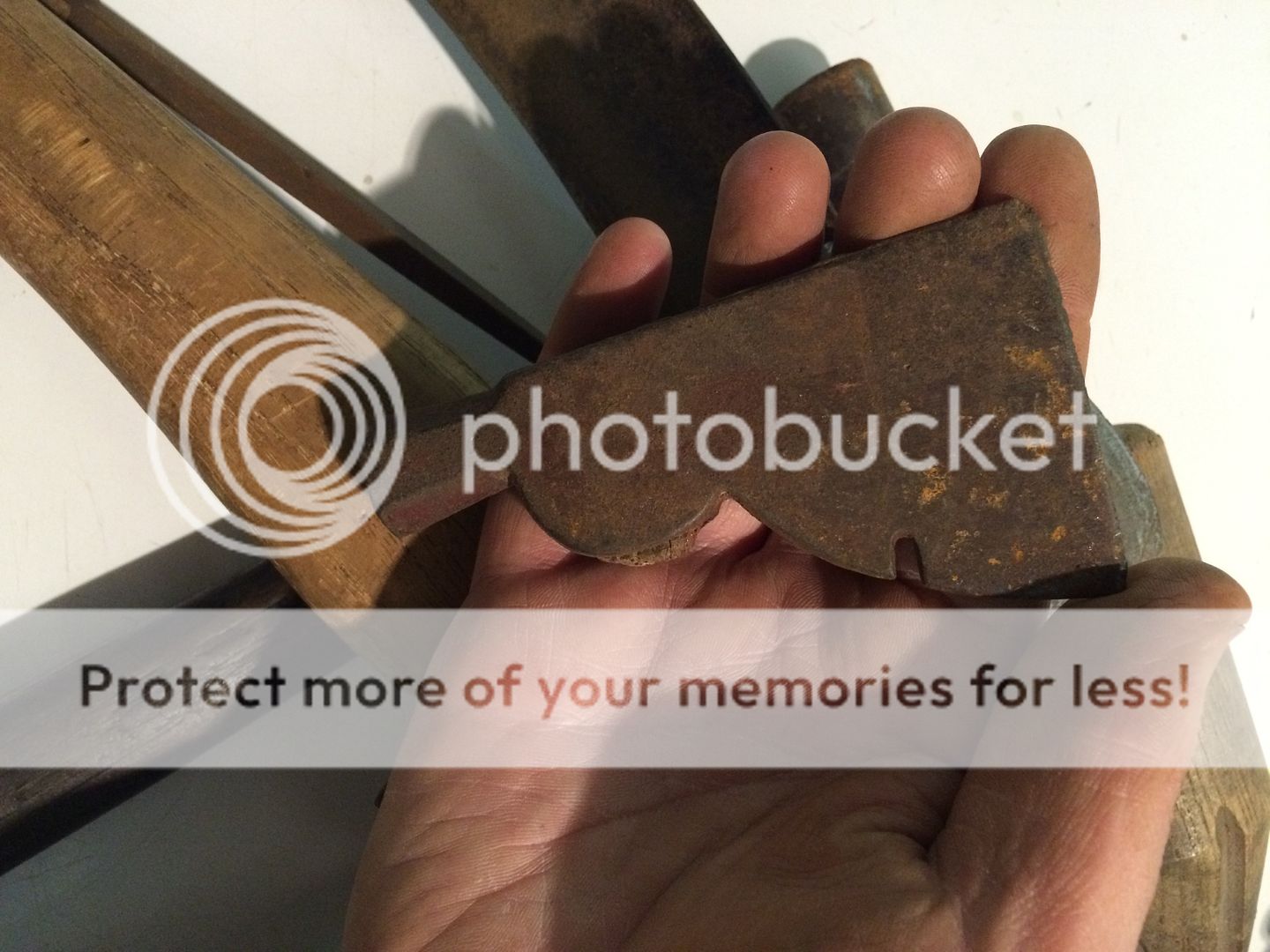

Looking for a little help trying to put together an order at HH. I have two of these heads and a Craftsman mini hatchet. I think the ones in the photos are tomahawks?? The Craftsman I can probably thin down a full size scout/camp axe handle though it would be a LOT of wood to remove.
What about these? Thanks.
I've seen a number of those on the bay. I've been curious to find out if they actually take/hold and edge. You will want a straight handle for sure. HH has a TACK-BRAD HAMMER HANDLE that looks like it could be a good fit. There are others that are similar but I would look for something along those lines. The only issue I can see is since they are ment for small hammers you might need to adjust for the length of the eye. With that in mind you could just pick up a typical claw hammer handle which has a long eye and just thin it out to fit.
I've hung two of the Mini hatchet heads so far and I must say I find them more difficult than anything else I've hung so far. Both have ended up with gaps that I'm not happy about. And I will likely be redoing at least one. Take your time! Don't worry about thinning down the handle it doesn't take near as much time as you might think, that is the easy part IME.
Thanks. Looks like the back half was red at one point and the portion from the nail nick to the blade was not painted. I found two of them and a Craftsman mini hatchet in an old box of my grandfather's stuff. All that I know is that it was generally in the boxes with his woodworking tools, however this box (an old oil can with the side cut off) had about ten or so broken hammer and mini hatchet/hawk/axe heads --so for all I know that could have been his "broken" pile at one point.
I just don't know what to do with it...
Hacked, I have no idea what brand they are and I know nothing about them. They feel like they were mass produced, almost cast, not forged. I mentioned in an earlier thread I almost thought it was a child's toy because of how dull/blunt they are. Because there are no stamps or markings, my gut says it was just something he picked up at the hardware store or purchased on a whim vs. an intentional buy... then again there are two identical heads and a very well used Craftsman mini hatchet all in this same box so I could be wrong. As an engineer, he (my grandfather) was a bit OCD when it came to tools but he always bought top quality, name brand stuff so these things confuse me.
I'll put an edge on one and let you know how it takes. I think I'll try the tack hammer handle from HH you suggested and see how it works. What should I put on this Craftsman mini hatchet? Thin down a scout/camp axe handle or just get three (probably four because I may break one) of those tack/brad hammer handles?
Thanks.
Thanks.
At some point I plan to try thinning down a scout hatchet handle for one of my heads, I basically have 3 at this point. I think it will work out well. The only thing I can think that would be problematic is the kerf. Obviously you can appreciate how narrow the eye is on these little hatchets. The kerf needs to be as straight and centered as possible and thin. I use a very thin pull saw to cut mine. I feel like 11-12" overall length is about ideal for these little hatchets. I tried a longer handle and while it works well for chopping it can be awkward in other uses. This length would allow you to use a 14" inch scout handle cut down I believe so that you can cut your own kerf. I have to stress that with as tiny as the eye is getting a good fit is a royal PITA. I still haven't found the best method.
