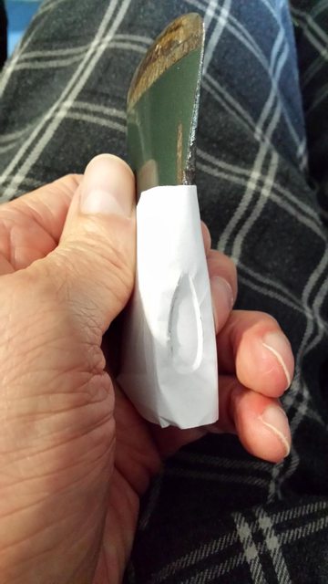

You can pound in the wedge on a full sized axe or even a scout hatchet and it will swell enough to fill any small gaps but i didn't see a wedge this small doing that. I made a template of the eye on this mini craftsman to help me work it down to fit better.
I'll be sure to post some pictures. I have to wonder if a single cross wedge would work best? I might experiment with that idea. Even the slightly larger eye on my 14oz head was a breeze by comparison.
