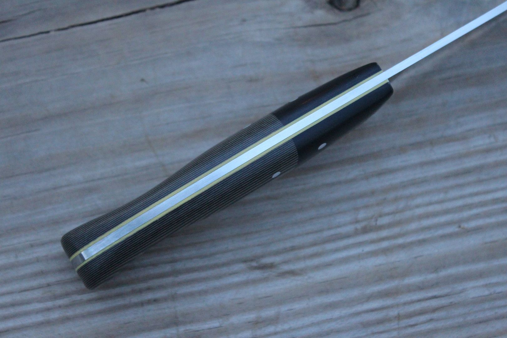

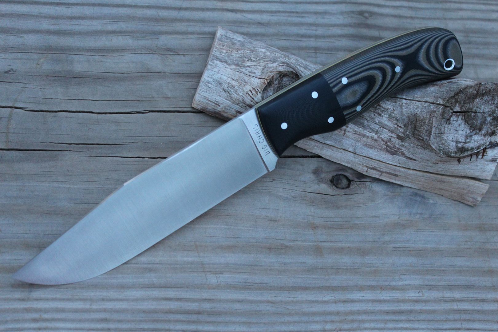

I finished my sheath this afternoon so I will post the pre-sharpening pictures. It is .095" CPM M4, the blade came out 5.56" tip to scales, heat treat by me to a 64-65 Rc.

Good lookin knife BC. We still need to get together pre gathering since we are so close. Really stoked to hang out with ya this May!
0.095" steel - that knife will rock at food prep Chris.
Slicing dicing machine......
Thanks Bruce. I really like the thin stock but it can be a pain to work. This is the third knife I made for the challenge. The first one broke while straightening, I was not pleased with the grind on the second, and so I ground this one after HT.
