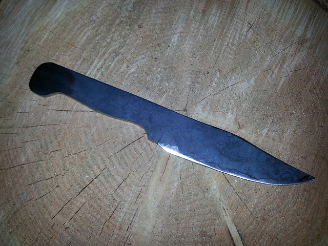

Look great guys! Mine looks very similar to yours Elo. Here was the test blade that I did awhile back. I tweaked it a little bit but its similar.

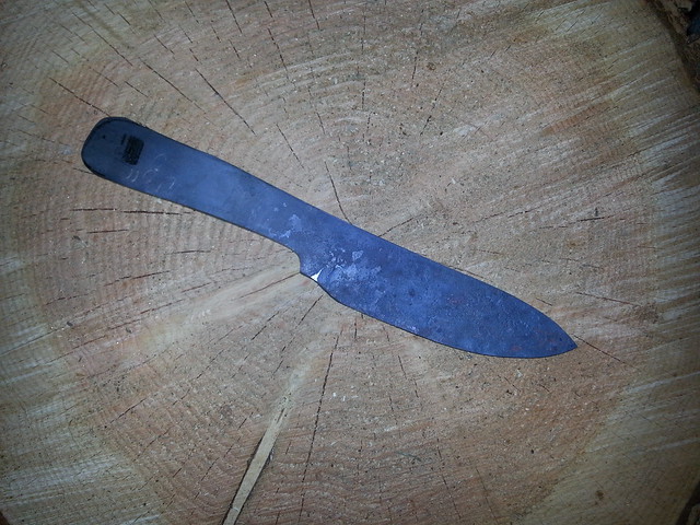

I forged mine out today. It is a hopped-up variant of my Guppy model. 1084 steel with copper and wrought.

1084 gets a bad rap from it's label as a beginner/simple steel. It is a high performance steel that just so happens to be a perfect eutectoid... which means even the most basic heat treat can achieve great results.... That truly is a super steel in my books.:thumbup:
I agree. It gets a really fine edge as we've seen from your blades. That is my idea of "super steel".
