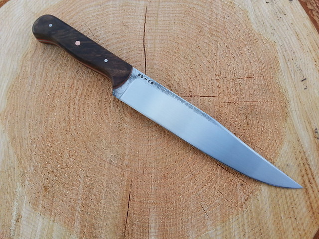

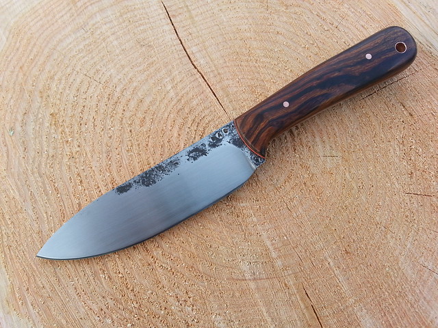

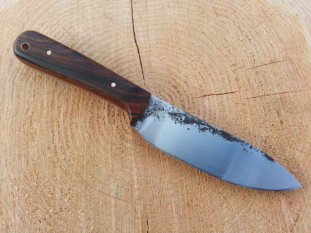

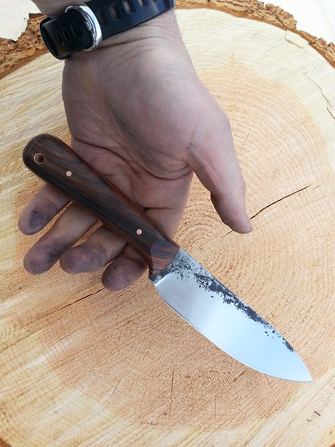

Well guys I leave for my wedding in a couple days in a couple days. I have been super busy but did get my challenge knife put together:
Untitled by bruce culberson, on Flickr
The blade is 4 7/8"" long tip to scales, handle is 4 3/4" long. Scales are desert ironwood with orange G10 liners. Steel is 5/32" 52100. Copper pins & thong tube.

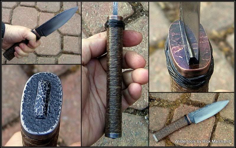

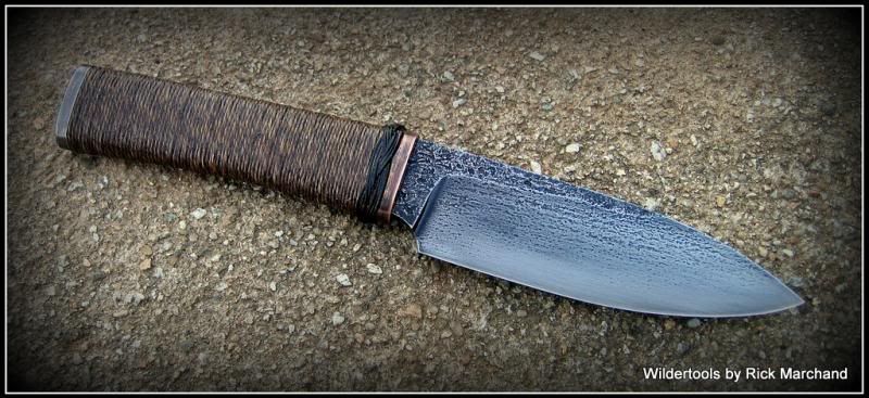

Finally done... specs and pics...
1084 Steel
3/16" Thick
10 1/4" OA Length
5 3/8" Blade
4 7/8" Handle
1 1/2" at Widest
Copper Bolster/Guard
Leather backed, hemp wrap, epoxy soaked
Mild steel butt cap
Through tang, tapered, peened
Leather cord Turks head knot
Forged/Etched finish
Sheath is veg tanned cowhide , tooled, sewn and riveted by hand
Wax dipped.
Yup. ^^^ That'll work just fine.
