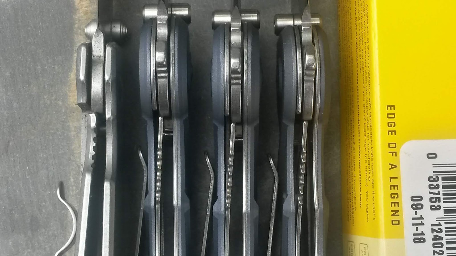

Well, the family members I was going to gift a 290 Rush knife are winners now. I am putting some mileage on the liner locks as we speak. Mine is on the far right with probably 1000+ flicks open. To it's left maybe 200 now (since this thread started) and to it's left brand new, which is how they arrived. Yes, they locked open. But really, look at them.
And that's a CRKT Squid on the far left so it's not just a Buck knife problem. And the AG Russell not pictured that almost took my finger off a few years ago, I did have to file it down to make it safe.
