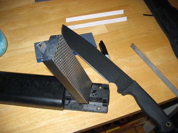

Before I got my Edgepro this is how I would reprofile blades with my Sharpmaker, just watch your fingers.:cool:
Yeah those big diamond sharpeners will cut you a new profile in no time at all, it's amazing how much steel they can remove in just a few passes, good idea putting them on your sharpmaker :thumbup:.
