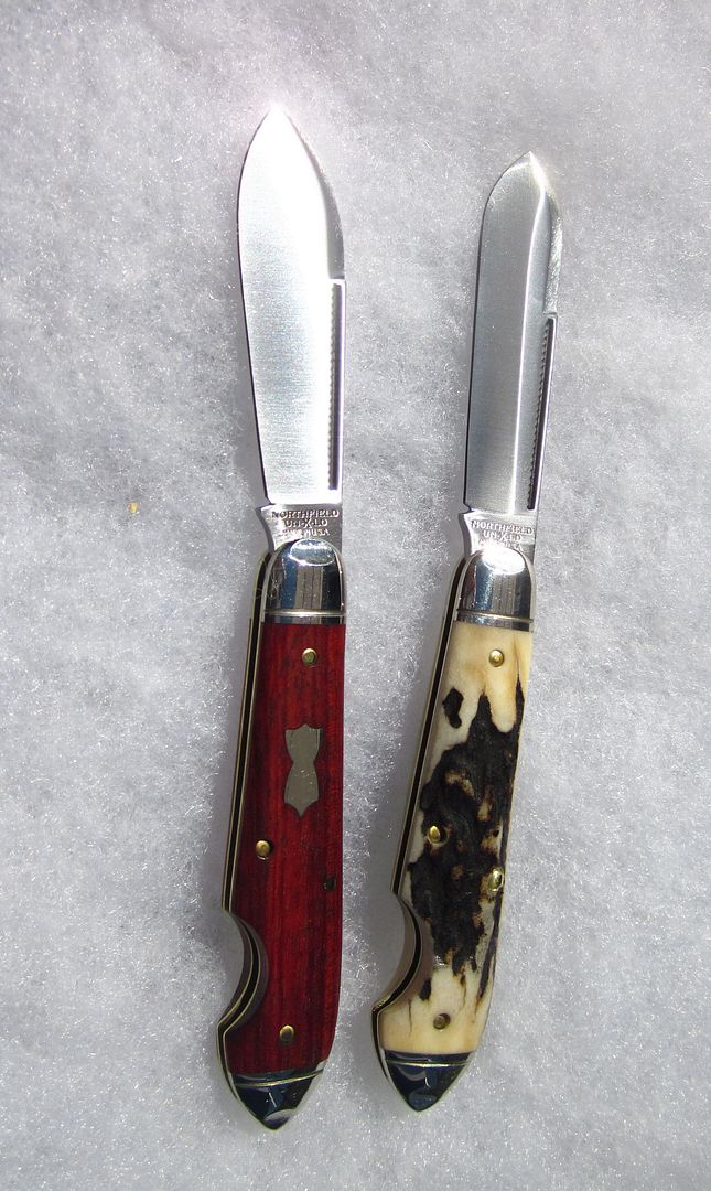

Ok, so with my stag "EDC", it came with some fairly thick polished stag for a single blade knife. I wanted to thin it down. So after careful work using my orbital sander and finish sanding by hand, I was able to thin it to my liking without grinding off the pins. The center pins were touched but not to the point that they won't hold the covers down. I also used CA (super) glue to fill all the little voids around the stag and liners/bolsters. I also filled in one crack that had a little surface opening.
It is now finished and I couldn't be happier. I'd even have to say it's the nicest 85 that I now own. It probably won't even become the dedicated "EDC" that I intended it to be!
Before:
After:
Very fine work indeed, looks like a posh Custom knife!:thumbup:
Is it difficult to hold it evenly and steady whilst using the sander? The pins look better after your 'treatment' as well.
I think the stag will age and darken very pleasingly too.
Regards, Will
Will,
I actually flipped my orbital sander upside down and braced it so that it stayed in place. This allowed me to be able to hold the knife with both hands. I used duct tape on the bolsters and taped the blade up as well (in the open position) so that the sander didn't scratch the metal.
What made using the orbital sander nice is that the edges of the pad are pliable and allows you to maneuver around the scales easier than using a flat belt sander. I started with 150 grit for quickly getting through the stag, then went to 220. The rest was done by hand using 400, 800 and then 1500 grit. After that, I touched up the swirls and stuff on the bolsters from GEC and used my drill mounted buffing wheel with some polish to bring back the shine.
I will add this note for anyone that may attempt this. Go slow with the power tools! It doesn't take much pressure at all. Move the knife around and alternate between sides. You do not want to get the stag hot. It will expand and can crack as its a porous, natural material.

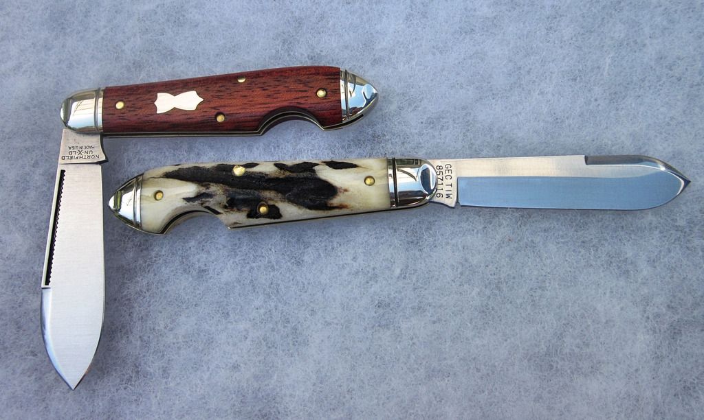

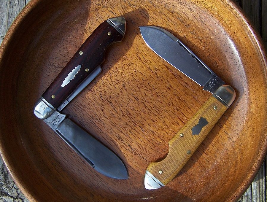

My two #85 SFO's
Posted this one on another thread but this is a better photo, which isn't saying much. But I don't think too many pics are a bad thing.
