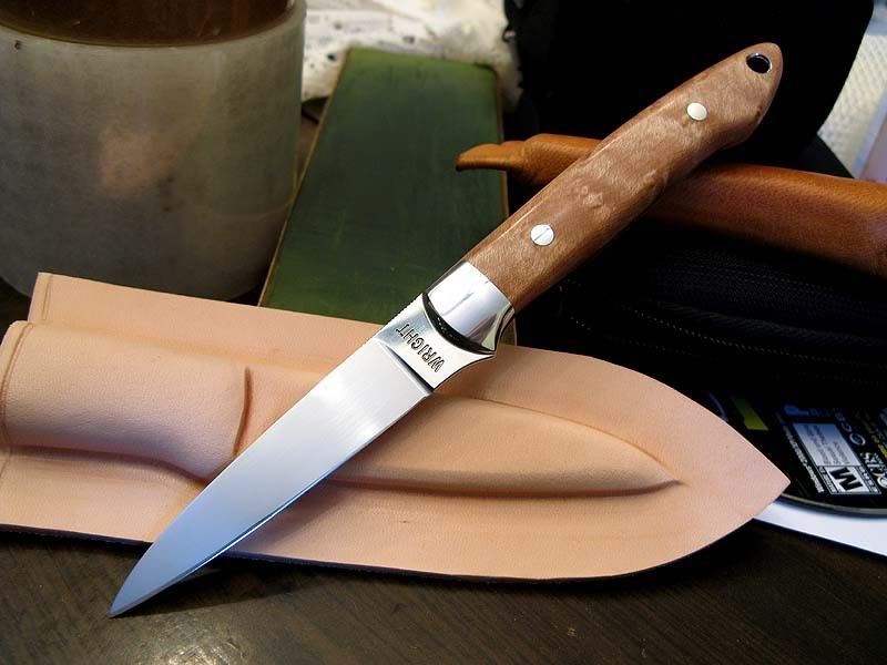

here's a shot of the knife with the top section still going through it's fitup stages
in order to keep that portion of the blade area raised up, I glued two pieces of leather
together to make it thick enough and then cut it to the shape of the blade, then I wrap
the knife in plastic wrap which holds that piece of leather to the blade, so that when I
press HARD around the knife, the blade doesn't push down, but remains up so I can form
the top section you now see.
and for good measure, here's a nice shot of the blade as well;
G2
