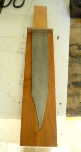

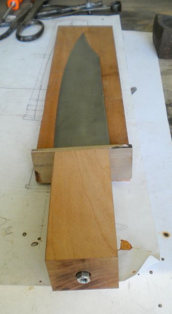

Here's my camp sword ready to heat treat. Used my texturing hammer on the flats and convex ground to about .050 at the edge. Will be a week or so before I get back to it again.

Nice looking sword DEllis. What are you quenching in? Just wondered why so thick an edge.

Stuart, it will be quenched in warm veggie oil after a 10 min soak at 1525 or so. I like to keep it a bit heavy at the edge to minimize decarb..........50thou doesn't seem too thick to me about like a dime. I don't use an anti scale compound.

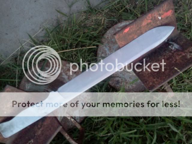

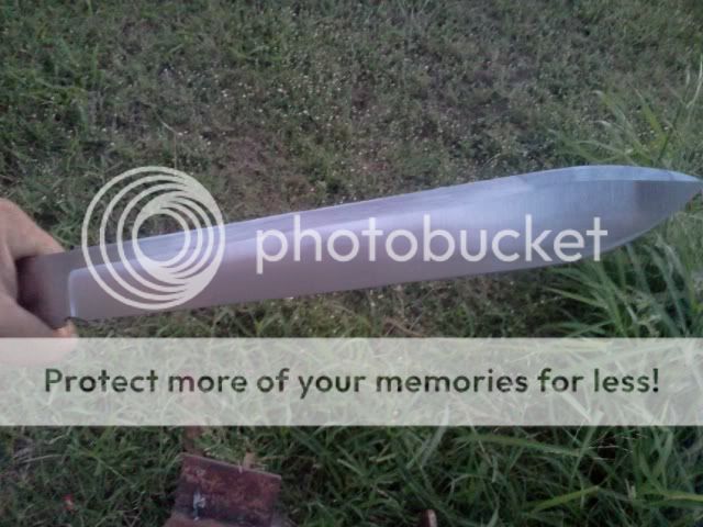

Wow, well, I'm more than a little intimidated posting my camp sword up here, especially after seeing all the advanced works by you guys. I really wanted to try a wakizashi, but I'm just bot advanced enough yet, so I decided to take the blade shape, bastardize it, and make the handle different. So, actually, nothing like a wakizashi really. Lol.
Mine started as a piece of Aldo's 3/16" x 1 1/4" x 18" O1. Originally I flat ground it, but decided to push my personal envelope a bit on this blade and do some things I'd never done before.
1. Huge blade. Longest prior to this was 4" blade and 9" OAL.
2. Distal taper. Loved doing it and will try it again on a blade soon. I don't really know what I'm doing though, so I should probably do some research and learning before trying it again.
3. Rounded spine. I just felt like this blade needed it. Don't ask me why. Maybe it was a mistake, but I like it.
4. Hemp wrap. The handle is going to be hemp wrapped over leather then epoxy over it. I need to look up a good tutorial on this as well.
5. Plungeless blade. It originally was supposed to be a high flat grind with a nice plunge, but then I really liked the looks of a couple forged plungeless blades I saw online and decided to try it. You can see the remnants of the plunge on the one side. It is actually a file mark that was an inch ahead of the plunge that I couldn't get out.
6. Semi convex blade. I did a flat grind, but when I rounded the spine I didn't like what it looked like, so I took the platen off and made 'er kinda convex. Like everything else, I need to look up how to actually do it, because I'm not sure I got it right.
I'm not sure what I'm going to do for the "hilt/guard" yet. I though about braided 5-10 stands of copper wire wrapped around the front of the scales then epoxied to the hemp, but like everything else, I haven't tried it before and I want to play with it and see how it looks before messing this sword up. Otherwise, I had thought about a heavy braid of hemp worked into the handle wrap as a guard.
Pictures:
Distal taper.
A couple in hand.
I need to run some sandpaper on a leather backed board over it before sending to heat treat, but other than that, it's ready I hope.
Comments, suggestions, advice solicited and appreciated.

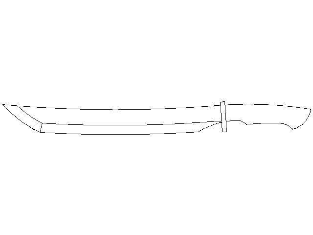

This is my design:
Blade 14", Handle 6"
Finishing this could take a looooong time, since I can only work on weekends and have to order the stock first...
Any thoughts or comments on the design would be appreciated!

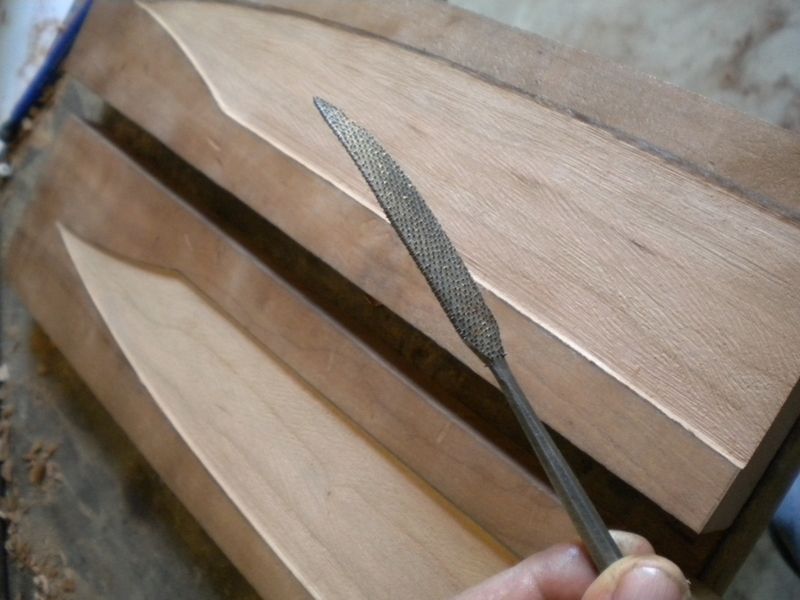

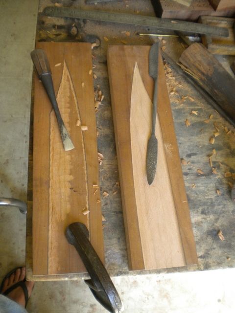

It’s a type of sculpting rasp called a “riffler”. There are lots of different shapes for all kinds of stuff.

The below isn't aimed at anyones specific blade, but is some general long blade design info.
Many first long blades are made by stock removal, and the bar dimensions determine the blade shape. Just a few tweaks in the shape can make a long blade/short sword much more appealing. In a forged blades, shape and curvature isn't an issue, but with stock reduction, a little bending of the bar first can make a big difference. The small amount of bend needed in the flat bar is so small, it can be done cold with just a hammer. Grip the bar with a pair of vice grips at the end, and set the ends on two 2X4s. Strike the bar edge in the center with a few good whacks. It should bend the bar about 1/4 to 1/2 inch. That is more than enough.
Distal taper - This is a good feature in most any blade. it gives balance to the blade physically, and flow visually.
Curvature - A blade over 8" long will have a somewhat unnatural look if it is too straight. Until it gets 24" long, this seems to magnify. Just the smallest bit of curvature, either positive or negative, will make the blade have better lines. On most blades, just a little sori ( upward curve) , or a bit of down curve (edge drop), or recurve will make the blade look sleeker in its lines.
Handle - A simple hand friendly handle is the way to go. What Frank has on his blade will fit most any hand, have good grip, and be easy to make. Finger grooves, big dropped butts, and other fancy features don't work as well on long blades.
