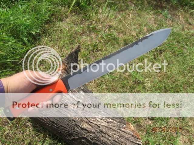

decided to make mine a takedown.......
WAAAAAAAAAH!

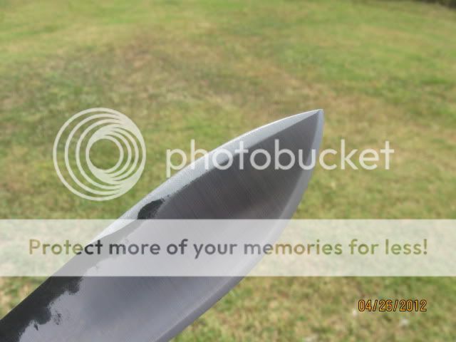

Looks like there were a bunch of cracks in the spine........still unsure what caused them. Grain size is fine...........didn't start from any obvious stress risers. The only thing I can think is I did some straightening at a low heat.........maybe too low........may have been too much for it.
Back to the forge for me I guess.

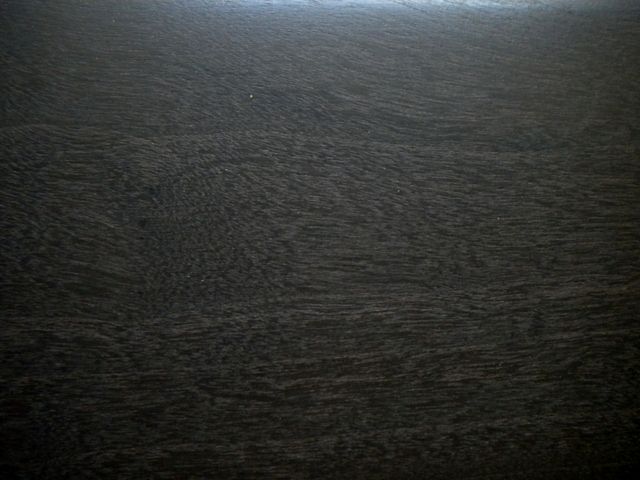

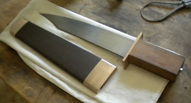

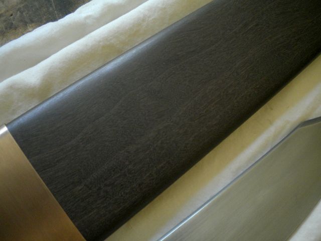

I got the main parts of the scabbard fabricated this morning,.. not the final finish. I'm still going to add some silver details etc. I left the wood un-sealed for now in case it needs touch up before final assembly. The ebonization (wood "patina") went well, (done with a solution of steel wool dissolved in vinegar, brushed on).
Pix in series here:
http://smg.photobucket.com/albums/v453/taigoo/On The Bench/On The Bench 2012/
Thanks PanchO. It's all been pretty much touch and go. I bought a box of rubber gloves this morning, so as not to mess up the ebonization while I'm working on the fittings.
... so far so good, I guess. Knock on wood. :)

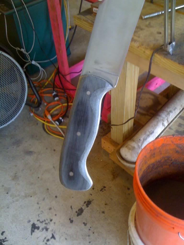

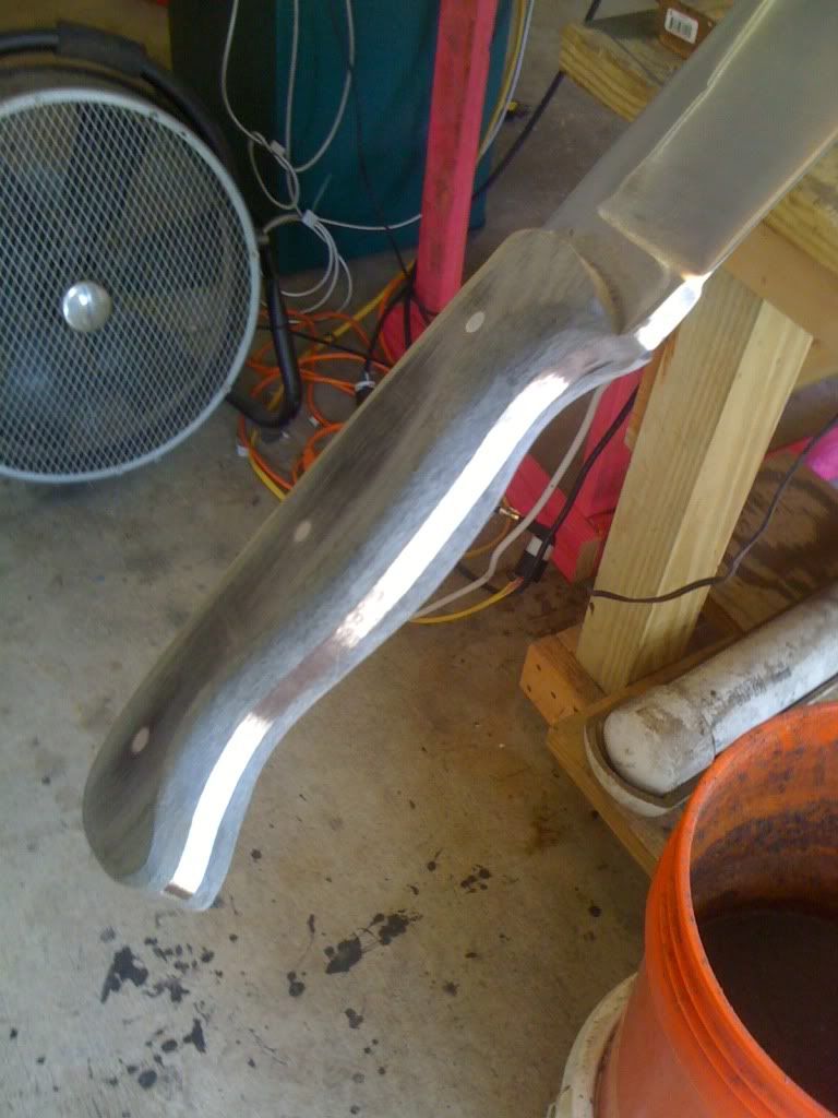

Well finally got some free time to work on it some more!
Handle shaping of black g10 (I live in louisiana so swamp country and all requires waterproof and g10 works well for this application)

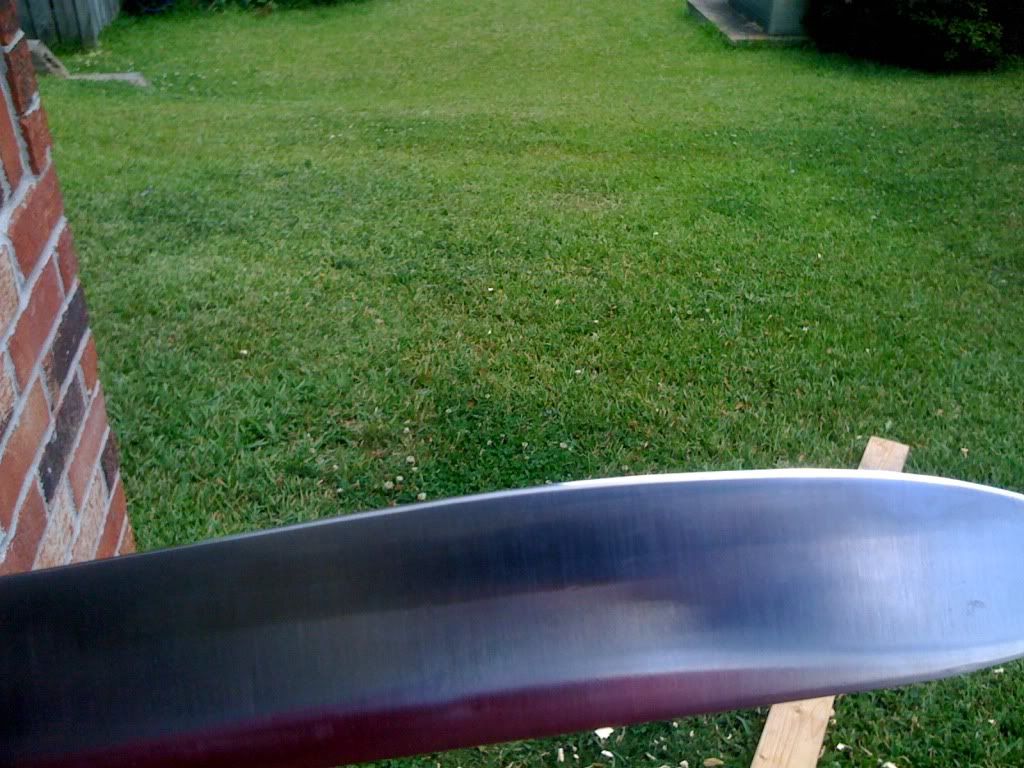

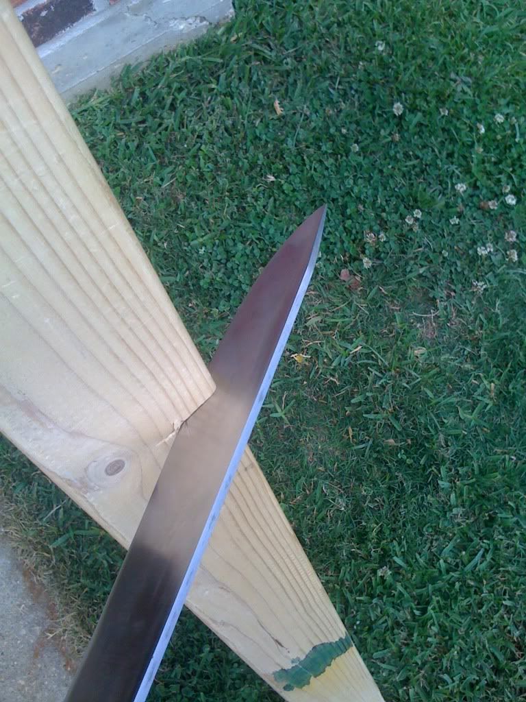

Of course I couldnt wait since this is my first heat treated knife in my new evenheat oven!
No chips, cracks, small explosions on edge!
And yes it still can shave!!

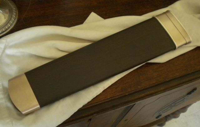

… Still working on the scabbard. Slowly but surely, I think I’m through the worst of it,… still have to get a belt loop gobbed on the back and finish fabricating the tip.
Once I saw it, I decided to change it a bit from the original sketch. I figure about 1/3 of the entire project is in the scabbard… It’ll be nice to get through this part.
Love how you have done that scabbard.......that's a thing of beauty.
