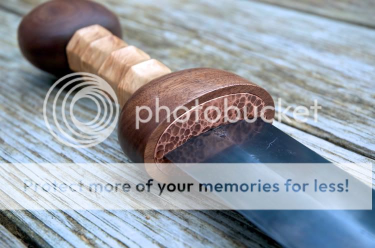

Well.. I finished the sword part of this. Not sure what I'm going to do for a scabbard yet, maybe try the slat method.

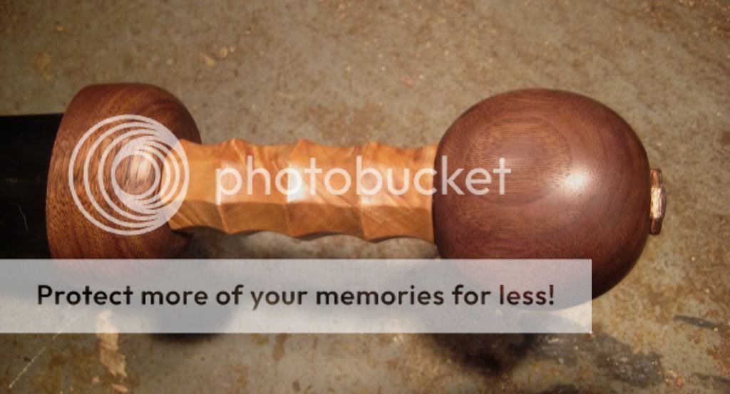

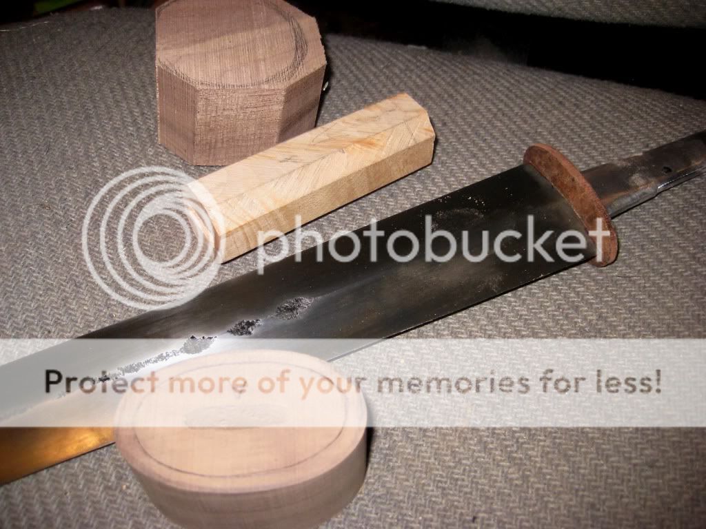

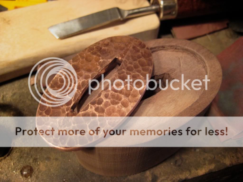

First photo is after cleaning up the blade, sanding and using some cold blue to darken the colour and keep it in line with the forge marks. Here's all the wood parts for the guard/handle/pommel. Walnut and maple. The plate is copper that has been hammer finished and heat coloured.

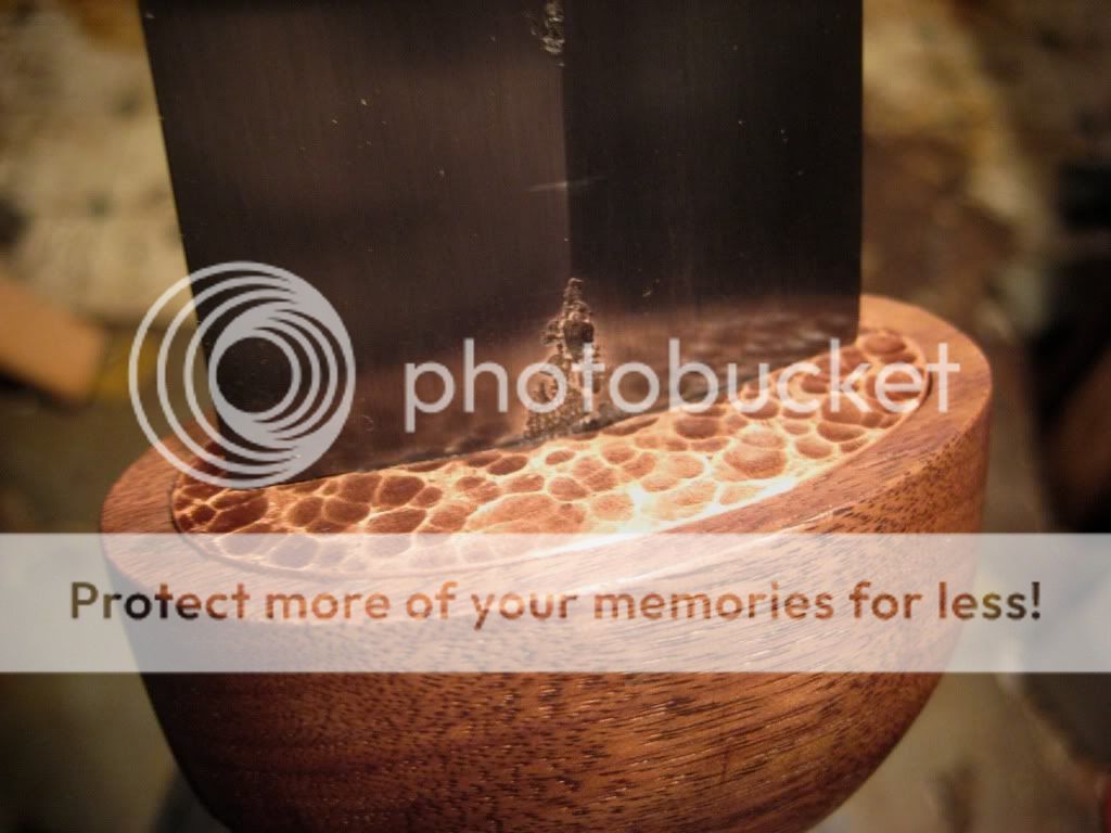

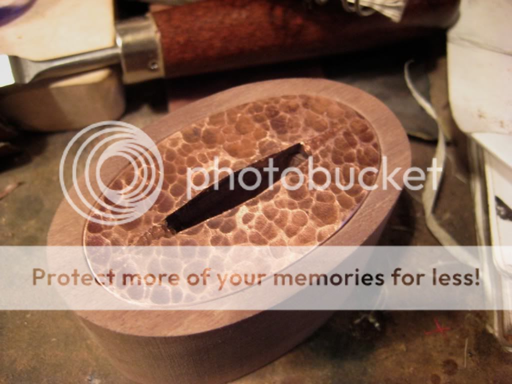

Now to inlet the copper plate. I left it slightly proud so as to leave a little of the edge exposed.

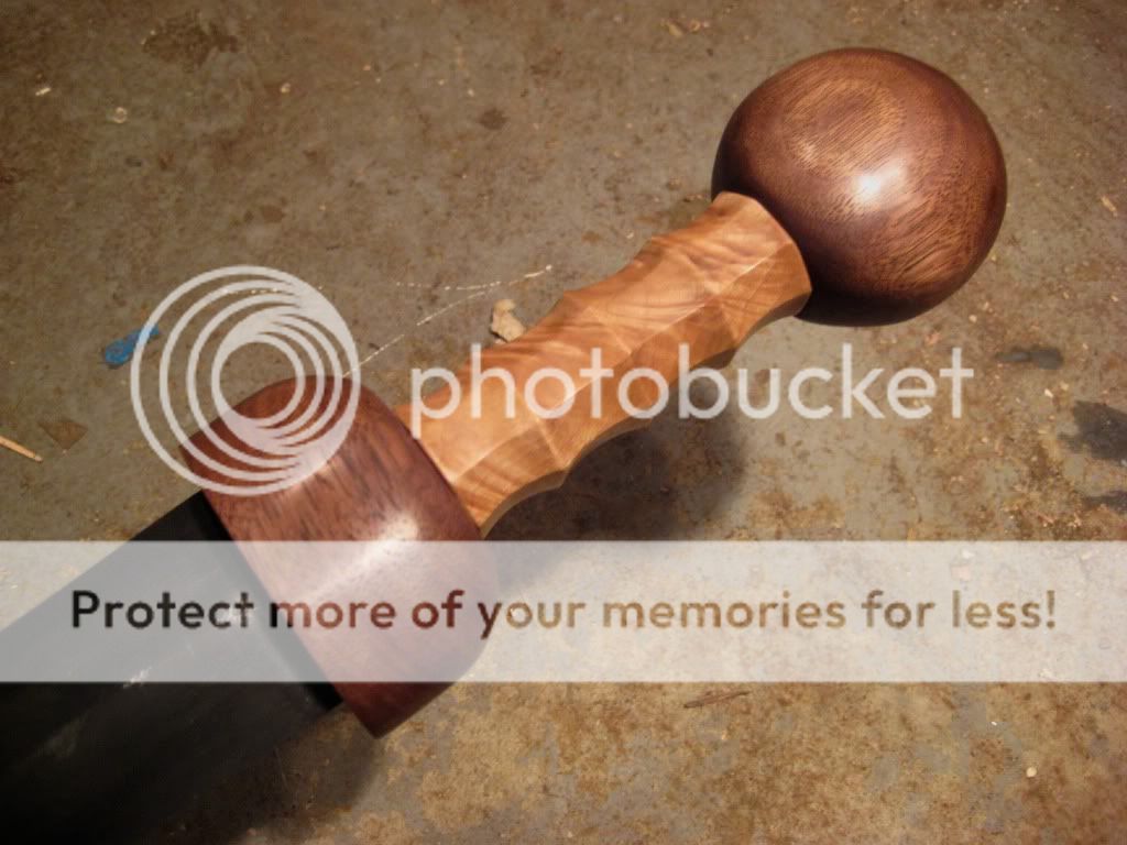

Nice fit all glued up.

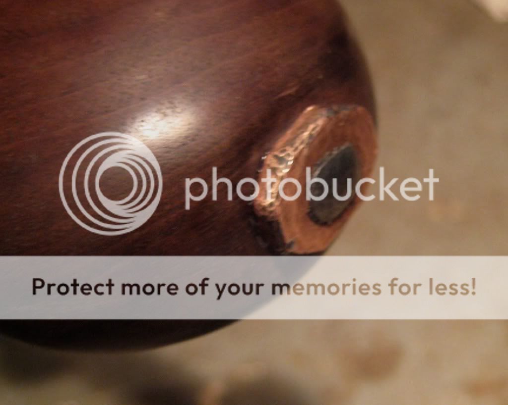

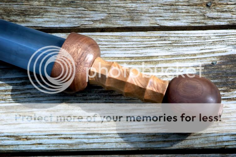

Here's some of the handle detail including the copper pein block and the tang peined.

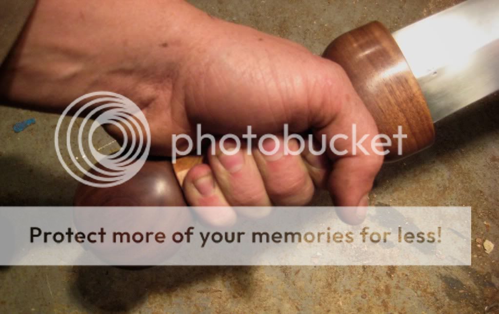

From my research, these are supposed to fit tight in the hand so that when gripping, the hand swells against the pommel and guard for a secure grip. It ended up making the maple part of the handle only 3 1/8".. (and I have large hands)
And here's a snapshot of the whole sword. The blade is 19 1/2" and is 2" wide at the guard.

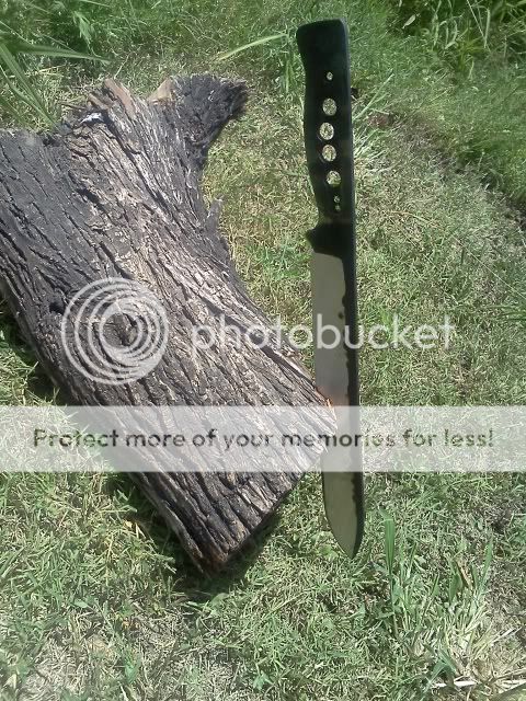

I drew back the spine, cleaned it up to 120 grit and put a quick 120 grit edge on it and whacked a stump. The edge held up well. I chopped a peice of brass tube and showed no chipping. I put a small convexed edge after I ground it down to .20. Its go some meat behing the edge. I didnt want to make it to thin.
