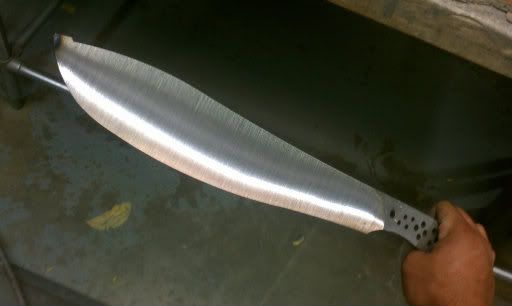

Well since I just finished a chopper with a 17" blade I decided to make something a little smaller for the Camp Sword Challenge. I'm making a ~13" blade with some bowie influence.......

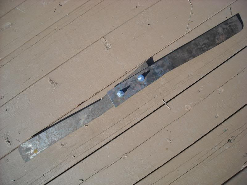

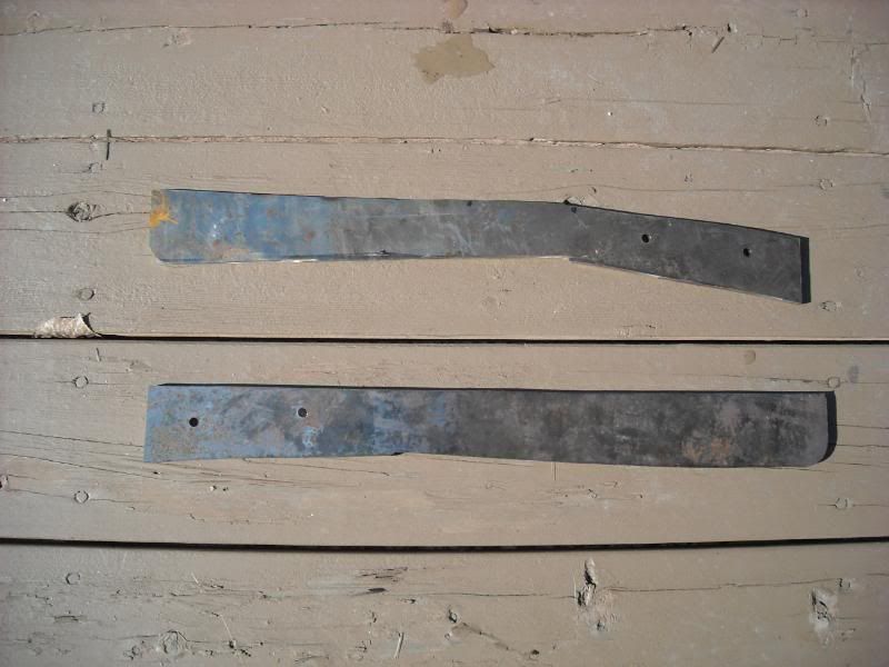

Here are some pieces cut out from a 6' sawblade (thickness is just over 1/4"):
Then I drill 1/4" holes and bolt them together so I wont have to use tongs:

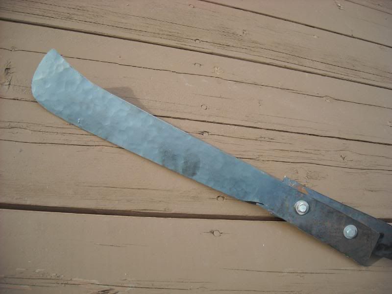

Forged this one out last night - it is going to a fellow BF'er:
And this one tonight for the camp sword challenenge:
I wanted the clip to be a little more pronounced so I'll have to cheat and fix it up a little with the grinder:p

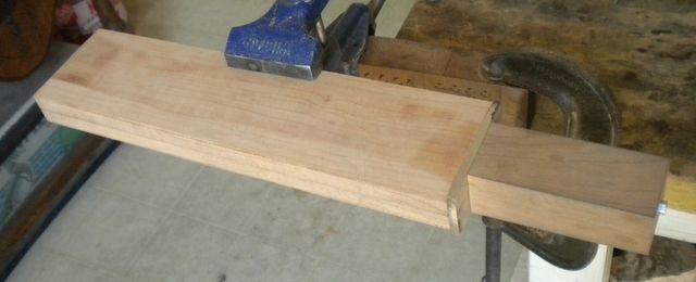

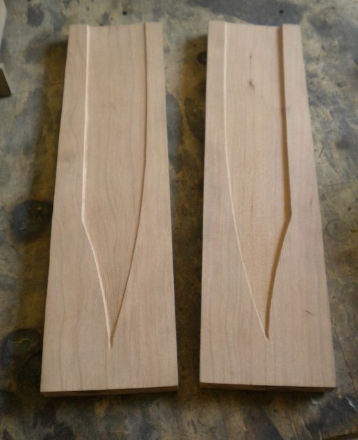

I got the scabbard blanked out this morning with a nice fit. I’m getting kind of anxious to see how it looks all dressed up and ebonized,... still need to thin it out some more and get the exterior form set first though. So far, everything is lining up nice, straight and snug.

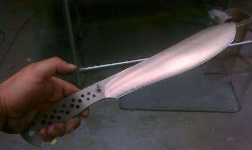

One bevel done, the other half finished, before I got fatigued, and hungry.
I think I ground away enough metal to make a regular size knife from just the one side.
I had to adjust the angles from ricasso to tip in order to get the look I was after, and the distal taper.
I will also have to make some "design modifications" as I went over my grind line.

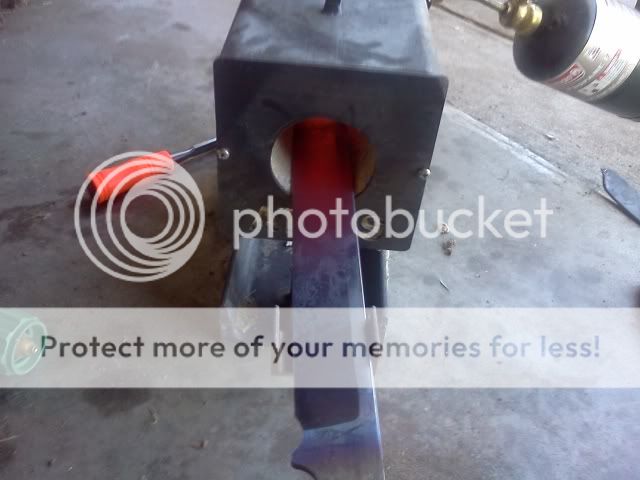

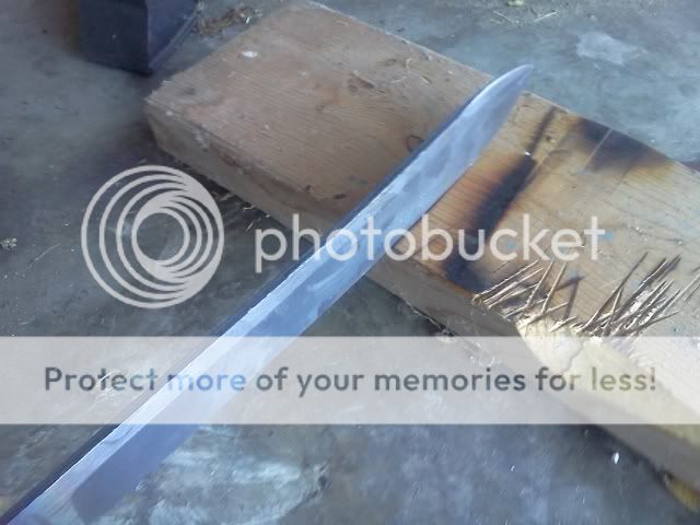

I drilled the handle holes this morning and decided to try and put a slight curve into the blade. I fired up the little forge and tried it out. I got a nice slight curve, but the blade was a little crooked. I used wood for a while the the hammer to straighten it out. After an hour and putting a bunch of dings in the flats, I got it straight. I think this one will have a forged finish instead of the satin I was planning on. A small design modification is all.

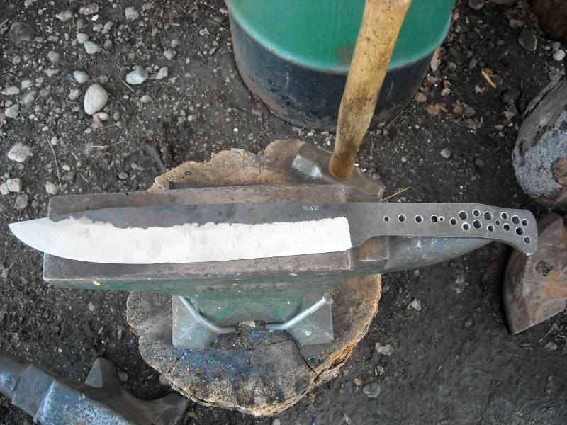

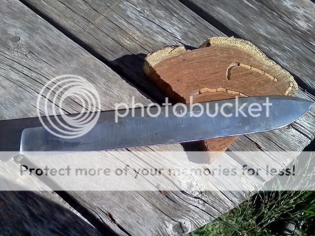

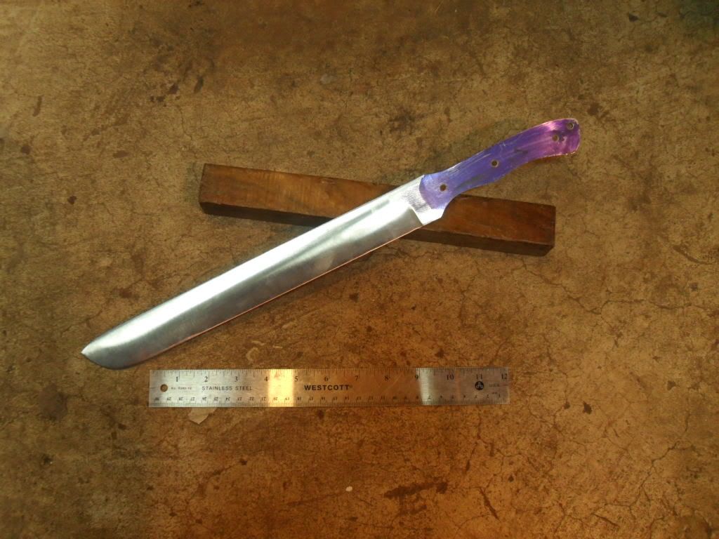

I got my blade ground, handle shaped, holes drilled,.....all ready to heat treat:
Bruce, the camp sword is 5/32" 52100 - 17.5 OAL
I started to panic when I couldn't get it straight. It was a stock removal blade with forging marks put there trying to get the blade straight again. I have some wolf jaw tongs and its hard to control the thick heavy blade. I have some bladesmith tongs in rout from Black Smith Depot so hopefully they will help control the blade.
Nothing like 1700 F red hot steel flying off the anvil when the tongs slip......
