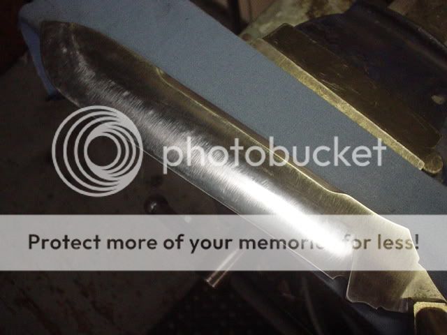

Well, I got to just about finishing one side to 220 grit. She's looking a little shiny now, which is really nice:)

The bevels are looking swell, and I have a feeling this knife is going to be brutally sharp and with a long lasting edge. You can sort of see the convex on one of the photos where the picture was taken from an angle.

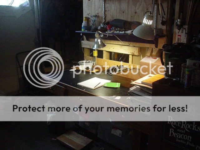

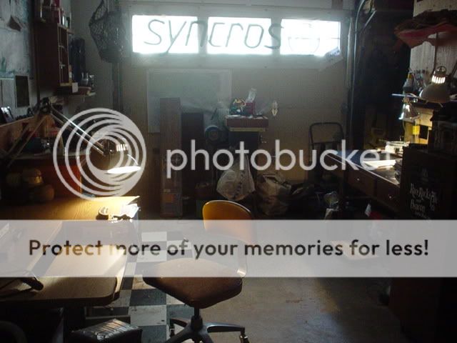

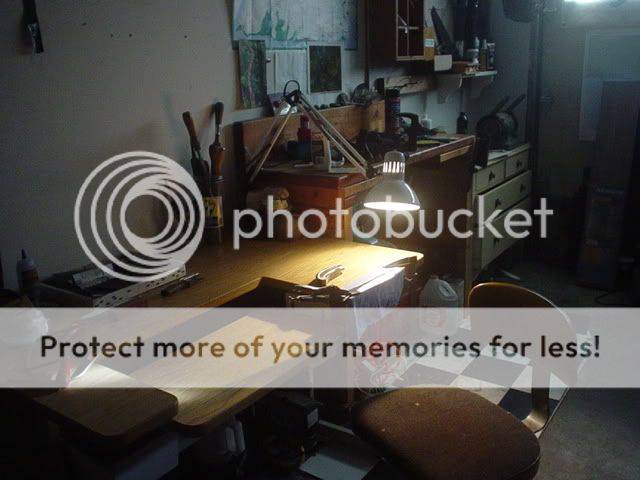

Home sweet home!
still a bit messy, and I don't have much in the way of tools yet, but next spring I will be hitting the garage sale scene hard! I can't abide crappy tools, so it's going to take awhile to get what I want. But I have my space, and that's the most important.
I just love working away in the garage with the radio on. There I can forget about the stresses of everyday life and drift into making an interesting object.:thumbup:
Looks like a great place to work my friend!
I look forward to seeing the workshop and the knife progress!!
Hmm, a syncros curtain, I am envious... :)
/Magnus

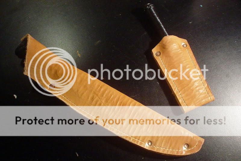

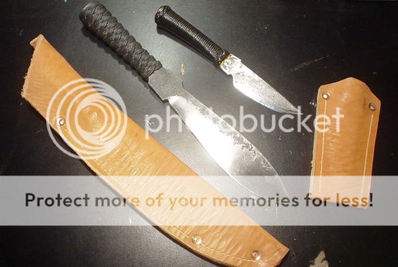

I've been a little distracted from this project, especially since I got a couple of new knives which required some sheaths, so they're almost done and I'm hoping to get back to sanding this afternoon:thumbup:
Mike, they are indeed! I now have three Goos and the man makes a very good knife, or at least three:D:p.
He'd be a cool guy to have come down to your school...:cool:
ps. thanks for the props on the sheaths:). I've been wanting to get these knives out and used in the world, but without sheaths they just kind of hang out around the house.
And thanks again, Ryan, if you're out there! I appreciate you keeping me in mind when these came up for sale:thumbup: I love them.

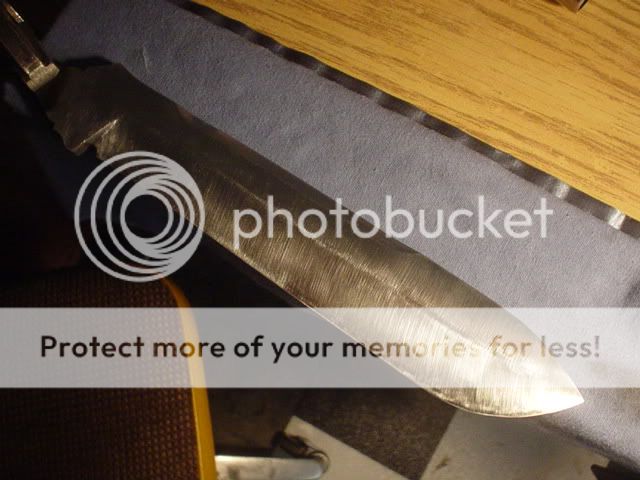

This shot is at the 220 stage. First I sand at perpendicular to the centerline of the blade, then when all the longitudinal scratches from the previous grit are gone, I clean it up with longitudinal sanding strokes.
And then on to the next grit, and the next, and the next...
so here I am at 320 grit with my first pass. You can see the longitudinal
scratches I'm trying to remove from the previous grit. Once they're gone,
I'll remove the perpendicular sanding scratches but pushing my sanding bar
from ricasso to tip.
