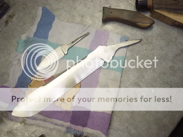

If you decide to put fullers in it, you can rough it in with a dremel tool, but to get them really consistent and smooth... You'll need to make a tool to clean them up. It's a lot like the sen that Will mentioned. You'll want a HSS square ground tool bit that's the same width as the fuller you want.
You can get HSS square tool bits from just about any tooling supplier (MSC, Enco, Travers, etc.)
You'll have to grind the end of it on a bench grinder to the radius you want your fuller to be.
Rig it up like an edge scribe so that you can drag it along the spine, or a fixtured plate, or some such thing, and get a repeatable motion.
The HSS will cut into soft 1084 like butter. :)

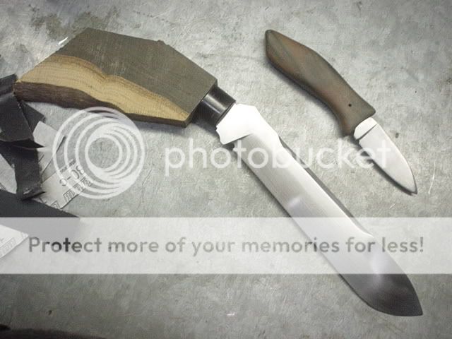

I've got just a bit more finishing work to do, and then I'll send her off to you for some hot hot love.

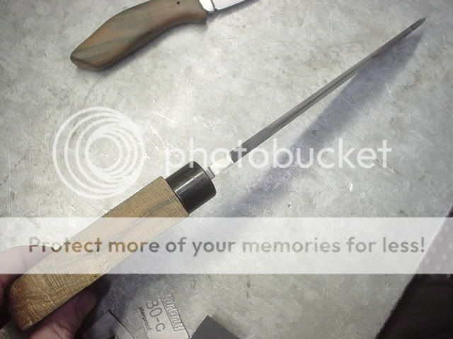

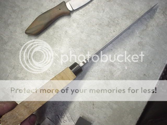

I really wanted to make sure I could do the handle the way I envisioned it, without screwing it up, before I sent the blade off and waste your time. It looks like it's all going to work out, (knocking on wood) and I got the tang to fit neatly into my block of wood. It's a very tight fit which is what I was going for. As for fastening, one or two stainless pins, epoxy and some kind of wrap over the wood.
I hope this thing works.

I think I'll be ready to send the blade away for heat treating early next week. While I'm waiting I'll fit the handle pieces together a little better and work on that ferrule. The little knifelike object is the first one I put my hand to, and learned most of the bigger mistakes on. It was a Nicholson file in its former life.
Well, Lorien, the little knife-like object isn't bad, but that big camp/trail is really a good-looking design, and you've done an equally good-looking job on it. It's obvious you don't mind hard work, and obvious you've got an eye for shaping a knife. Now the bad news...This stuff's addictive.
