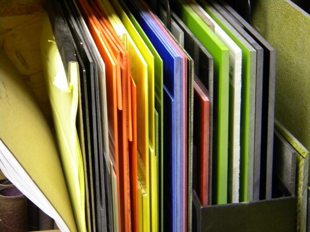

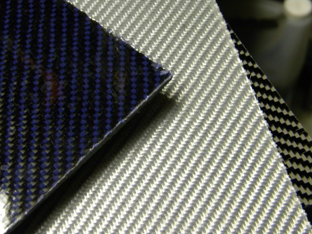

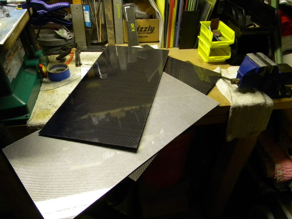

Got home from work today to find a package I've been anxiously awaiting! About six square feet of handle material! Don't ask me how much it cost....I blew my grinder belt budget on this stuff! I was thrilled to find some silver twill G-10 for a pretty decent price all things considered, a big sheet of 2x2 twill Carbon to add to the stockpile, and some black and blue carbon fiber/kevlar.
Since the blade is waiting to be sent out to heat treat, and the new material came in I decided to get some scales glued up and ready for when the knife gets back.

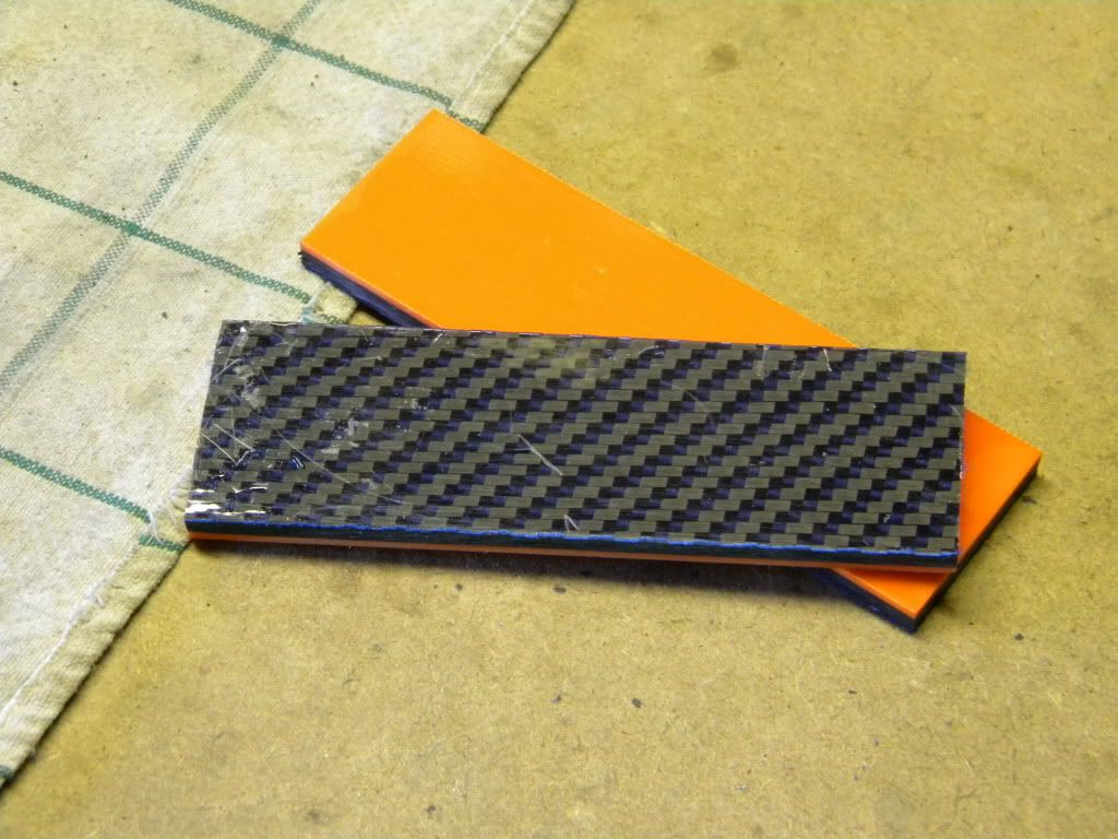

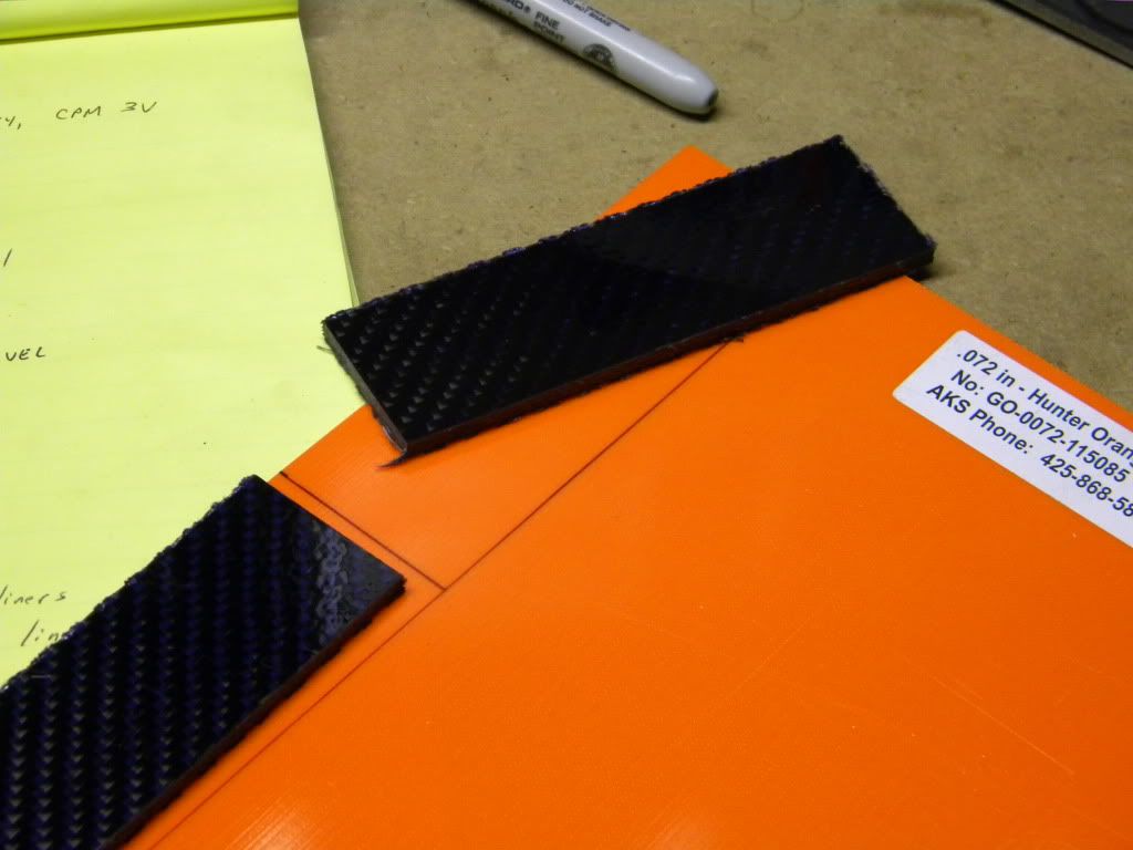

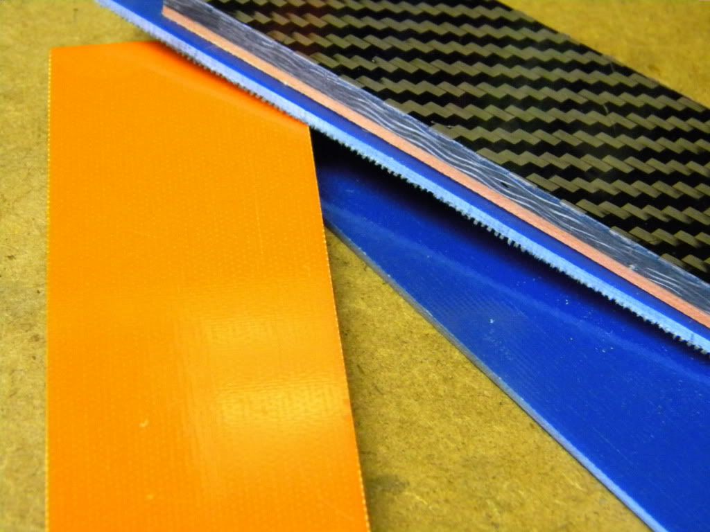

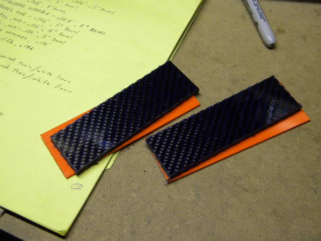

Decided to go with the black and blue carbon and kevlar for the West Coast Hunter. Went to the liner pile and I think some .065" thick orange will pop nicely with the black/blue slabs.

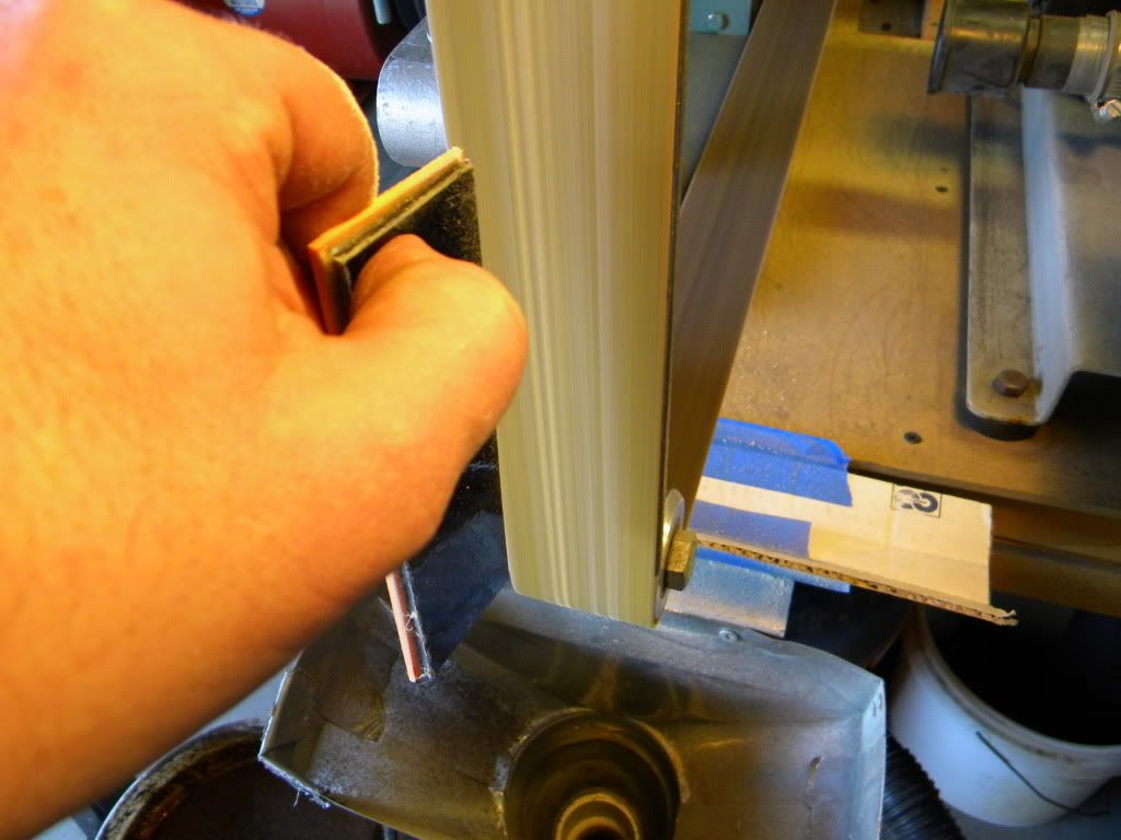

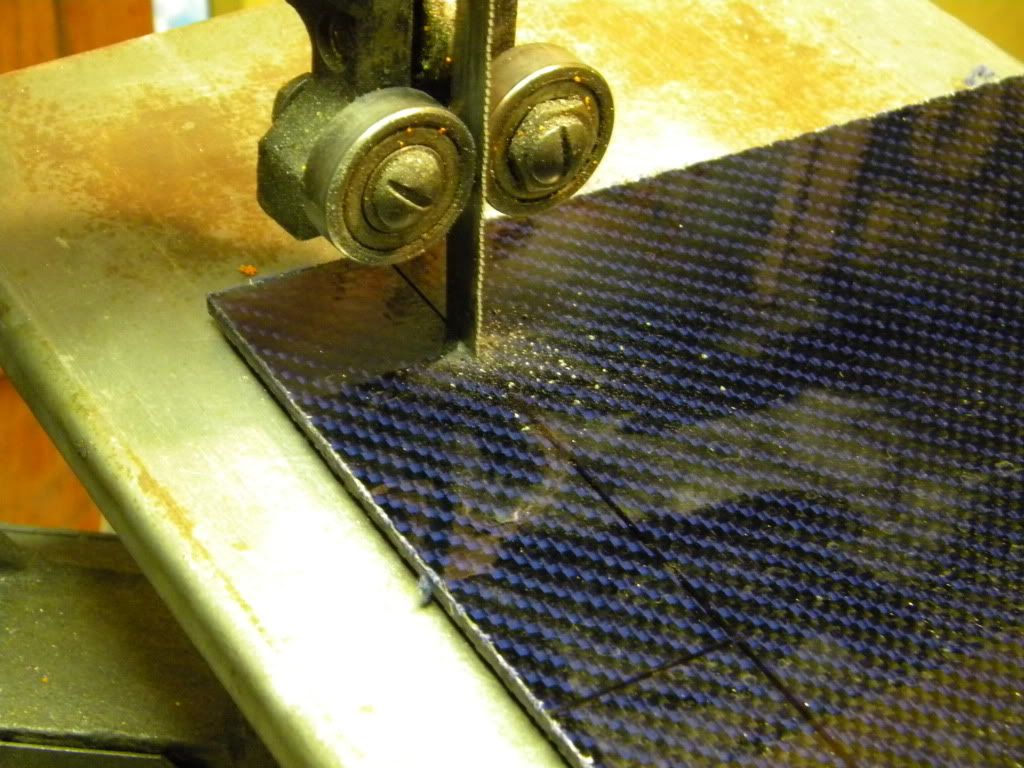

Laying out some slabs and liners and working on the band to get my pieces cut.

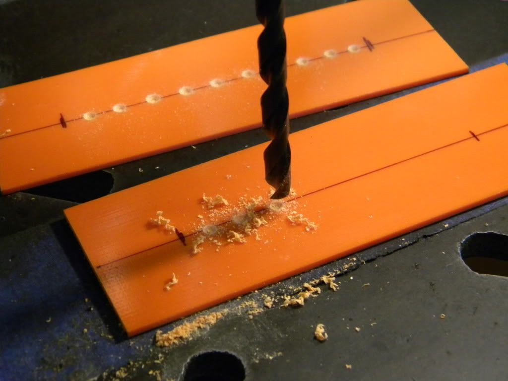

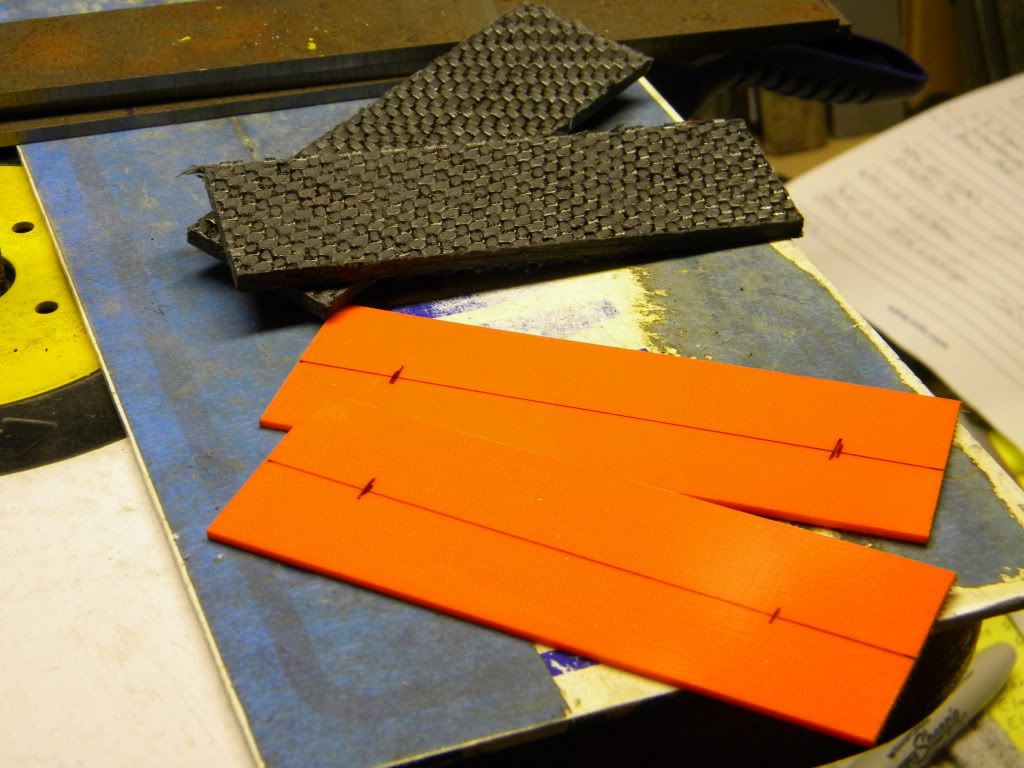

Next I mark the center lines of the slabs and liners and come in about 3/4" from the ends with a sharpie. More on this in a moment.....
Now I go to the drill press and drill some divots out of both the slab and liner pieces in order to create pools for the expoxy to collect in, giving me a stronger and thicker bond. I keep the divots very close to the center lines that I drew on the handle material. I've learned from past mistakes that if you drill these divots too far out from the center of the scale or liner, they will appear during handle shaping..........not good!
**EDIT** I should not here that I drill divots in both the liner AND the slab. The more volume the better for the bond. I realized when I saw the pics posted that the carbon fiber slabs are too dark in the pics and you can't really see then divots so I wanted to mention it.

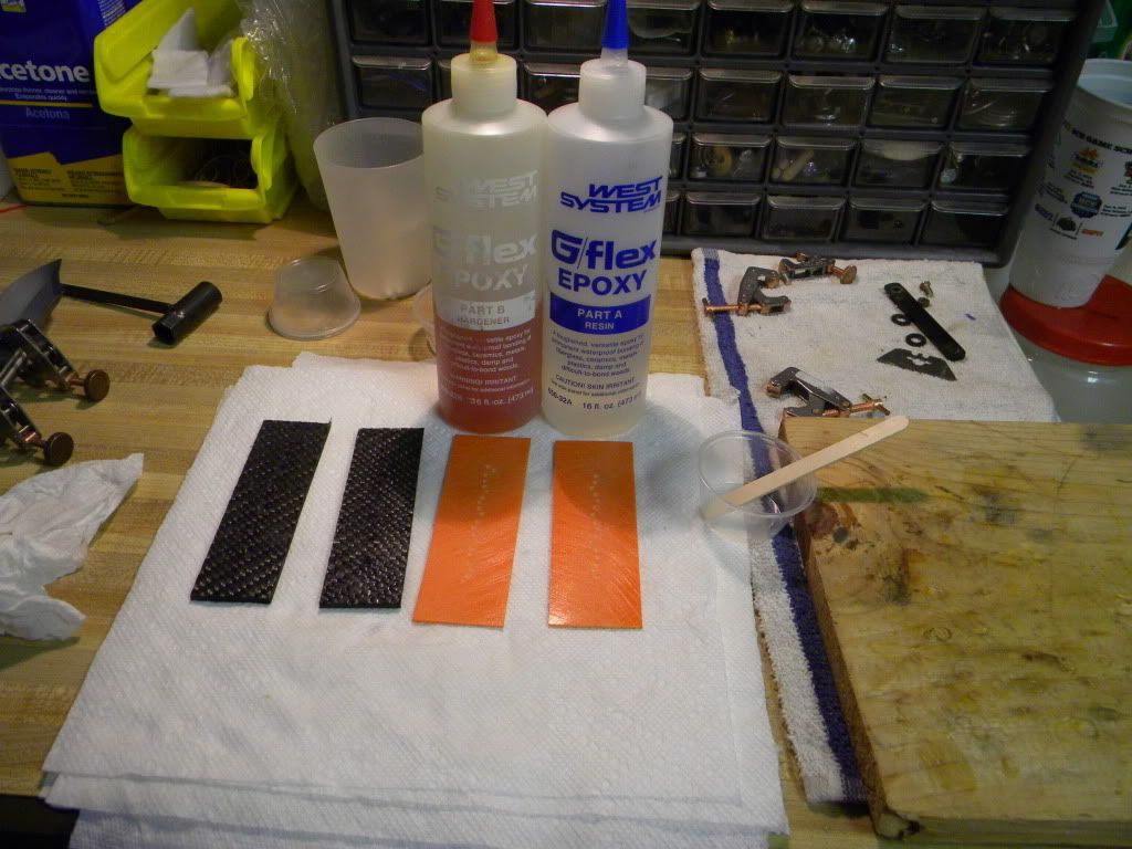

After the divots are drilled, I go to the bench and using some nice chunky 50 grit paper and a sanding block, I rough up the surfaces to be glued really good using windex to keep the harmful dust from flying. I should note though that I also wear a respirator during the whole pocess as well.
After the material is good and roughed up, I go to the sink and thoroughly wash all of the pieces in warm water with Dawn detergent, giving them a good scrubbing. Then they are laid out on a clean paper towel and allowed to dry. Next comes a good wipe down with first acetone, and then rubbing alcohol to to make sure they are totally clean and ready for bonding. I take care at this point to not touch them anymore without gloved hands.
All scuffed up and clean and ready for a batch of West Systems G-Flex slow cure epoxy. I love the G-Flex. From what I understand it was originally designed for marine applications and when cured has the slightest amount of flex to it which can help absorb shock and keeps the bond strong. I've done some pretty tough destruction testing with it using both G-10 and micarta laminations. I eventually good separate the bond but only after serious abuse with a hammer and large chunks of concrete. It's tough stuff for sure! Plus, Alpha sells it and they get tons of my business!

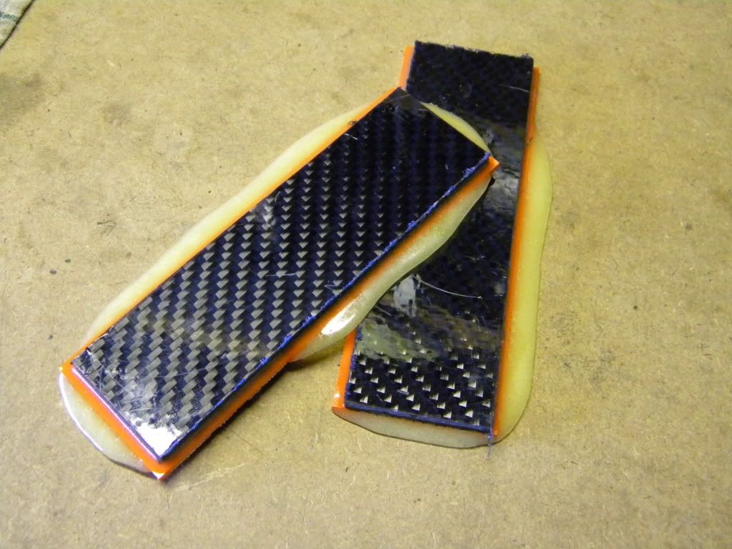

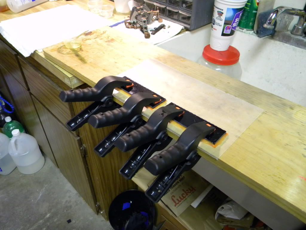

After mixing up a small batch of epoxy, I apply it liberally, but evenly to both pieces being bonded, making sure there is enough to squeeze out of all four sides of the handle slabs so that I know there is contact along the whole surface of the slabs/liners. I use standard wax paper from the kitchen aisle on my bench when I clamp up my slabs. Once the epoxy is cured, it comes right off and there is no mess to clean up. Works great! Speaking of clamping, for handle laminates I like to use these super cheap black spring clamps form Grizzly Industrial. They break in easily, and once they've softened up just a touch they are the perfect amount of pressure to hold the slabs and liners together nice an secure without squeezing so hard that they press all of the epoxy out from between your materials. Less than a dollar each I think if you buy a ten pack.
Finally, a shot of the materials all glued up. They sit here for the next 24-36 hours until they cure and then I'll grind off the excess epoxy and move on to the next step.

I buy the vast majority from Alpha Knife Supply, but I pick some up from Tracy at USA Knife Maker sometimes. I have bought some of my more exotic stuff from Matt Diskin of Volcan Knives and Sweet (He's here on the forums). This big batch of carbon/twill/kevlar is about six square feet and I picked it up from Composite Envisions. I've been eyeballing their site for a while and decided to bite the bullet and give 'em a shot. The only problem is that you will drool tons and not be able to get most of what they have. They are mostly geared towards the custom automotive industry and the vast majority of their CF and such is way too thin for us to use in knife making. There are some wildly insane patterns and colors that they make, but it's all about 1/16" thick or less. Still, it was nice to find a sheet of silver twill G-10 that's 12" x 24" and .130 thick for around $90.00! I've seen sheets of the stuff less than half this size for that price or more.

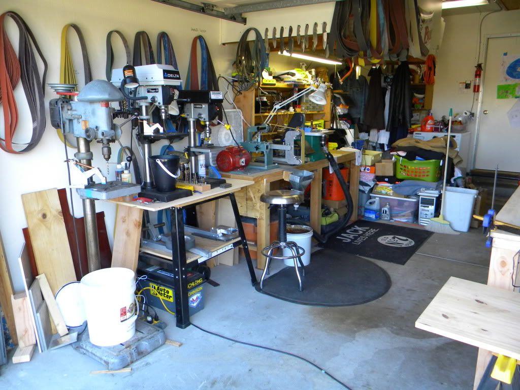

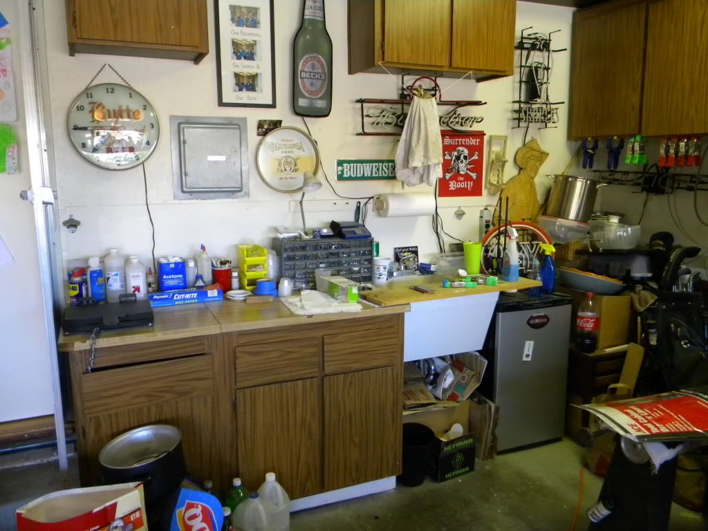

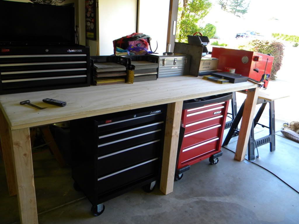

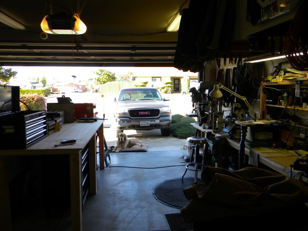

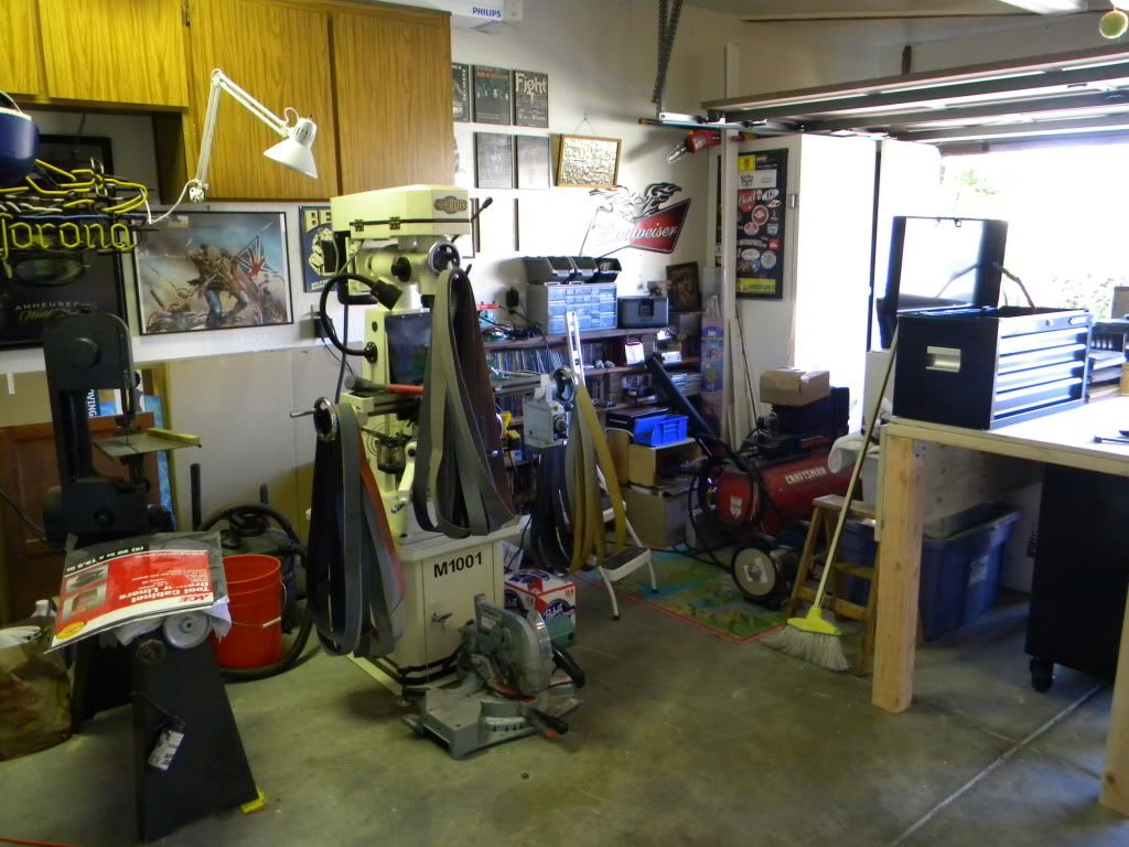

Also, today.....after being inspired by Andy Roy's work on his brand new shop, I decided to get rid of the rickety sawhorse setup I had going on across from my work bench and build another proper bench for the shop. Less than fifty bucks and a couple hours later I'm pretty happy with the result. Lots more working room and storage! Things are a bit haphazard from all of the shuffling around but here's how the shop is set up now.
New bench:
Directly across, the original bench:
Looking out, plenty of room in between for moving around:
Etching and handle/slab glue up table, much more room now without tool boxes and granite surface plate:
Mill, compressor, band saw behind new bench:

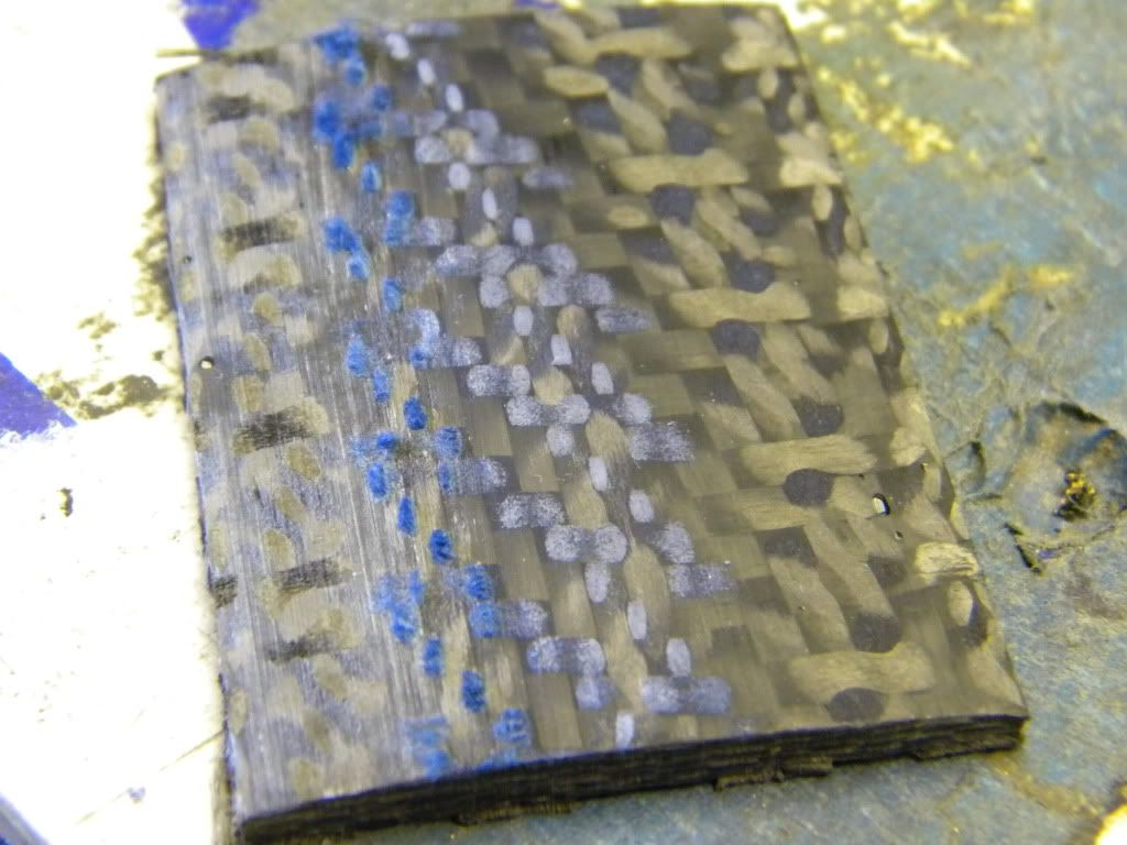

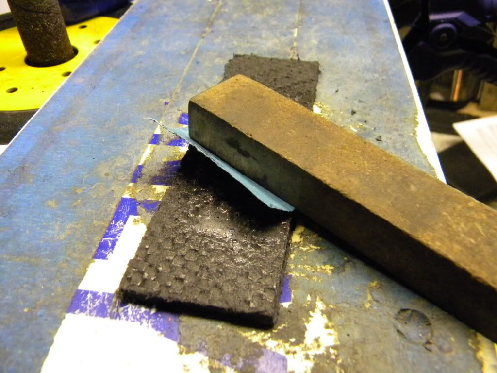

J, ill be honest...the carbon is fine but I'm nervous about the blue kevlar. Rough grinding left quite a bit of fabric exposed, more so than micarta. We'll see how it finishes. With these concerns I plan to finish a test piece this week. Ill update this thread with results.
Dude, I'm so jealous of your work space. Please let us know how that carbon/kevlar sands. I bought some small sheets of it from the same place a few years ago but haven't event touched it and they were really hesitent to make some up for scales... but man that stuff is PRICE-Y
Okay, J.....
Looks like I've got some bad news for you. I wouldn't count on using that carbon/kevlar for handles :( Here is a pic of the test piece I did today. The left hand side of the piece is after rough grinding with a 60 grit belt. The right side was finished to 800 grit, wet hand sanded with SC paper. The kevlar fabric doesn't seem to get impregnated with the resin much, if at all. You can see how loos the fabric fibers are on the left side after grinding. Even after finishing to 800 grit, if you run your finger over it it feels like fabric, not like a durable handle material. As you can see it also finishes very hazy. The blue doesn't stand out like some other blue or red carbon fiber mixes I've seen. To make it worse.....I got a 12 x 24 sheet of the stuff and it's not cheap!
The good part is that the blue kevlar material is only in the first layer or two of the slab, and the carbon fiber beneath it finishes just fine. The sheet was originally .170" thick, so.......I figure I'll add a little bit more thickness with another liner and then grind away all of the kevlar when finishing and I'll be good to go. To keep with the blue and orange theme, I glued up some .062" blue G-10 to my handles tonight. In the future I'll use some of my thicker 1/8" range liner material with this stuff and treat it like a thinner sheet of regular carbon fiber, just grind away the kevlar. It was kind of an expensive lesson that is a bit of a pain in the ass but not the end of the world. At least now I know about this stuff.
On a side note, for anyone looking at Composite Envisions online for handle material......the 2x2 twill carbon fiber and silver twill G-10 sheets that I got seem to be fine and were a pretty decent price considering that they are two square feet each. I should not that while the carbon fiber was very flat and smooth on the backside, the silver twill has quite a few resin ripples in it, making it bumpy here and there. Shouldn't be too much trouble to mill it smooth though so I think I'll keep it and give it a shot.
