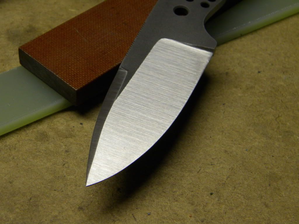

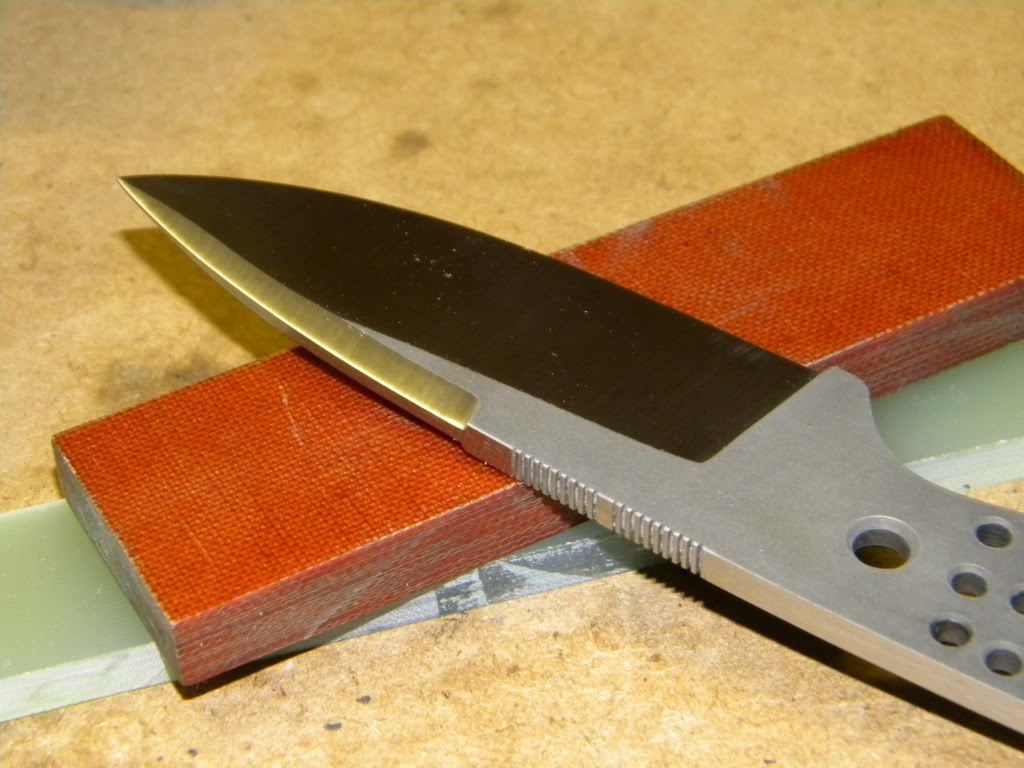

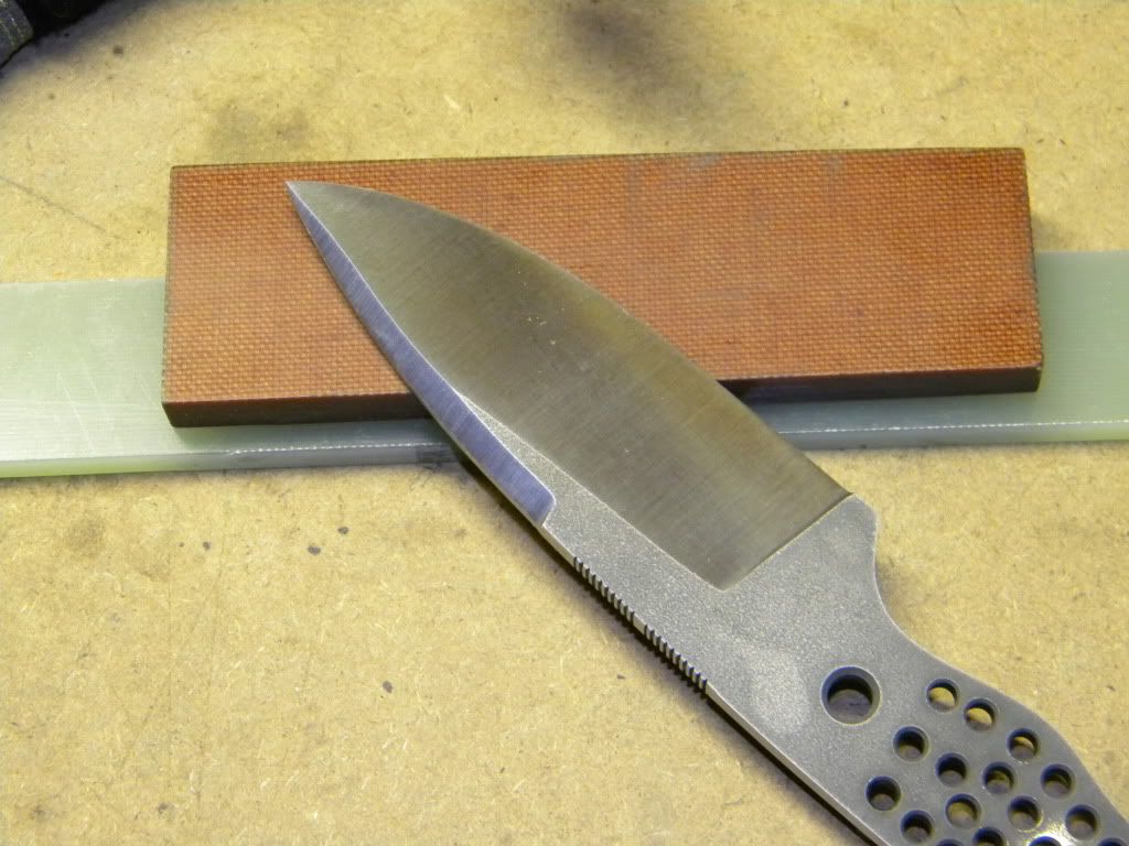

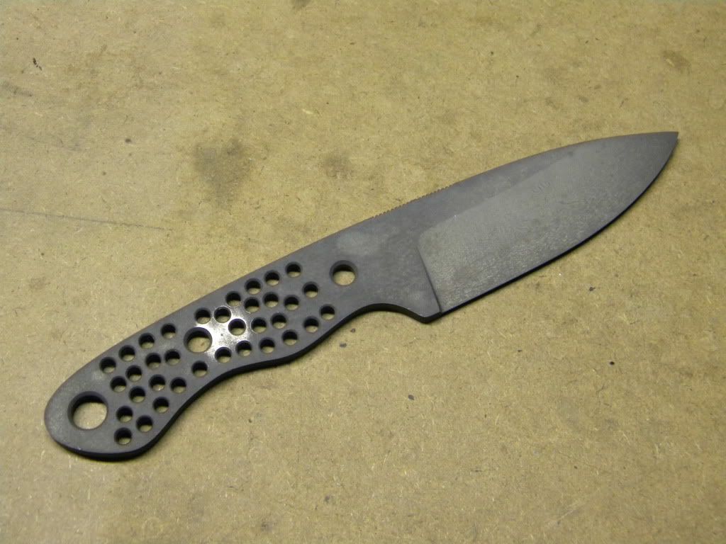

Once I got the knife, the first thing I did was soak it overnight in some distilled white vinegar. It gives the blade a nice etch and that way when I grind in the swedge and clean up the bevels I can see where material needs to be removed easier. It's like a cheap form of Dykem.
Here is the blade out of the vinegar etch, ready for some work. The bright spot on the tang is where Peters tested the hardness of the blade after heat treat. 60-61RC.

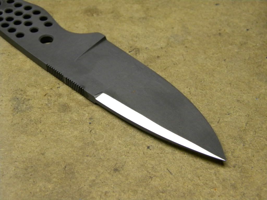

Ground the swedge

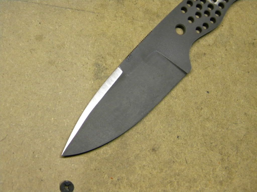

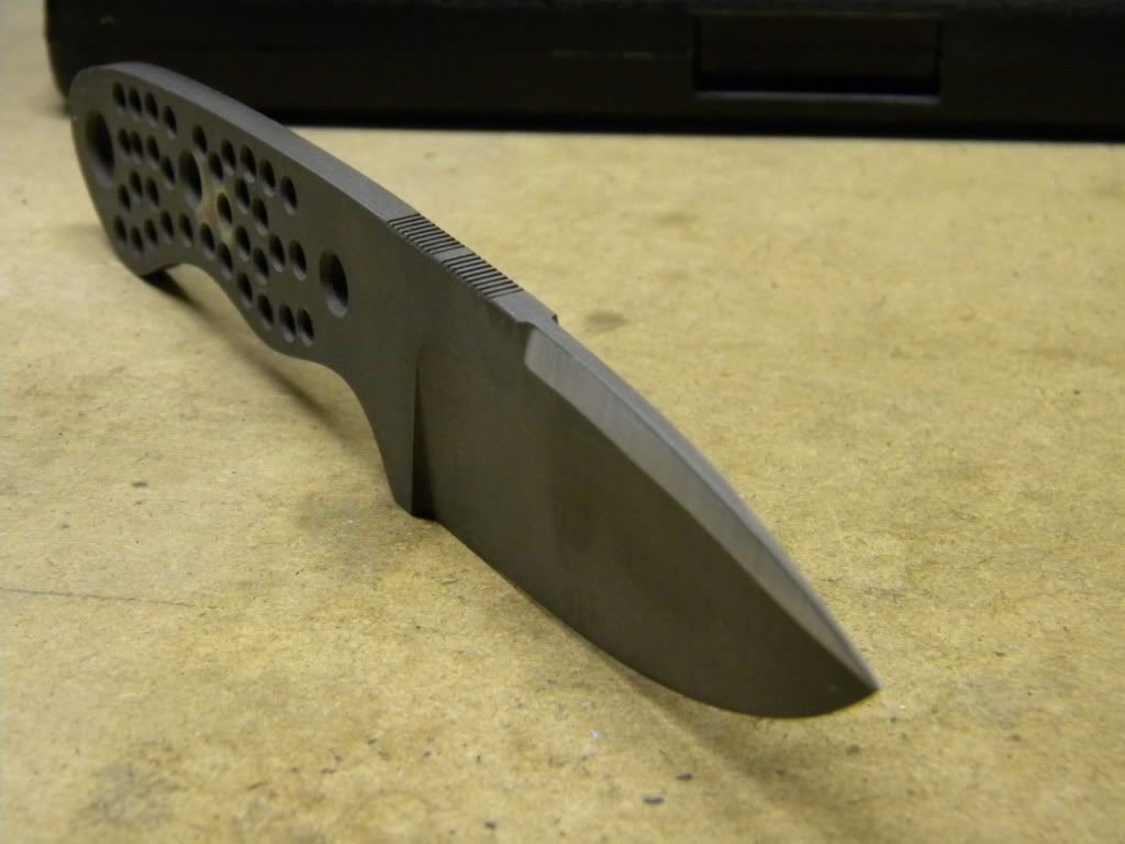

Cleaned up the bevels, getting close to being ready for handles and a maker's mark.

Awesome as always buddy. Top notch grinds! Maybe I missed it, but what finish are you planning on the flats? Gonna keep the vinegar etch? If so, how well can you etch your MM over top of that?

Wolffie, I've etched my mark over etched steel before without issue. For this one though the mark might go in the upper right corner of the bevel. Not sure yet.

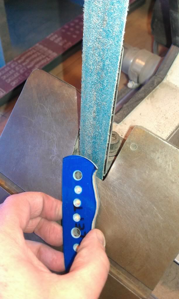

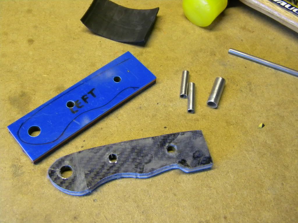

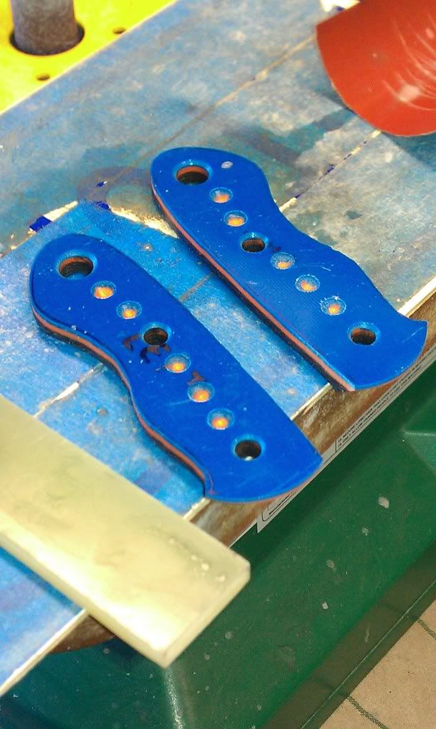

First order of business was to get handles drilled for tubes and profiled.

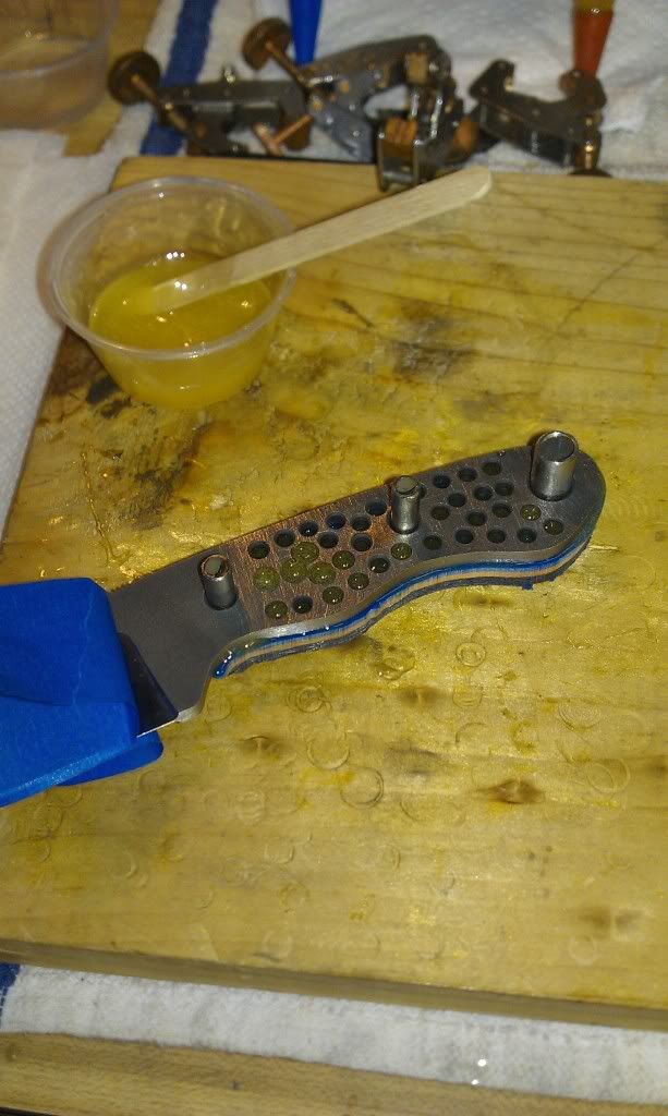

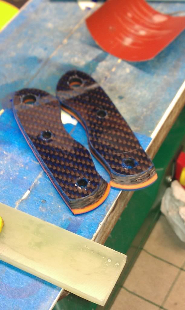

Next I drill some good sized divots on the back side of the scales for epoxy to collect in when attaching the handle to the tang. Coupled with the holes in the tang it allows a lot of epoxy into the area to create a good thick, strong bond. I figure the more contact the materials have with the epoxy the better. I'm careful to keep the divots away from the edges of the handle though to avoid exposing these epoxy pockets during handle shaping.
Once I have the profiles roughed out and the back side drilled, I shape the fronts of the scales and get them finished up since I can't do it once the handles are epoxied to the tang.

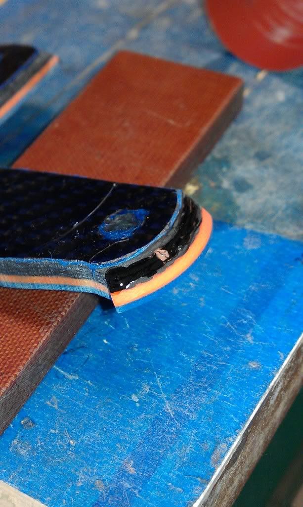

I finished the fronts to 600 grit but I had some voids in the carbon fiber, so I had to do a little filling. I use a good, thin super glue to fill the tiny holes then go back a couple of grits and bring it back to 600.

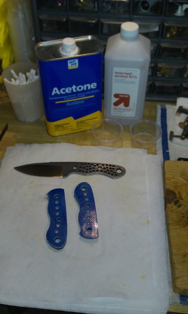

Setting up for handle glue up. First I rough up both the tang and the back sides of the handles really good with 50 grit SC paper, then clean them all thoroughly with first acetone and then rubbing alcohol. I do the same to the pins. Make sure everything is completely dry before continuing.

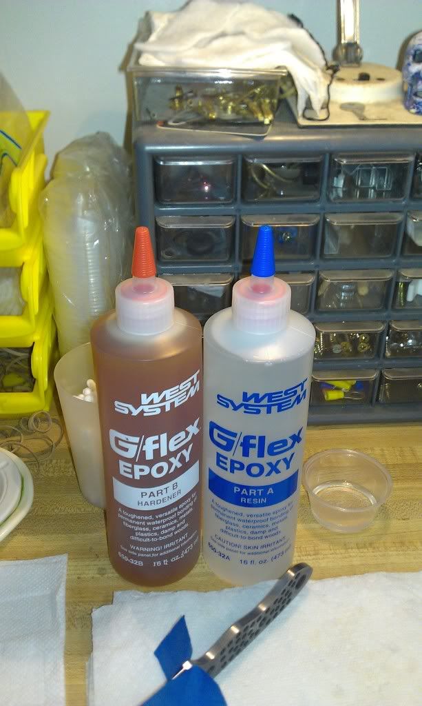

I prefer to use West Systems G-flex slow cure epoxy for my knives. I've tested it pretty hard and it holds up extremely well.
After mixing up the epoxy, I first apply a little bit to the ends of my tubes and insert them in one side of the handle. Next I coat the handle slab really well making sure all of my divots are full. I wear latex gloves for this not just to keep epoxy off my hands but also to keep oils from my hands from getting on any parts. I want everything to be very clean for the best possible bond. Next I coat the tang with epoxy and slide it over the pins, then coat the top side of the tang, again making sure I fill up all of the holes with adhesive.

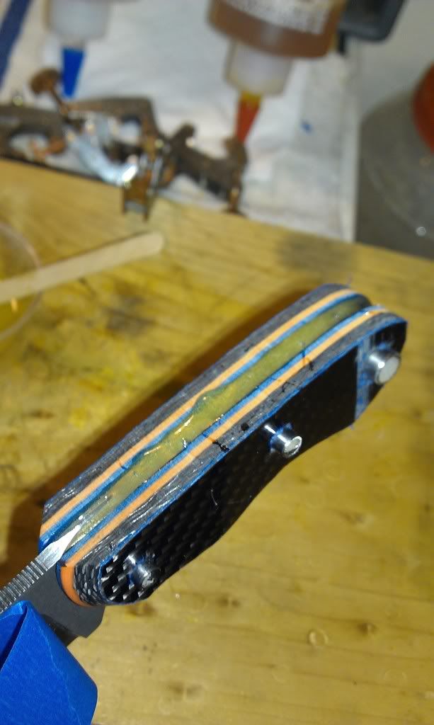

Once the knife is all together, it's time to slowly compress the slabs to the tang for a good fit with minimal or no gap. This is when the fun begins and I go through about 87 Q-Tips wiping away all the excess epoxy that slowly oozes out the sides as I compress the slabs. This is also the most tedious part because my fingers get extremely numb and cramped after pinching the blade to hold the knife while I do the epoxy wiping process. It's a pain in the butt, but better than setting the knife down and having to deal with pubbles of epoxy all over the work bench.
When I'm all done clamping and wiping away epoxy it looks like this. These 1.5" Kant Twist clamps are my favorites! You have tons of control over how hard you clamp them down and they are small but get the job done really well. No shop should be without a dozen or so at least. Also, if I'm not mistaken they're still made in the USA.
Now the knife will sit like this for at least twenty four hours and we'll move on from there.

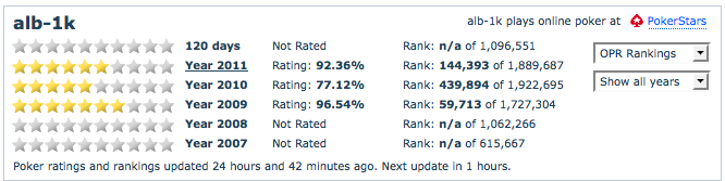

As you can see, Jon,
I was rated 96th percentile in 2009 among 1.7M players, 2010 sucked, but in 2011, I was on the rise until the government seized Pokerstars. I only played low stakes, but was about to chip up......
