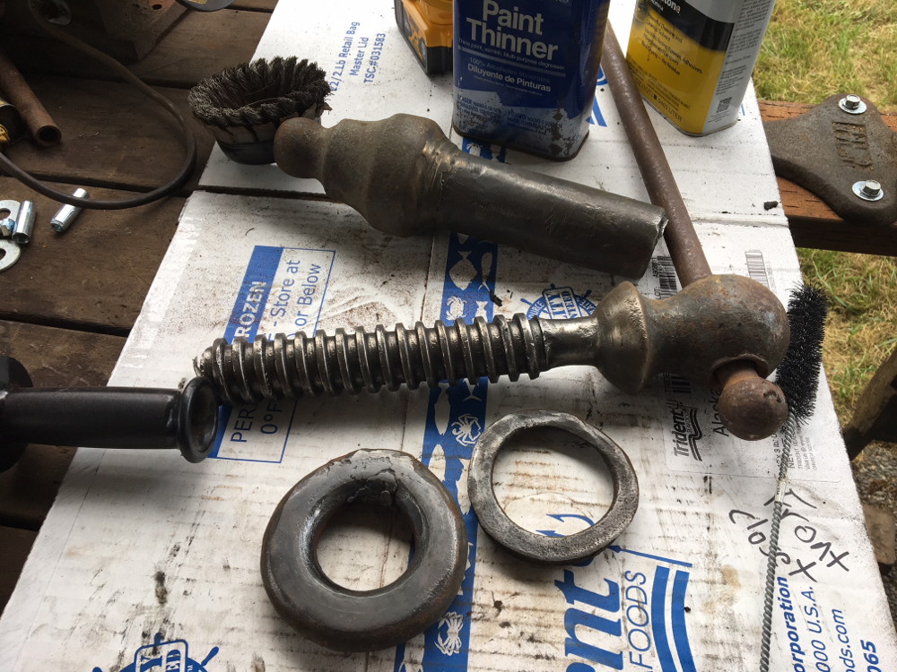

When I had my 145 apart for cleaning and I found the following:
1) The screw box has been brazed/repaired
2) The thrust washer shows signs of being forged welded so it's likely either been repaired or is wholly shop made
3) The screw box washer has also been forge welded and doesn't look to be factory
4) The spring could be factory but it sort resembles half a leaf spring
On my old 85 pounder the mounting bracket was home made and the spring had been made from an old prybar. It came with a big ill-fitting flat washer as the thrust washer (why I switched to the throw out bearing). The thing to remember is that these were owned by blacksmiths who used them hard and were quite comfortable with making repairs when needed. Both of these old vises work perfectly despite their age and repairs.

That big washer is a burly thing! Your vise looks quite a bit heavier-set than this one I’m messing with.
It's 4-3/8" o.d. and 1-1/16th thick, likely forged out of 1-1/18" round stock. The screw is 1-3/4" o.d. There's a reason this thing weighs 145 pounds. It's all burly.

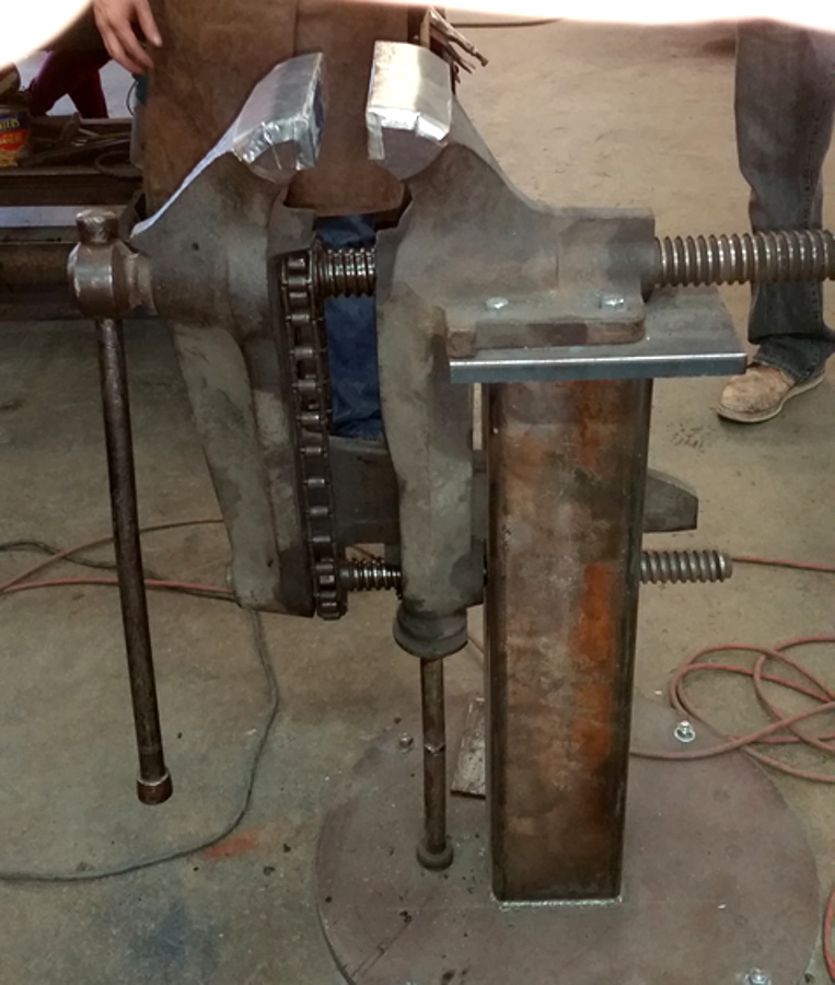

My friend, the late Larry Langdon of Monster Metals had a 9-inch jaw vise with a chain drive to a lower screw so that the whole moveable jaw moved parallel to the fixed jaw. This sort of thing.....
But that isn't Larry's. I can't find a picture of Larry's. Anyway, Larry's made mine look like a pussy vise. But Larry was a real blacksmith and I'm not.
It's 4-3/8" o.d. and 1-1/16th thick, likely forged out of 1-1/18" round stock. The screw is 1-3/4" o.d. There's a reason this thing weight 145 pounds. It's all burly.
Oh Man! How do you follow that post and not feel inadequate lol! That chain driven vise...i have never seen nor heard of anything like it before.
