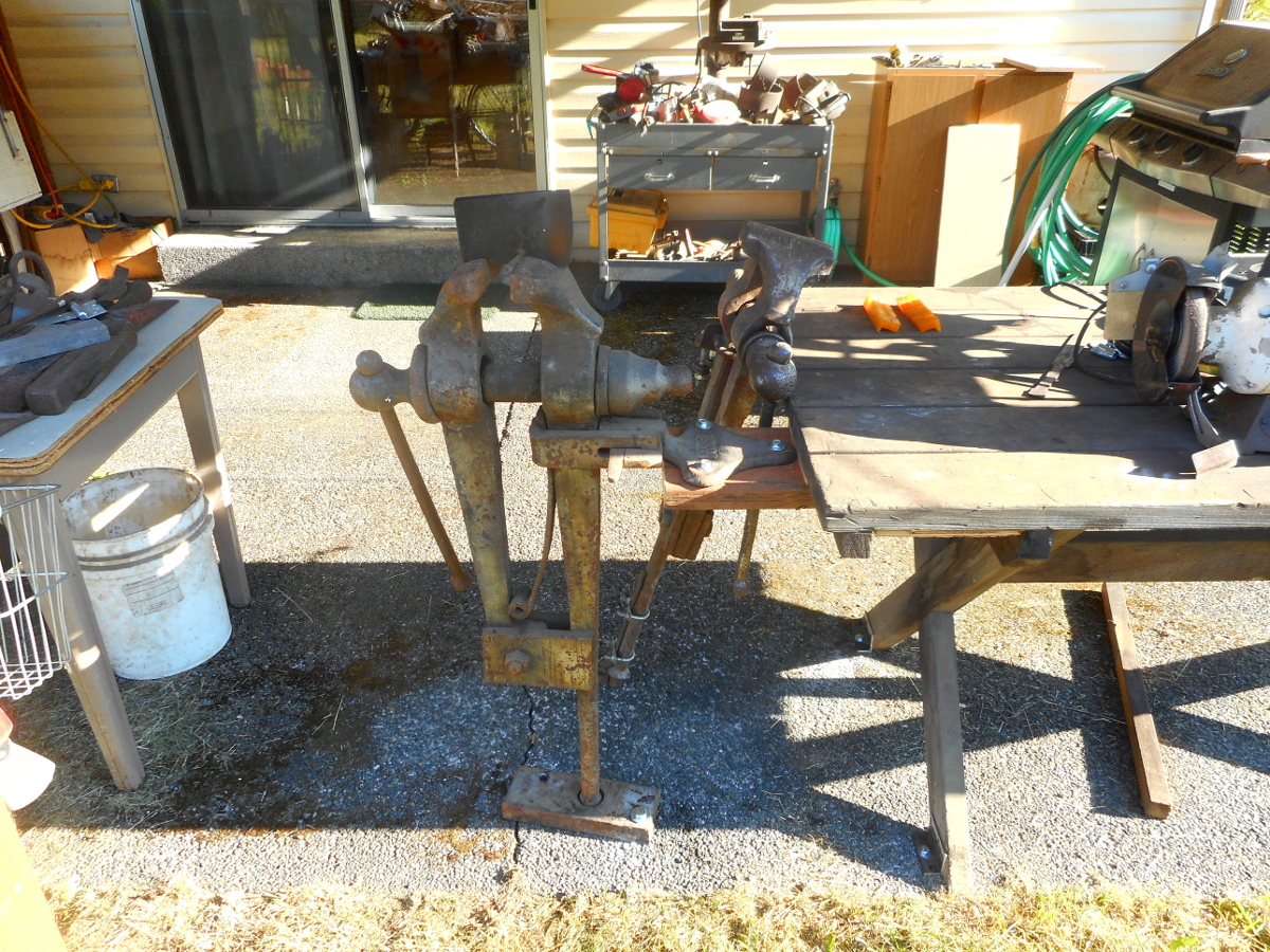

I moved in May and my life has been in disarray ever since. Only this past weekend did I finally get a leg vise set up again. I figured I might as well upgrade from my 6" 85 pound vise to my 6-1/4" 145 pound vise. For most things it wont make a difference but I have some tooling in mind that will benefit from being held in the heavier vise. More on that later.

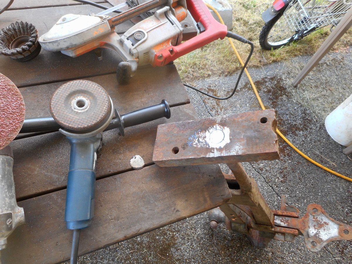

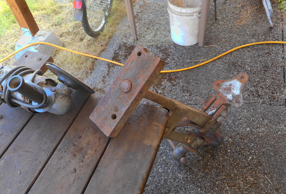

The old vise leg had poked through it's foot from years of use, protruding about 1/8".
I cut it off with a bandsaw and then ground it a little past flush.
Here it is mounted with my old 85 beside for comparison. I'm still missing a bolt in the foot. That will come soon. And I need to clean it up. But it works great. Sonofagun to drag around!
