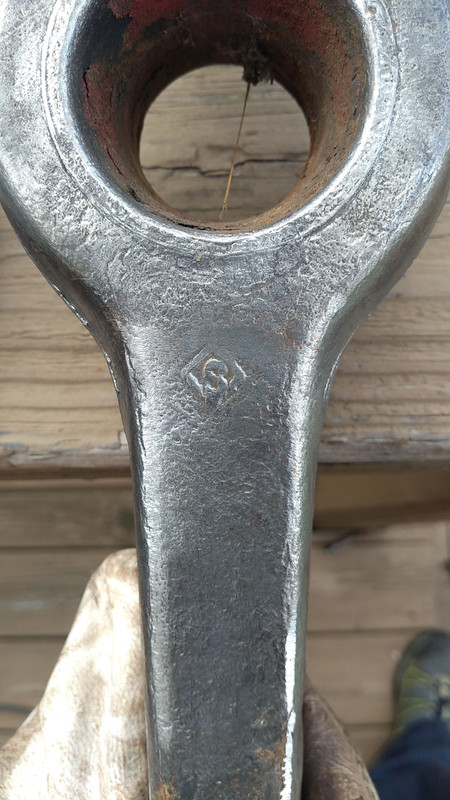

Agent_H, as far as marking go, all I could find is an S in a triangle on the inside of the movable side. On the outside I'm pretty see I see a CO, but I don't see any other markings but they may be obscured by all the hammer strikes and especially weld on it. apparently this thing was used a good deal by someone who did a lot of welding.
However, I found this ebay auction, and as far as I can tell it is identical to my vise - except mine doesn't have the markings on it, at least not anymore

oh sorry Agent_H. I just re-read this thread and saw that your vise also has the triangle with the S stamp. Guess they are the same. Is your vise also 4.5"? if so would you be willing to send me the dimensions of your u bolt and the part of the bracket that the u bolt will go through?

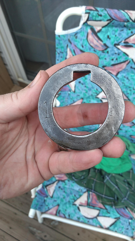

The thrust washer is the smaller beveled metal ring that goes at the handle end. The screw box washer is the larger one with the slot in it that the tab on the screw box passes through/sits in.

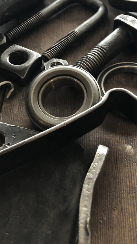

The thrust bearing is marked by the red 'X'. If your replace it with a throw out bearing the 'open' side of the bearing should face the vise and the handle should push against the 'closed' side of the bearing. You can easily damage the throw out bearing if you reverse it.

Thanks!! but if I add a bearing, shouldn't I also keep the thrust washer, as the washer is dished out to fit around the contour of the spindle - it is not flat as in the above schematic. wouldn't I want the bearing to fit over the screw thread shaft and slide inside the hole in the movable arm so that it can act like a bearing?
Agent_H, here are the stamps on my screw box, and screw box washer.
oh wait, nevermind. I guess you can't put a bearing into the hole in the moveable arm, because there needs to be play in there to accomdate the changing angles when you open and close the vise right?
Flint, your washers and box look good to go.
The thrust washer(handle end) can also be referred to as “thrust bearing”, if ruined, can be replaced with an auto clutch throw out bearing. Something like this one:
I shouldn’t presume others’ intent but I read part of Square_peg’s post as mentioning that if you put your existing washer or a replacement auto bearing on there backwards and tighten the vise, it will ruin either of them. The original will have force applied opposite to its design and potentially crack, the replacement auto bearing will have the center pushed out of it.
Your existing gear looks good to me. The parts’ markings also match those on mine, making me think we do have the same maker of vise.
