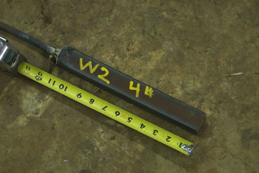

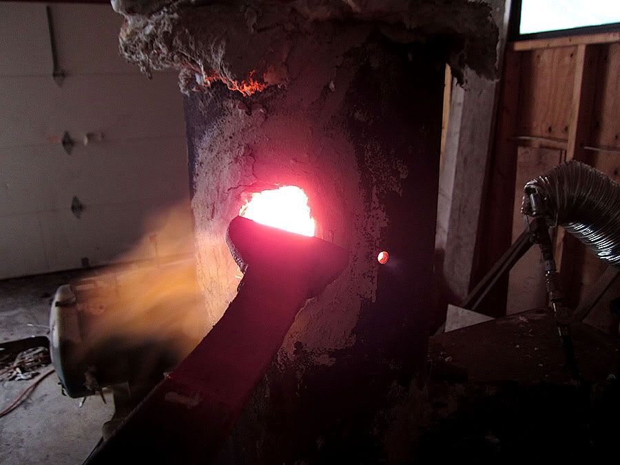

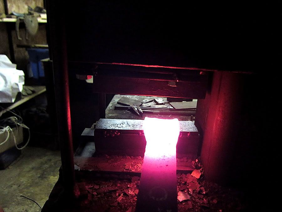

okay. Here is the chunk going into my vertical blown forge:

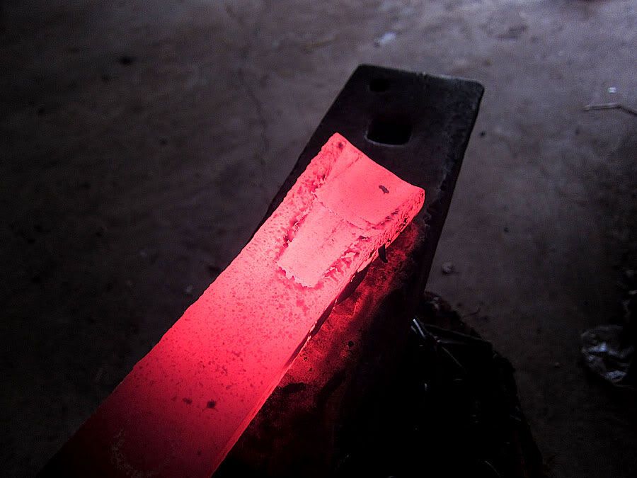

First thing to do is fuller out the end to get the length of the head. In retrospect, I should have upset it first... but I really didn't think I needed to.. and it would have been a bit of a daunting task to boot. I think I will get what I need anyway. Here it is going into the press with my drawing dies. With my C-frame I can come in from the side to fuller.
First fuller:

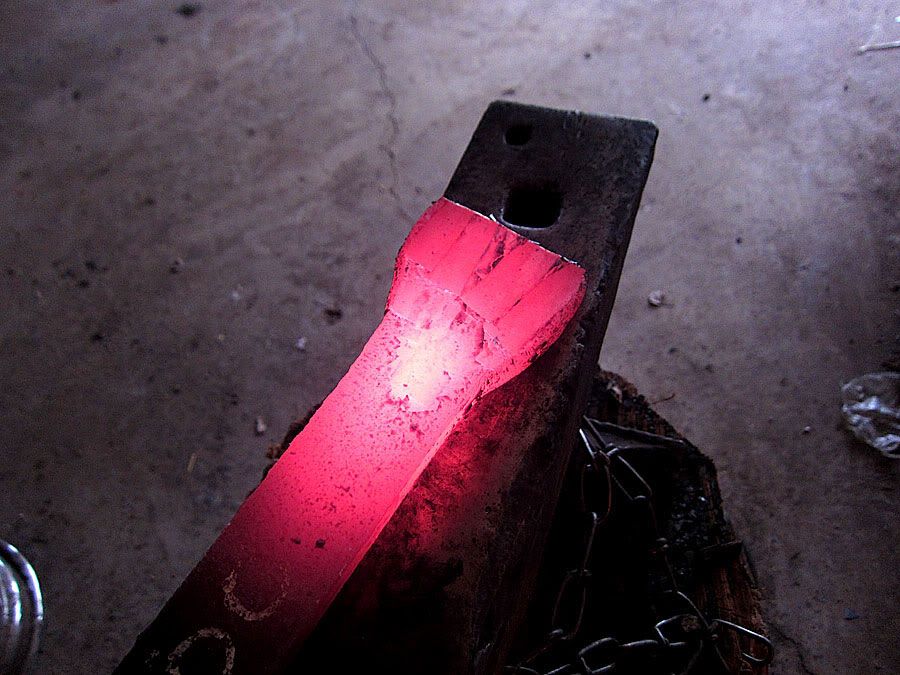

After a couple heat doing that action.. it goes to the flattening dies:
So that was the majority of what was done here... drawing dies, then flattening dies:

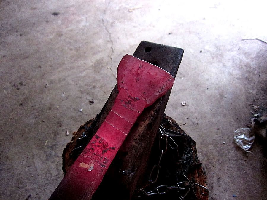

Starting to draw out the handle:

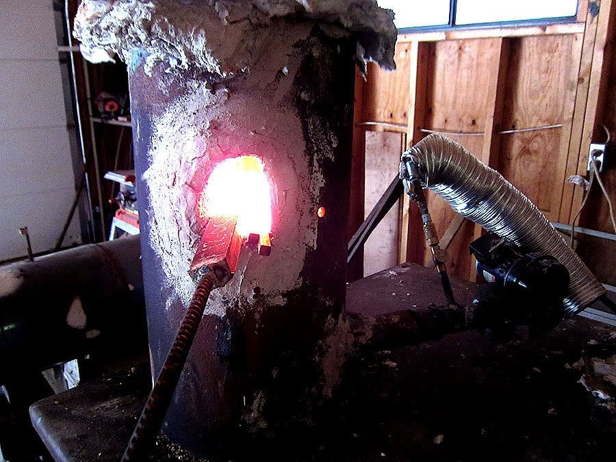

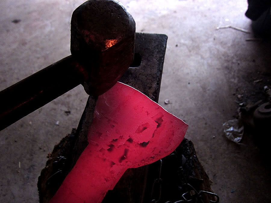

Getting too wide for my forge! Had to switch to my horizontal welding forge:

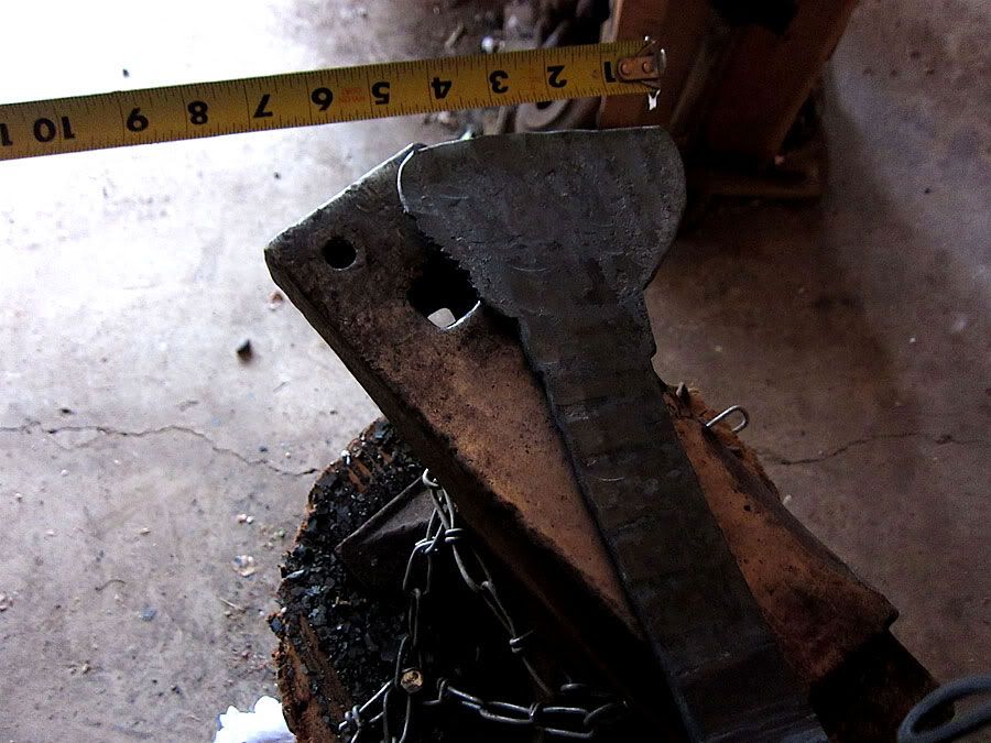

Using the hammer to help draw out what will be the spike:

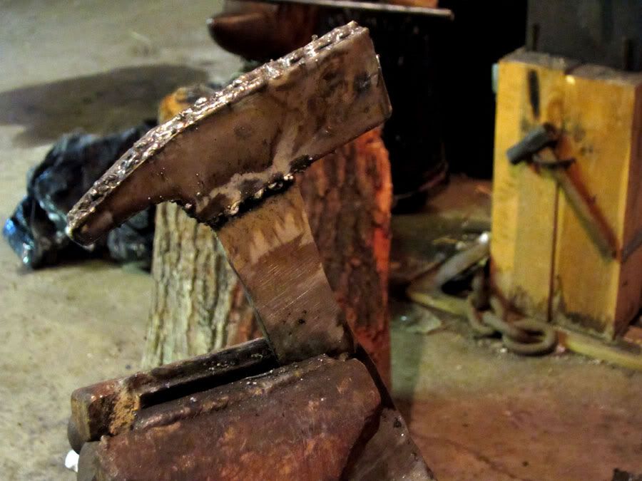

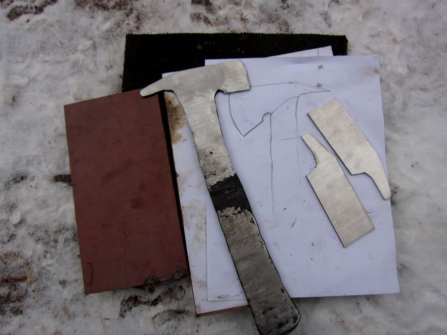

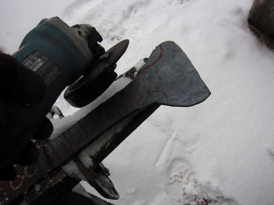

And I stopped here. This may be going to a customer so I want to get some feedback on profile, etc. It's about 1/4" right now.. so still some meat to get more out of it. I will probably use the angle grinder a bit to make it easier to forge down and draw out the spike. I MAY end up laminating stainless steel to just the head... and I'm still pondering how best to do that and still get a clean transition into the handle.
Feel free to comment and criticize. I'm sure there is an easier way to do this... but most times I learn better just by losing all fear and trepidation and just throw it in the forge. Hope to do more today.. but it's the last day of muzzleloader season and still no venison.
