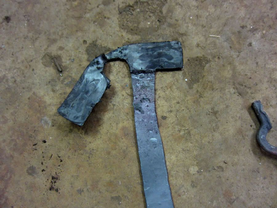

First... the Horror, the Horror:
That's what stainless san mai looks like when it fails. It fails utterly.
Rather than mess around with trying to re-weld another piece of stainless on, I just went ahead and removed the other side of stainless. Good thing I did... I smacked it off with a hammer. Not my day for stainless welding. So rather than give up, I cut some of my wrought iron plate out into two pieces for welding. This is some wrought I got from a local grain mill deconstruction and it patterns beautifully... more like damascus than any wrought I've worked with. So this will make for a beautiful, tribal style tac hawk if it all works out.
You can see some of the wrought plate sitting next to the hawk.
Wrought sticks way easier than just about anything and all I had to do was rough grind the scale and do a couple of tack welds. This time it stuck like glue. I will show the weld lines tomorrow when I etch, but here is what I will now be working with:

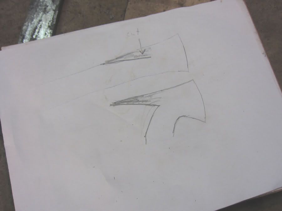

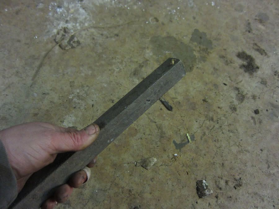

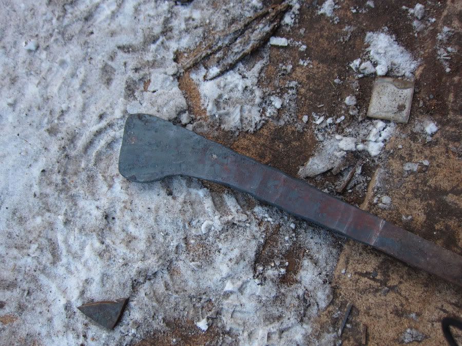

On the side I've been trying to figure out what to do in terms of a full tang hawk from my 1" square 5160. So I started forging out a head while the forge was heating up for welding to see where I could go with this.
I didn't think I would get a heavy enough blade if I forged out the head and spike and then draw out the tang... so why not make a cut for the spike and the bend over the head and THEN draw out the tang???? Might look unconventional and maybe a bit 'artsy'... who knows.

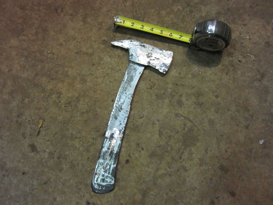

In my fevered state I had an idea regarding this thing. Since there is a lot of interest in reducing the weight of the handle on these things... why not do a hidden tang? I've been a little worried about a slight off-set in the center-line going from the tang to the head. This happened when using the press to forge weld the wrought iron to the head. The concern is that if I grind it to correct it.. I may end up with too thin of a tang. And forging it is awkward with the head in the way, etc. So... why not forge the tang down and do a morticed, hidden tang construction with split scales? I would make sure that the tang was the full length of the handle to dispell any fears of the wood breaking.. and I could even let it emerge as a glass breaker. This tapered tang would greatly reduce weight in the handle as well as provide great hand feel (should greatly reduce hand shock I would think).... and I don't think it would sacrifice strength because the wood scales would be pinned through the tang just like in a full tang. It is also a great savings in good tool steel.
Bad idea? Too late. It's done.. already forged the tang down. Pics later.

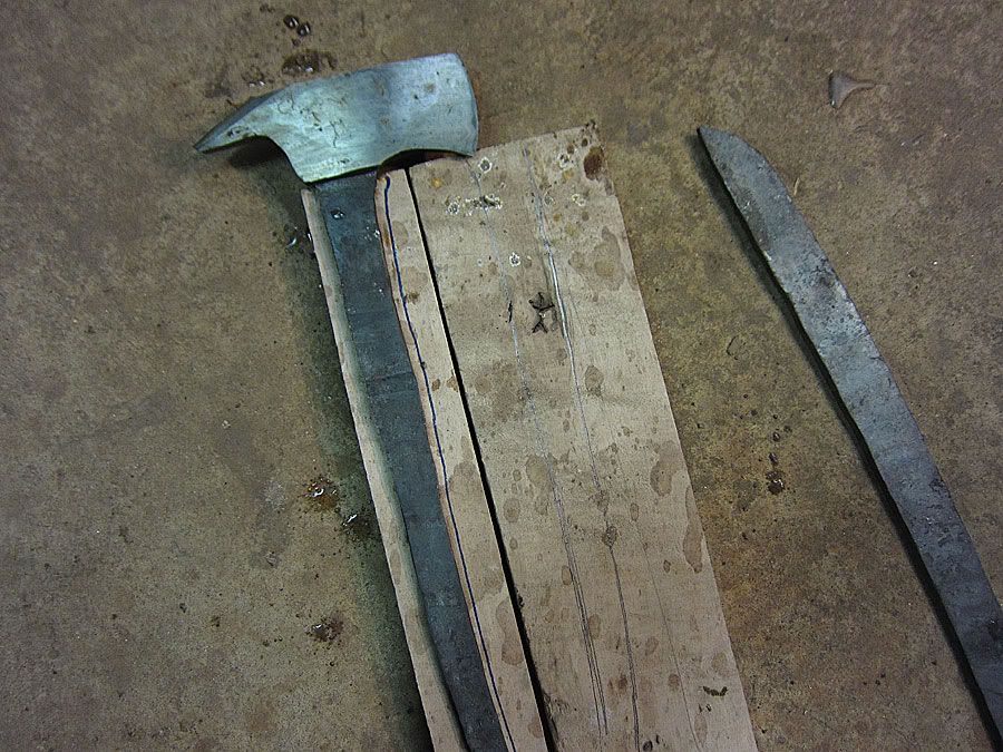

Okay here is what I've done today.... which isn't much because I have a knife due by Christmas and I'm just squeezing work in on this.
But here is what I'm talking about.... tapered tang and you can see the outline in the wood where I will mill out a slot for the tang. I will probably have to narrow down the tang a bit towards the head to keep the wood from being hair thin up there. (you can also see a little bit of my W2 wakizashi I'm forging)

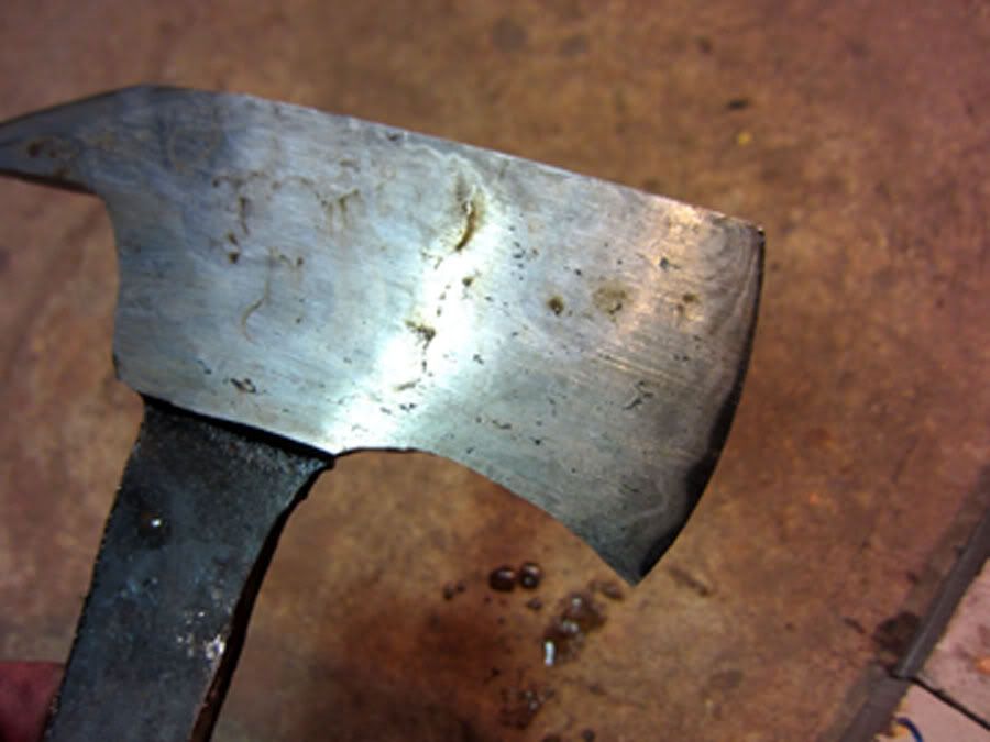

I haven't settled on a final profile for the head yet. Still not sure what to with the spike. But here you can see the W2 peeking through..and a sneak preview as to the awesome etching pattern of this wrought iron.
Sorry for the poor quality of this image:
Right now.. the midpoint of the head is just under 1/2" thick. I may wait until I put the wood handle scales on before I decided to thin that down. But it's nice right now to have some meat to work with in terms of balance. Here you can see the W2 layer sandwhiched between the wrought iron...

Like I said... still working on the spike. :-) I had to grind off the very tip where there was some slight delamination.
