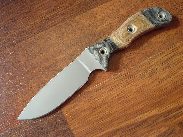

Not that you should COPY it, LOL... but the handle on David Mosier's small Trigonaut is very comfortable in the hand... I'd love to see something close to it on the NukeNessmuk. :D

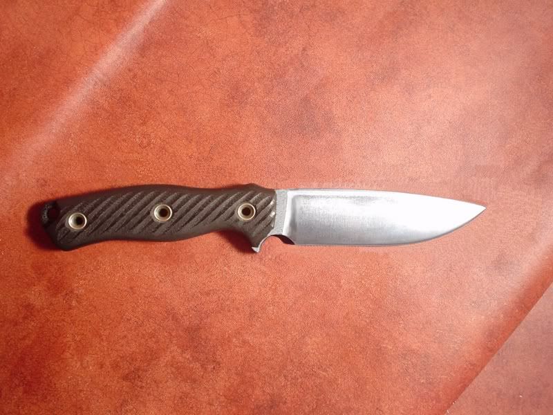

The maroon/black handled knife on the LEFT:
One of my favorite, "go-anywhere" blades is this lil bit o'cheese. A bit of modification in the blade shape for a Nessmuk style but the grip is perfect. :thumbup: Please, please, please use the "mini-mag" contoured grips of this one again! A spine thickness of 0.1552" and double cut. :D
For a nessie style, I suppose you could lose the choil (though I like it on this blade A LOT) and even lose a bit of blade length with the edge gained from the lack of choil.
(No, this pic isn't mine. Mine is much more well used than this one! :D)
That's mine ;) :thumbup: :thumbup:

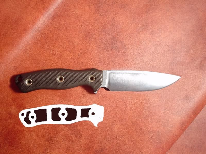

Sorry for throwing up a bunch of Rats for comparision, but here is my idea of a Bush knife:
Bog Dog II - Concept
(.... my submission for a Swamp Rat - Bush Knife!)
.... Or Busse Bush Knife.....
I think the Bog Dog has certain elements for a good bush knife. Mainly in weight and blade-shape.
The Bog Dog had a blade shape similar to the SJTAC, but smaller.
My concept for a great Bush knife would combine some of the Bog Dog characteristics and the HRLM/Ratmandu handle, but a little slimmer and lighter in the handle.
IMO, if a Bush knife is going to have a choil, the choil should be in tight and close for a more comfortable grip and help bring the blade edge closer to the reguler grip.... or no choil at all. Unfortunately, it is my opinion that this means eliminating the Talon hole.... my opinion....
The radius of the handle on the Ratmandu/HRLM handle is in good and tight behind the guard. I think this is a better radius than a shallow radius that makes it hard to get your grip up on the blade.
I don't feel that a Bush knife needs to have a monster thick blade, but obviously that is debatable.
Here are the dimensions of the HRLM and the Bog Dog:
HRLM.....= 9.0 ounces; .190" thick; 4.13" blade; 9.3" oal
Bog Dog = 5.0 ounces; .140" thick ; 4.75" blade; 9.56" oal
I propose the Bog Dog II have dimesions close to:
Bog Dog II = 7.5 ounces (?); .175" thick; 4.375" - 4.5" blade; 9.4 - 9.5" oal
Key features include:
- Similar handle to HRLM/Ratmandu, but slightly slimmer handle proportions - height and thickness
- Blade shape similar to Bog Dog, but with slightly less drop than older Bog Dog and slightly more belly, but still pointy - see comparison pick of Concept Bog Dog II vs. older Bog Dog - or basically a smaller version of SJTAC blade.
- Skeletonized tang - to save, weight, improve feel and balance and will still be plenty strong!
- Choil in closer for better comfort when choked up and more blade edge.
Concept Bog Dog II
Under HRLM and above old Bog Dog and Ratmandu:
... notice the cut-out areas have rounded inside corners to help reduce weak-spots! ...... I assume Busse has the blanks laser cut (????).
:thumbup:

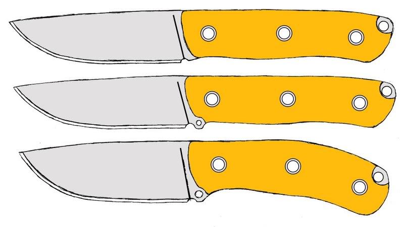

Here's what I would love to see:
The top one is a classic drop point without a gaurd, which I feel just gets into the way. I feel this pattern is the most effective for utility/bushcraft use. (My Fav.)
The Middle one is the same as the top but with a small guard.
the top two have dimensions (approx.) of:
Overall length: 8.5"
Blade length: 3.75"
And the bottom one is a pretty standard drop point shape which is a little shorter and stockier than the top two.
The bottomb one has dimensions (approx.) of:
Overall length: 8.2"
Blade length: 3.75"
here's a pic of my fav. (guard less) with a background:
Thanks for the opportunity! :D
