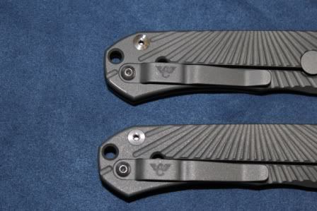

The first few batches did not have the WC logo on the clip, but the new batches do.
I bought a StarTac from the first batch that had the logo. I think it was more hit and miss on the early ones.

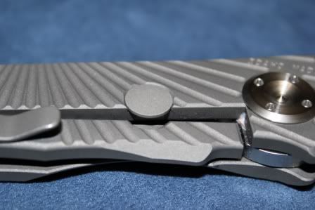

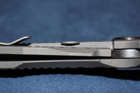

Those who have followed the nearly 25 years that the Sebenza has been around know we continually make small improvements, alterations, advances to our knives. None of these changes are made to follow a trend, to keep up with the Jones or to tick off our customers. They are done to improve performance, safety or production. That we make a change to the Umnumzaan should not come as a surprise.
The disc has been added to the Umnumzaan to prevent the reduction of tension on the lock. Because the shape of the Umnumzaan handle is a little different than that of the Sebenza, it takes a different technique to open and close. We have found some customers are not willing to learn the difference or perhaps they don’t recognize the difference but, whatever the reason, they think it is necessary to modify the lock tension, thinking the knife will open more easily. This simply makes the knife unsafe. We have had several Umnumzaans returned to us because of lock issues – almost always the customer denies having modified the lock. We can see what has been done, and are put between a rock and a hard place as we don’t want to call out the customer for not telling the truth. The disc is a solution to prevent potentially unsafe modifications.
Please note this disc is not a lock stabilizer as it has been called in some posts. It is simply in place to prevent the lock bar from being pushed out to reduce tension. Our locks are fitted properly to very close tolerances and do not need to be stabilized. And to save further speculation, the disc is press fit into the handle. It is made of 303 stainless steel, and is sandblasted along with the rest of the handle. Because it is not titanium, the sandblasted finish looks different.
Will it change further? Quite possibly. What might these changes be? No idea at this time.
It will be a while before you see Umnumzaans other than the Wilson Startac with this disc. This has to do with our on-hand inventory of machined handles.
We are not planning to add the lock override protection disc to the Sebenza. We do not have the issue of lock modification by customers to the same degree as we do with the Umnumzaan.

Sorry I called it a stabilizer . I realized I was wrong when I saw it wasn't deep enoug to prevent vertical movement. I for one like the improvement. As great as you might be at using lock you never know what a friend might do or you might do by accident .

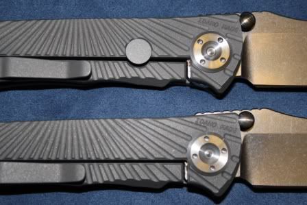

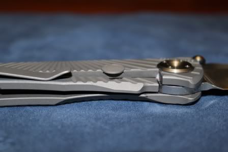

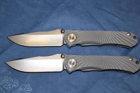

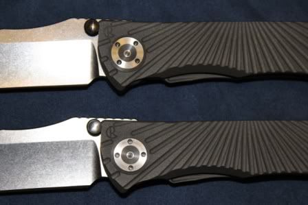

I received my original model:D and still have the new version. I'm going to take some better pics of both side by side to show the difference. I'm extremely pleased with the original and I'm sure the new model will serve those that purchase them equally. Wonder if I can keep both:rolleyes:
It's a shame that people try to "mod" their CRKs then screw it up and send it to Chris to clean up their mess. All it takes is some patience to break these in. I admit that at first my Umnum was a little harder to disengage but that's because none of my other blades were like that and I wasn't used to it. After countless times of pleasurable practice, I think the Umnum is the PERFECT blade. The Startac is the PERFECT compliment. Enjoy the pics...
