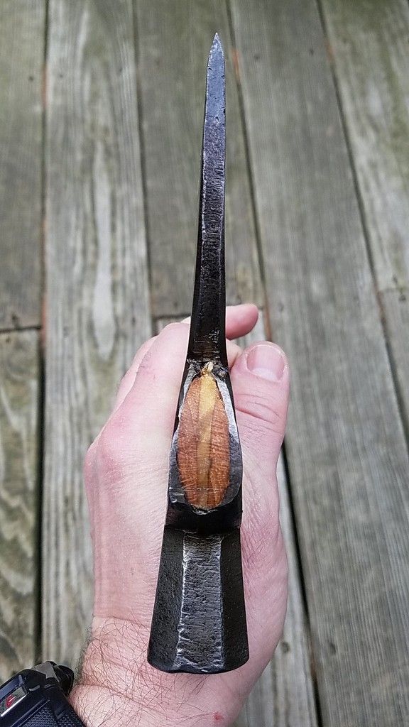

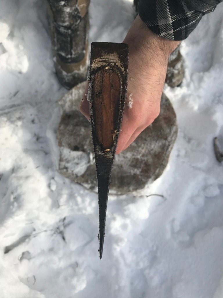

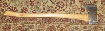

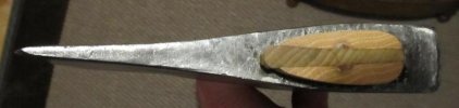

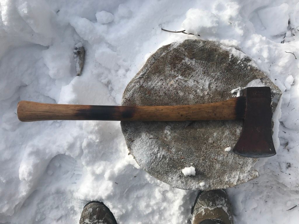

Put this Ardex 3.5 pounder on a 36" straight handle. (Too long, perhaps. Maybe 32" would be better?) I thought it would make a good splitter. Might do as a feller as well. As many on this forum say, it's like personal preference.

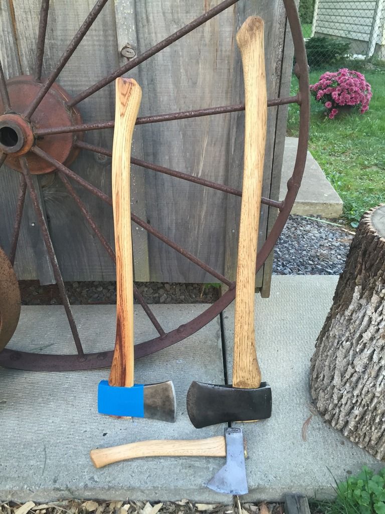

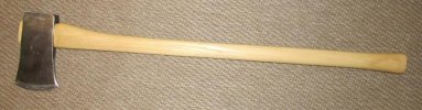

Just finished this Berghaus. Unfortunately, I had to give it a vinegar bath, so it has that dull finish. I would have preferred a nice patina. It's on a 32" handle that's been sanded and treated with mineral oil and beeswax. Lots of filing went into this one. Staple broke off at the base of the handle. Not a fan of the staples.

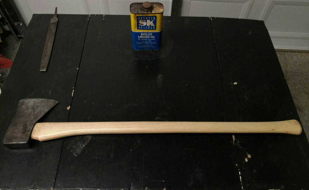

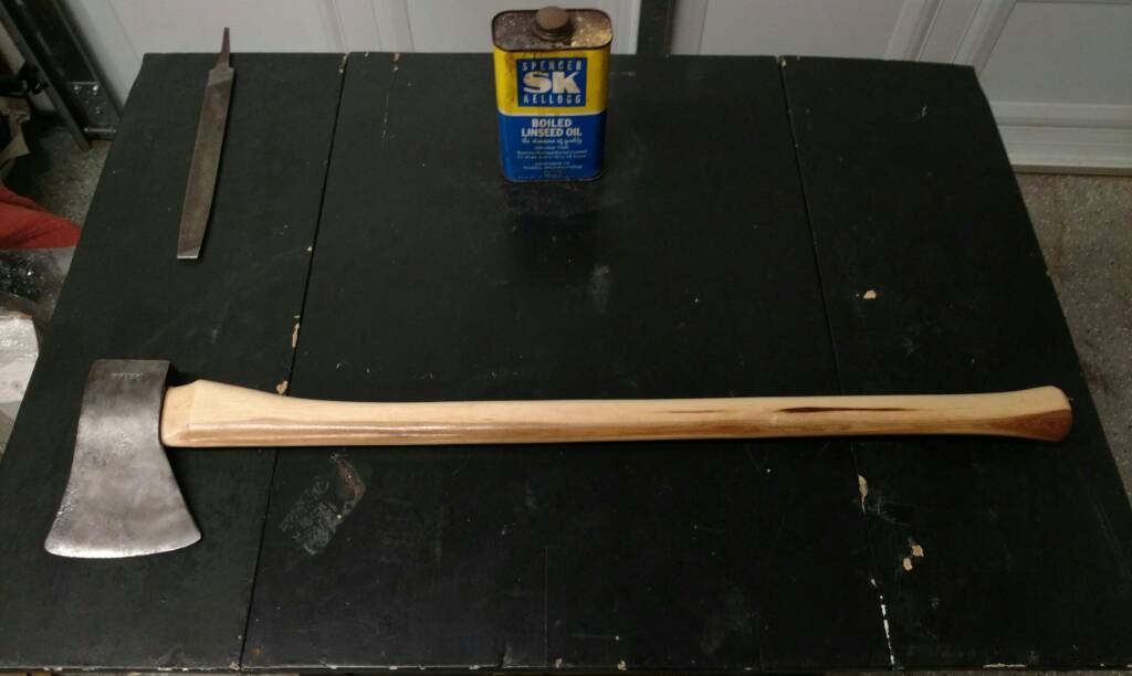

http://imgur.com/a/BZ83h bingmaster handle on the flint edge, all i had to do is make a new wedge, i love it. house handle on the sager. black walnut, burned with BLO, or just BLO for a finish? i know my grinds are sloppy, i got metal in my eye and wasn't focusing.

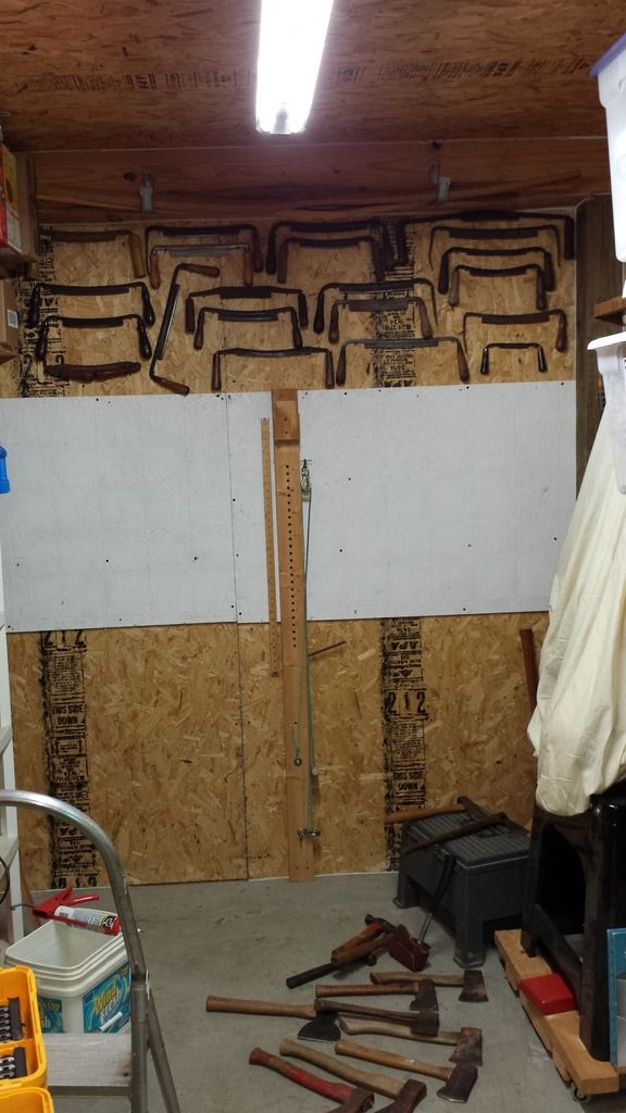

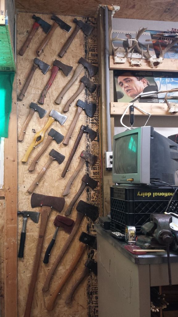

Not a rehang job. More like a hang up job. I'm finally getting around to putting up more OSB on the walls of my work shop. I got my collection out of a bucket and onto a wall where they can be appreciated better.
I moved my draw knives while I was at it.

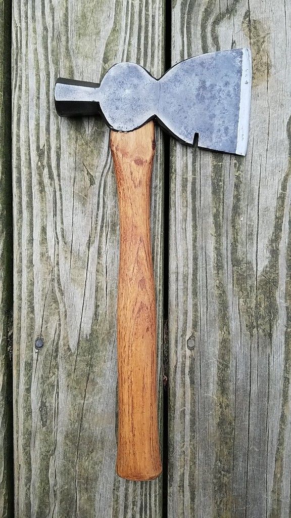

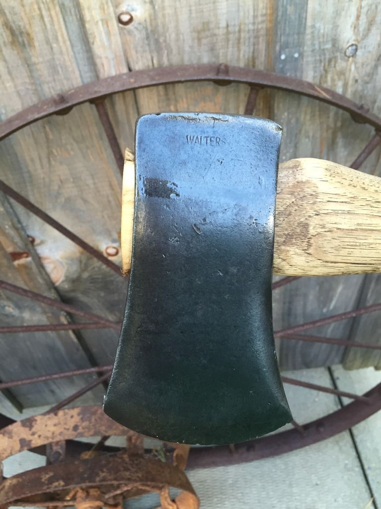

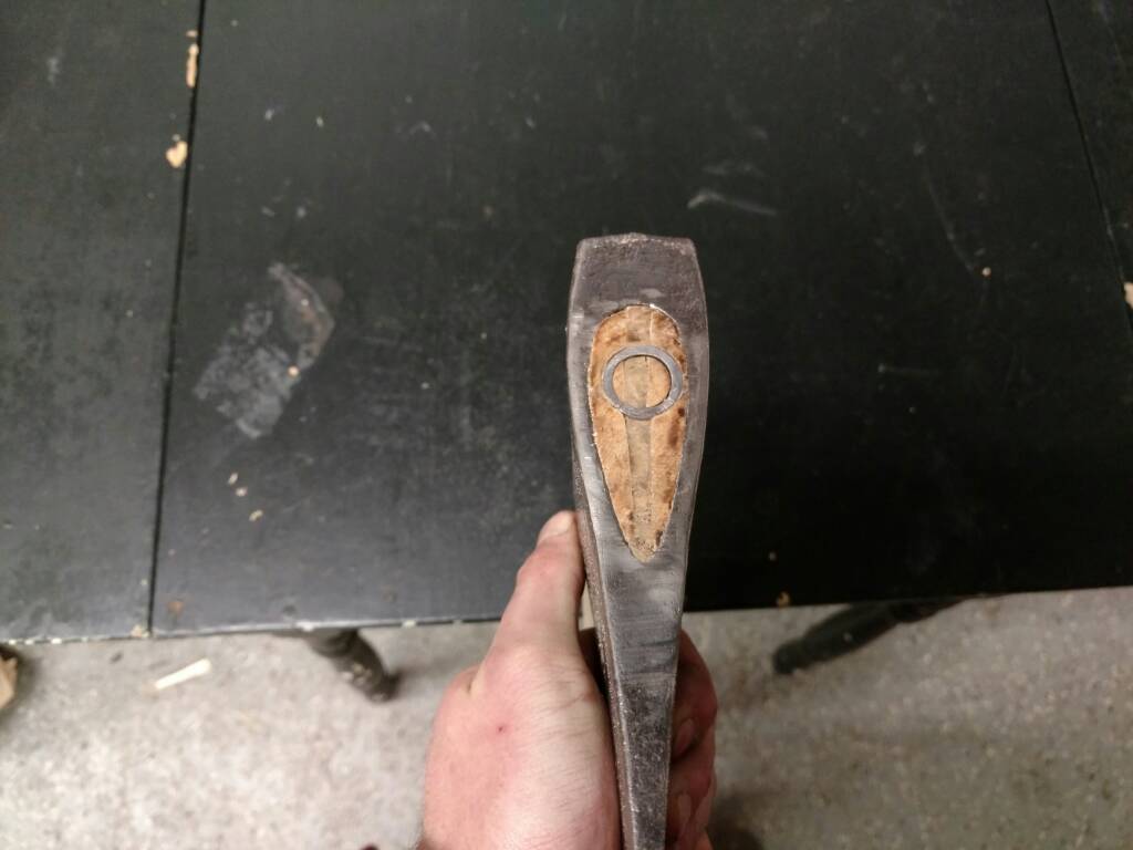

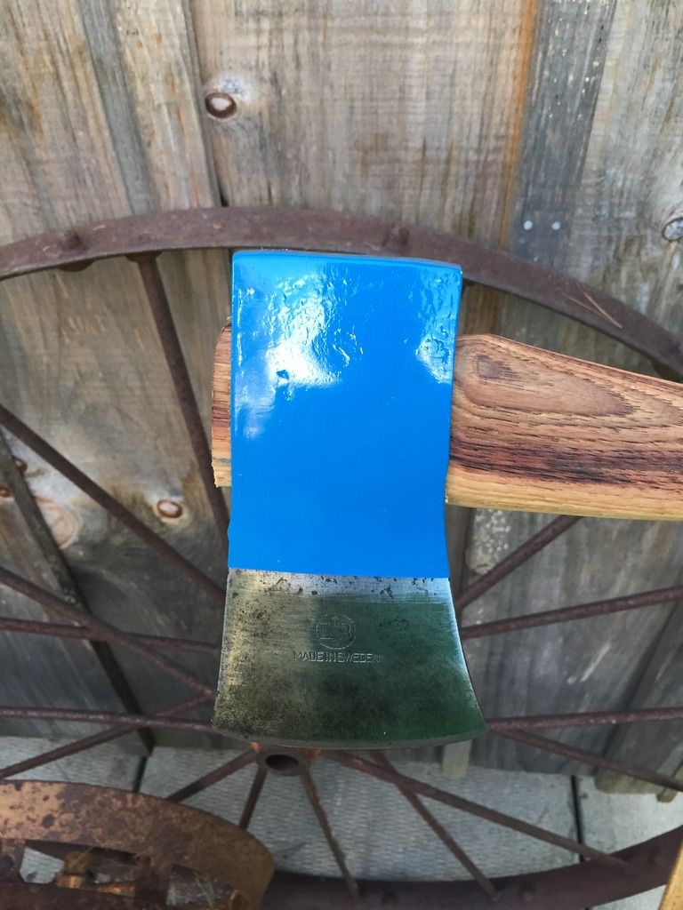

I rehung this Norlund on it's original handle, it still needs some straightening but the hang is tight now (and doesn't have that stupid metal wedge). I'm not the biggest Norlund fan but this one was given to me by my Grandfather so it's sticking around. Yes it cuts well.
There's nothing special or mystical about these Norlund axes, they're made post 1966 by the Mann Edge Tool Co., the steel is a bit softer than older axes and it has flat cheeks (which I usually don't care for). The saving grace on this particular axe is it's thin profile and the fact that I reworked the edge very carefully. You'd be far better off with an old True Temper or Plumb by far.
