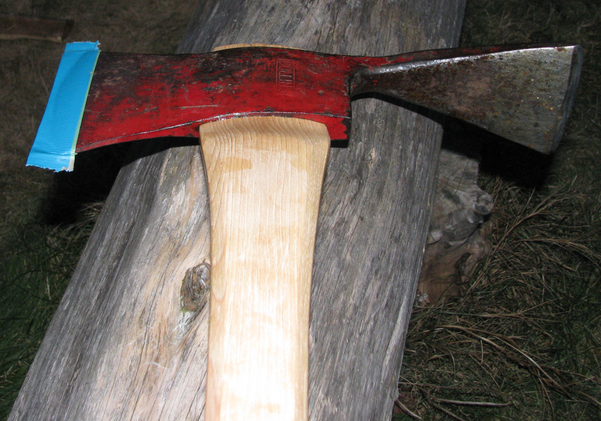

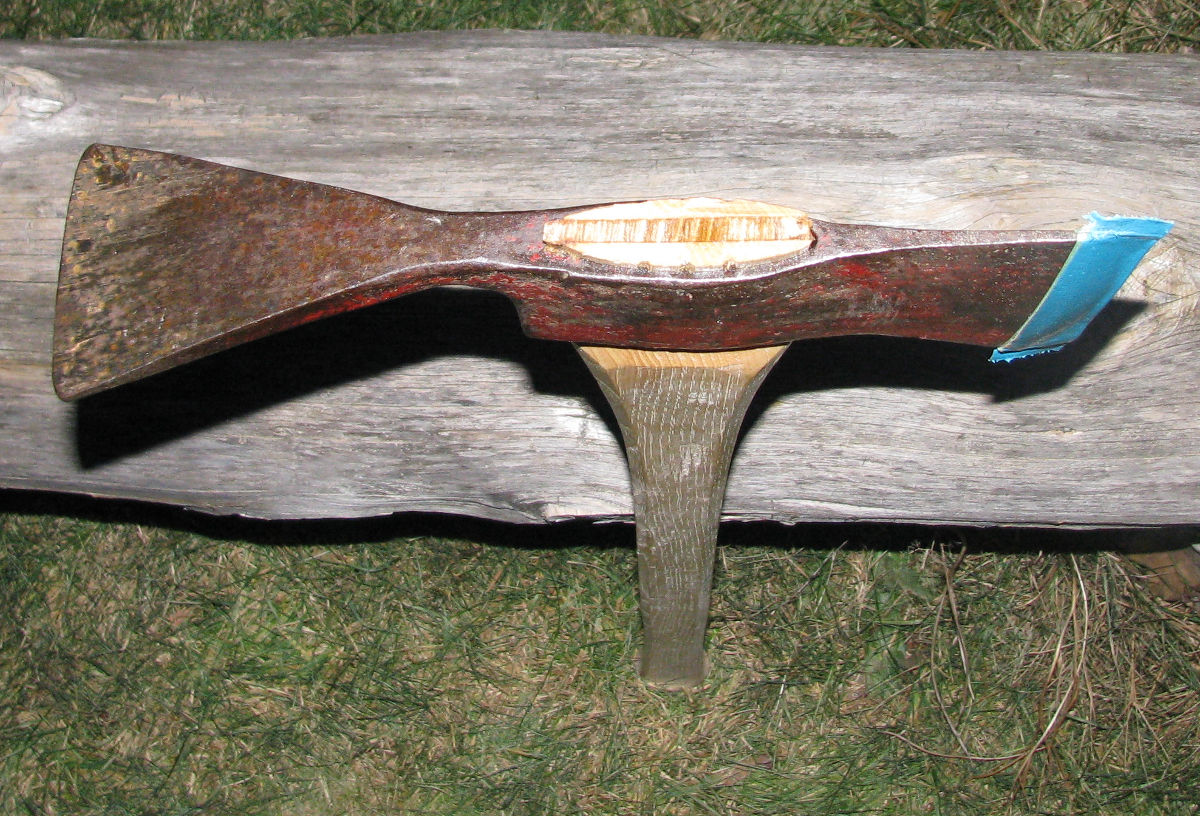

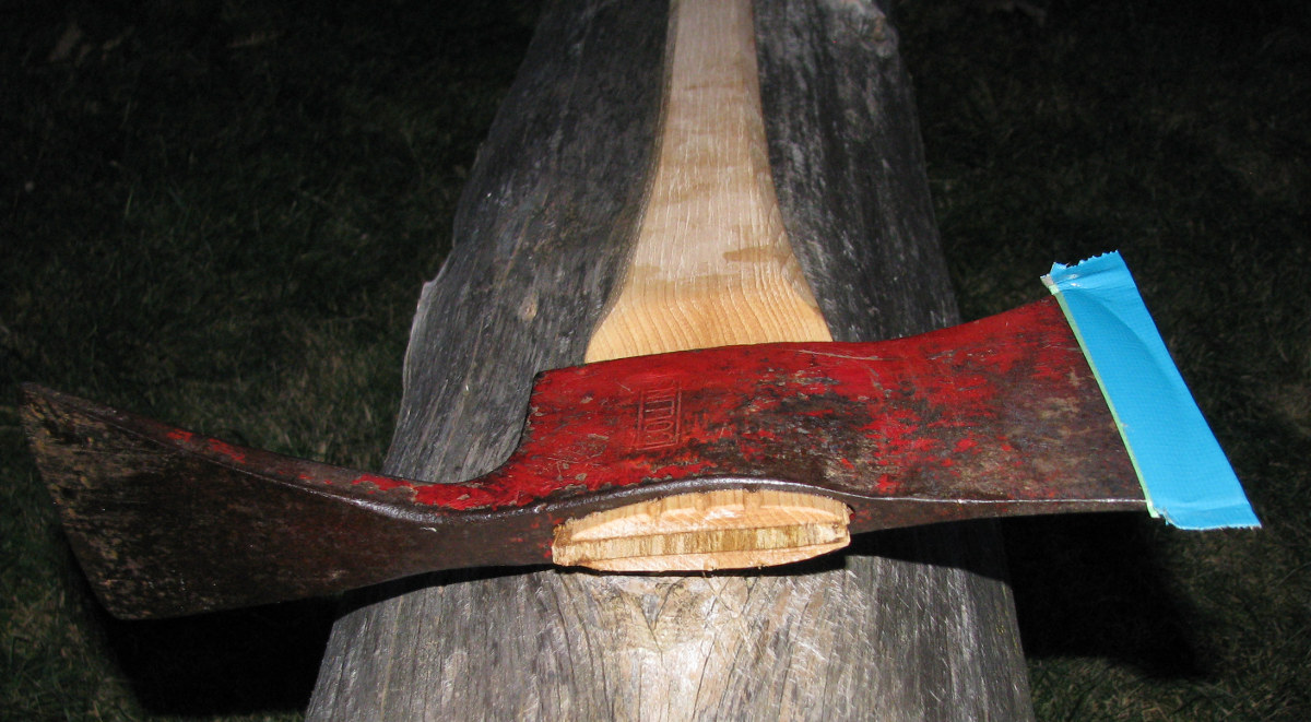

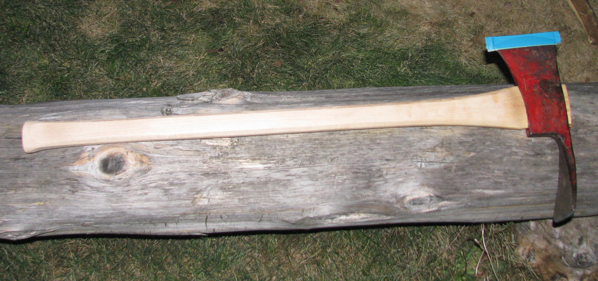

I re-hung my Collins Pulaski with eye ridges. This will be a gift for a friend and fellow trail worker. She's a strong trail worker, good with an axe and deserving of her own Pulaski.

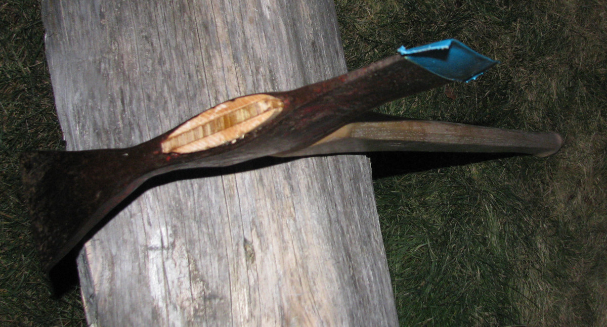

Elm wedge. Blade made safe during hanging with duct tape (protection) over green painters tape (no residue). This is also how I ship sharp axes.
Left the adze end a little under 1mm wide. Any thinner edge will be damaged in the ground.
My standard octagon handle carved out of a hardware store Link (? Do-It-Center) haft. I choose ~45° grains for Pulaskis because vertical grain hafts break sideways so easy on a Pulaski. The eyes are only 5/8". This is one of only two Collins axes I've seen that have eye ridges.
Last image showing the swell. Sorry for the crappy pics. They were taken just at dusk. I still need to finish the haft. It will get a couple coats of BLO followed by 4 coats of tung oil.
Nice Squarepeg. Is that a commercial handle you thinned down? She will love it. Pulaski's make nice gifts even to folks that aren't trail workers.
I like the way you thinned that handle down (real nice) Never thought about 45* grain for a Pulaski, but it makes sense. Nice work Squqre_peg!
You'll often see Pulaski hafts snap off right below the head. With vertical grain hafts they break very easily there. And doing trail work an inexperienced volunteer will pick up a tool and break it before you can correct them.

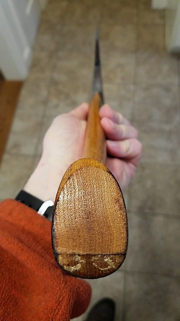

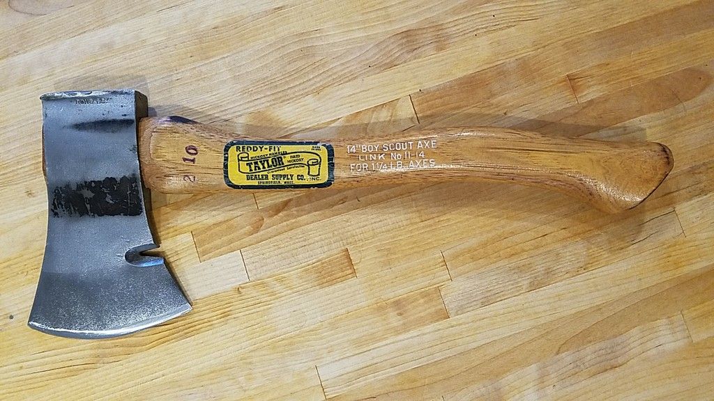

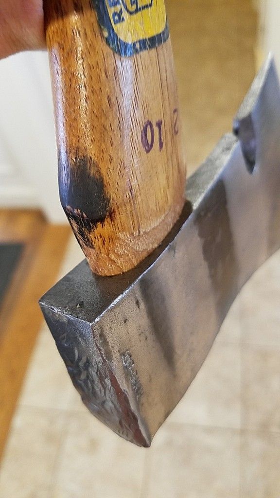

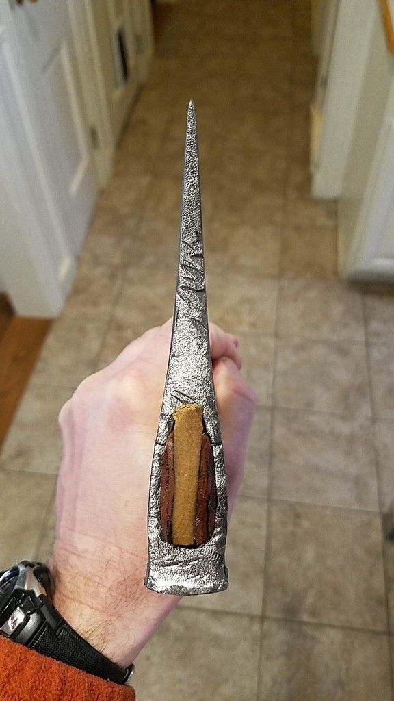

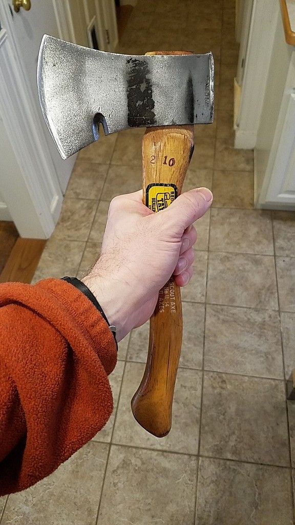

This is a nice "Strong Boy" hatchet head mad in West Germany on a very nice 14" NOS handle.
[/URL]
That's pretty sweet. You don't see very many of those Strong Boys. I think they were made in Solingen - known for their knife steel. Here's what one looks like on its original handle.
Mine came with a Scandi grind and it's an excellent carver on the stump.
