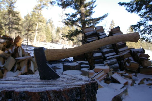

This is the second of my Snow and Nealley Hudson bay heads, I used a HH house axe handle for it that I reshaped a little. Wanted a kindling splitter and this seemed like a good choice since the grind is pretty blunt on this one.

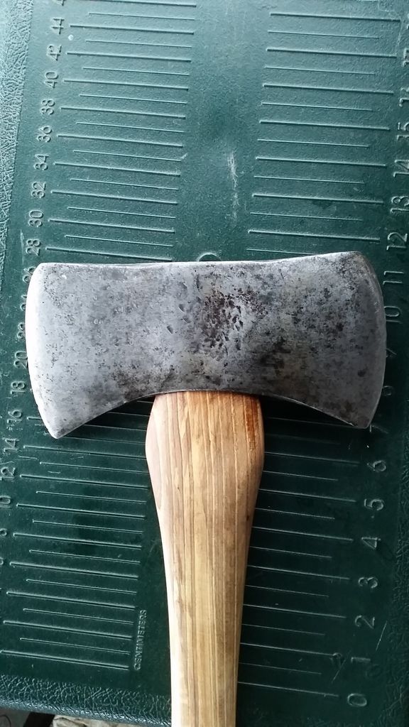

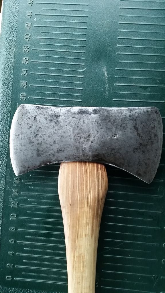

It doesn't compare to what you guys do but it's mine and I like it.

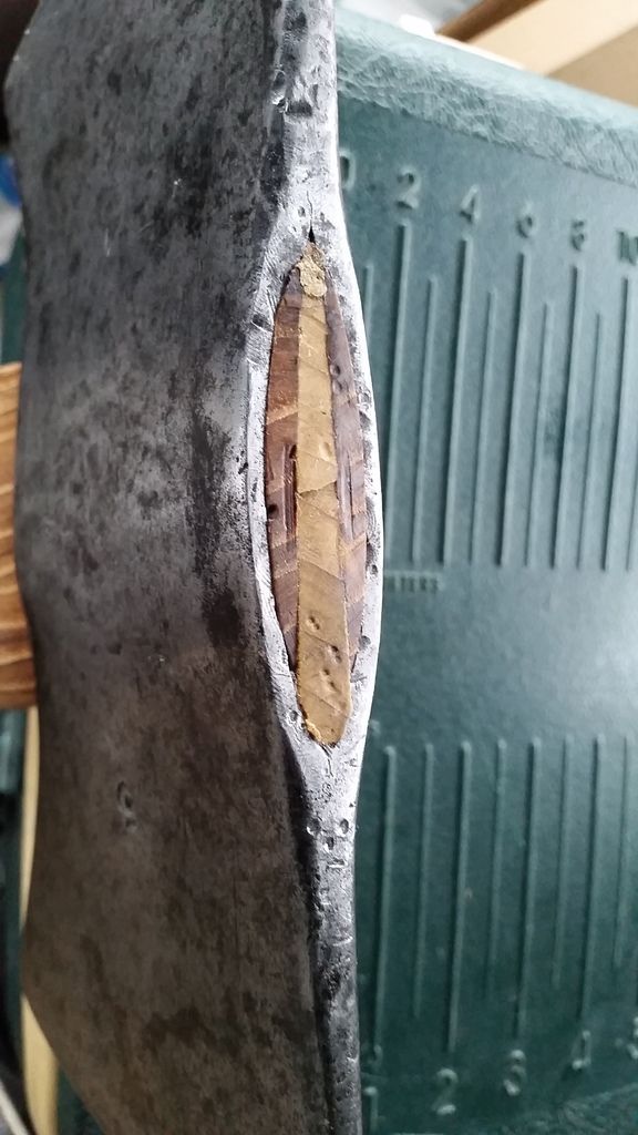

thats a good lookin double, if your handle breaks, make sure to get one with grain running parallel with the blade, not perpendicular, it's okay it just adds more strength to the handle
Yeah, I noticed that too late. I got this handle as a project to help gain some patience. I loved the shape, thickness and color of the wood and I knew it would take me a lot of sanding and rasping to get it right. Generally I don't have the patience but I wanted to get past my normal comfort zone.
Then I noticed the grain. Ughhhh.
Hopefully it will last. If it doesn't, I will get to do it again. :D
