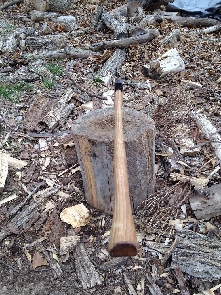

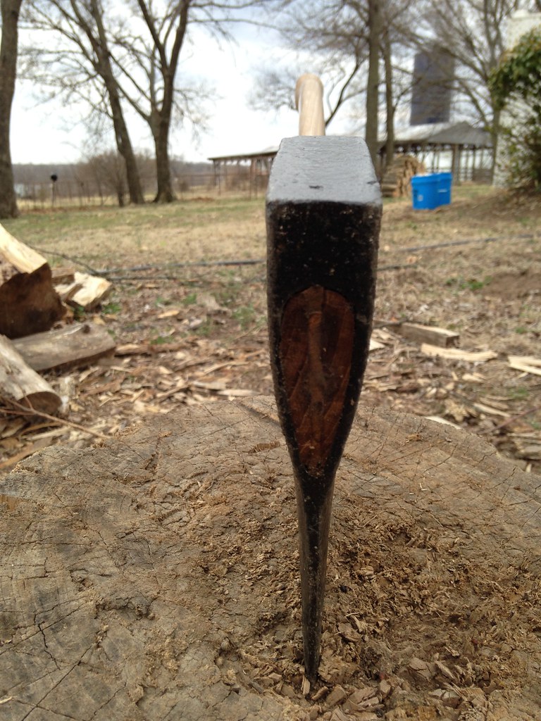

Looks good. Light head on a long handle makes for a handy axe.
Falls City Kelly Works...I was looking at yesteryear tools at the kelly section and it stated kelly was based in LOUISVILLE, KENTUCKY 1874-1897+
Is the Fall City a reference to Louisville? So is this axe possibly that old?
Based on info from yesteryearstools.com,
If it says "Kelly Works" it's from 1930 or later.
If it says "True Temper" it's from 1949 or later. <= INCORRECT
If it says "True Temper" it could be from as early as 1938 (or perhaps earlier?)
The "Falls City" stamping is one of their brands.
Acquisition of Kelly Axe Mfg. Co. and Operation as Kelly Works 1930-1949+
Corporation Name Changed to True Temper 1949-1987+
from http://www.yesteryearstools.com/Yesteryears%20Tools/American%20Fork%20%26%20Hoe%20Co..html

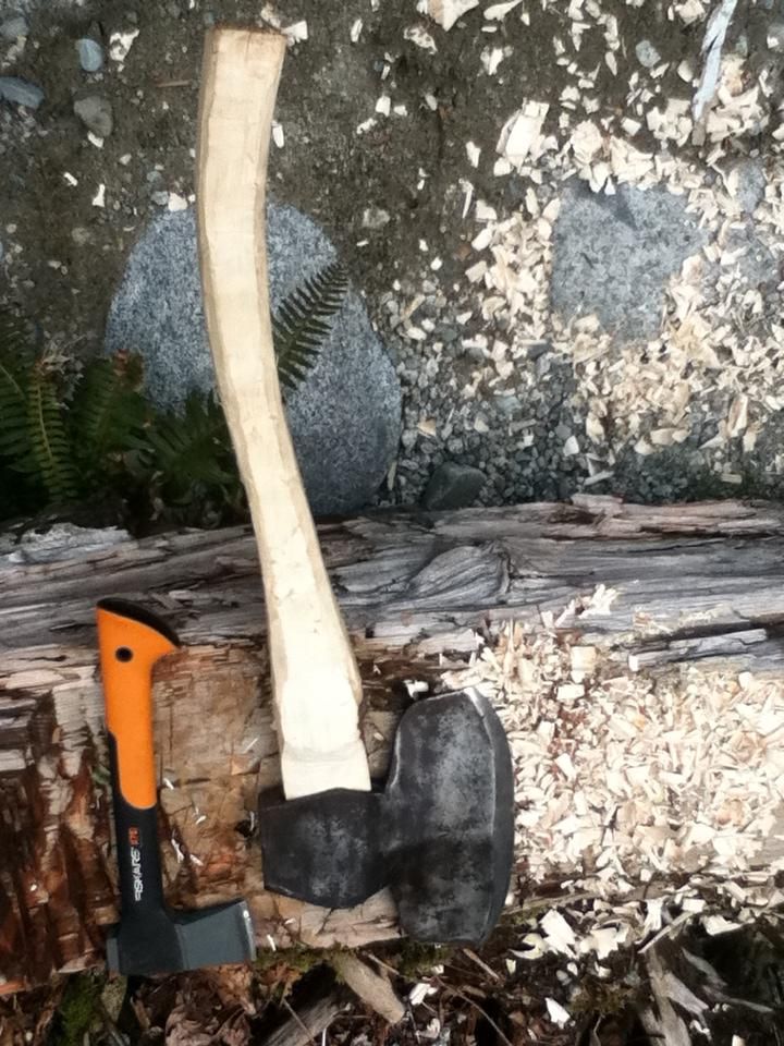

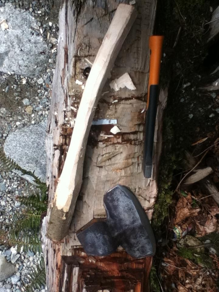

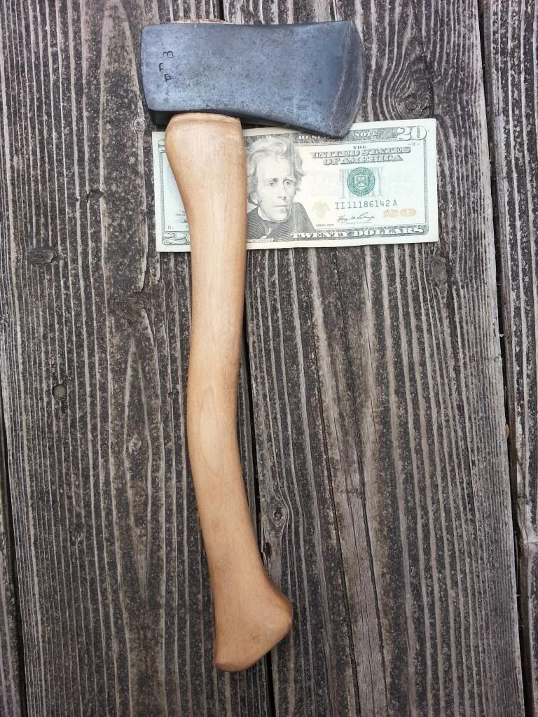

I completely forgot I had this little mini hatchet in the bottom of my knife box. Spent the day making a handle for it and rehanging it. All I used was some old firewood that had a nice straight grain and no cracks (douglas fir). I figure the hatchet is small enough that this kind of wood would be alright... At least for a while. We will see!
PS- anyone know the maker? "FB" is marked on both sides.
I think because of the off centre kerf I could not get this head to sit properly. I tried for a long time to make adjustments but it only seemed to be getting worse. In the end I hanged it anyway, which might have been foolish. I felt sort of sick putting in all that work and then driving it home when I was not happy with it.
Will have a chance to put it to work this weekend.
Thanks for looking,
wdmn.
