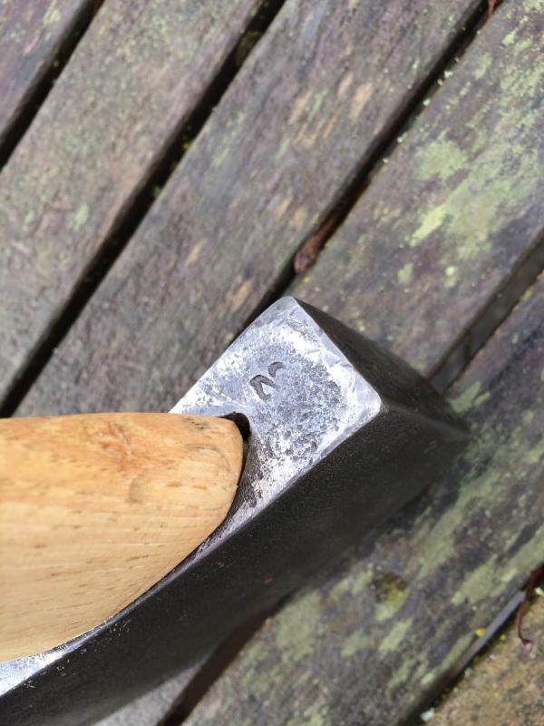

Enough room between the shoulder and eye to carry your own tinder kit...
I was thinking that was a fine looking hatchet not to have a stamp. Wasn't expecting it on that side. The vintage haft was a great choice.:thumbsup:

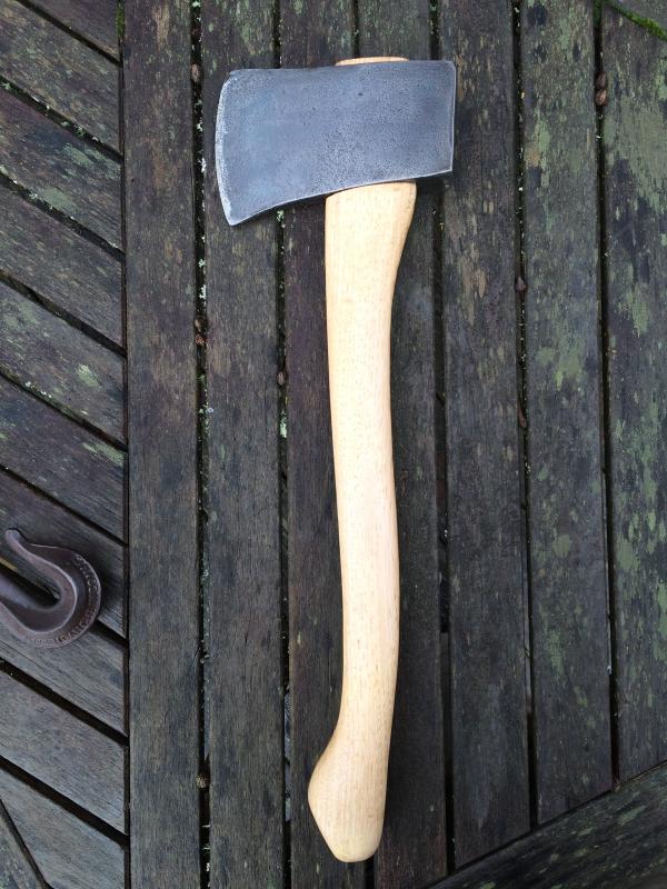

Thank you! That handle had a Craftsman's hatchet head on it with one of those steel step wedges in it. That one isn't a crosswedge though. The steel wedge I pulled out left those hateful little holes in the top part of the tongue. Can't make them disappear once they're there but that handle was too nice to let them win.
I wedged it normally, cleared of the holes of any loose wood/wedging, and then carved tiny "wedges" shaped to each one. There are too many really nice handles that are ruined or let lay in a heap somewhere because of those steel wedges.

Thank you, I bet we can figure out what the F is on there.
It seems to balance to me.
Being a hewing/carving tool, blade presentation is important as well as control.
It's actually quite nimble and very sharp -
Besides, tis but a weee thing lol
