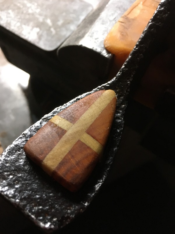

Now I know this won't go down well with many but when it comes to hammers, especially smaller hammers I believe steel wedges are by far a better permanent fix as apposed to only wooden wedges, even if cross wedged, wood as well as steel is needed.
This is not the same for larger eyes like axes, that's a different matter with bigger areas.
Obviously the shaft needs to be a tight fit to begin with, but in a smaller hammer head it might only need half an inch of handle wood to be "compressed" or "spread" on the outer end of the "hourglass" shape of the eye, anything much past half way into the eye isn't needed or desirable, also a higher pressure can be exerted on the wood with a steel wedge. A decent steel barbed wedge in my opinion cannot be beaten for this.
Of the scores of old hammers I've collected when a larger eye has originally been cross wedged with wood & steel it's usually half or even all of the wooden wedge that's missing, sometimes then sadly bodged with nails & screws.
I know many complain steel barbed wedges are often hard to remove without destroying the handle, the simple fact is a hammer handle hung correctly with a steel wedge will only need a new handle when it's beyond salvation anyway so that really doesn't matter, what matters is it NOT coming out.
A correctly hung steel wedged handle can be tightened back up easily after years of use or in an area with big humidity shifts by tapping the handle (usually on a hard surface, shaft down) & re-seating the wedge a bit deeper usually using a punch then dress a little wood away as necessary, obviously this is dependent on a good shaped eye & handle fit in the first place.
Off topic slightly, there a pictures floating about of poorly fitted handles where wooden wedges are used to take up "slack", a handle should be "tap it home" tight before wedging, soft hammer useful here.
I have a panel hammer I steel wedged in 1988, now I don't abuse my tools but that hammer has seen lots of use with as far as I can remember nothing more than an oiling (whatever was around) once in a blue moon, still tight.

What I don't get is the cross wedging: I see it as beautiful non the less, but it's not out necessity. I haven't used one in years, and it makes absolutely no difference. And if it does make a difference it's usually a bad hang to begin with with to much play. Or am I not seeing something something here?
A recent hammer hang I did (4 lb drilling hammer) had a noticeable hourglass shaped eye (inside). In order to fully lock the head expansion had to occur in two directions. Sure I could have whacked in a steel cross wedge like the factory does but I used wood instead. With a teardrop eye that is tightly fitted top to bottom you should only need to have unidirectional expansion but with an oval eye (mauls, sledges and hammers) it's good practice, and extra insurance, to wedge in two directions. Were a factory handle not to have a vertical kerf already cut in it I'd be inclined to do an X shape instead to the usual vertical/horizontal cross.

So that little Niagra hammer I did was for fun and a neat look. Also note that the handle was not designed to fit that eye without more material front to back. I don't think it will come off unless I want it too as it is fully support up to the ring of hourglass from the base.
Also it is a challenge to do without damage on such a small eye (only based on my experience).

So, "It's unnecessary in most cases" is a very accurate statement. I also think it's one of those things that you have to do several times to have them both get that sound we all know a wedge makes when it hits "home". From doing it numerous times I find it's not much harder than a properly shaped and installed single wedge. Someone asked about it here and I thought of creating a post describing what I think are some nuances to the steps involved to make sure you don't split your handle, your wedges reach all the way across in both directions, etc.
My posting crosswedged tools is not advocacy for them always being superior to a single wooden wedge or discounting the staying power of a stepped steel wedge. In fact, I think there is a short but steep learning curve and running out to try it for the first time on something nice can end in disappointment. I also might take some heat for this but I am going to say that they are much more attractive than adding a steel wedge.
I mean, we could almost say now there is twice the space to fill up with steel wedges without them even touching the handle material!
It's one more skill in the bag of tricks for salvaging those old tool handles we all enjoy.:)
