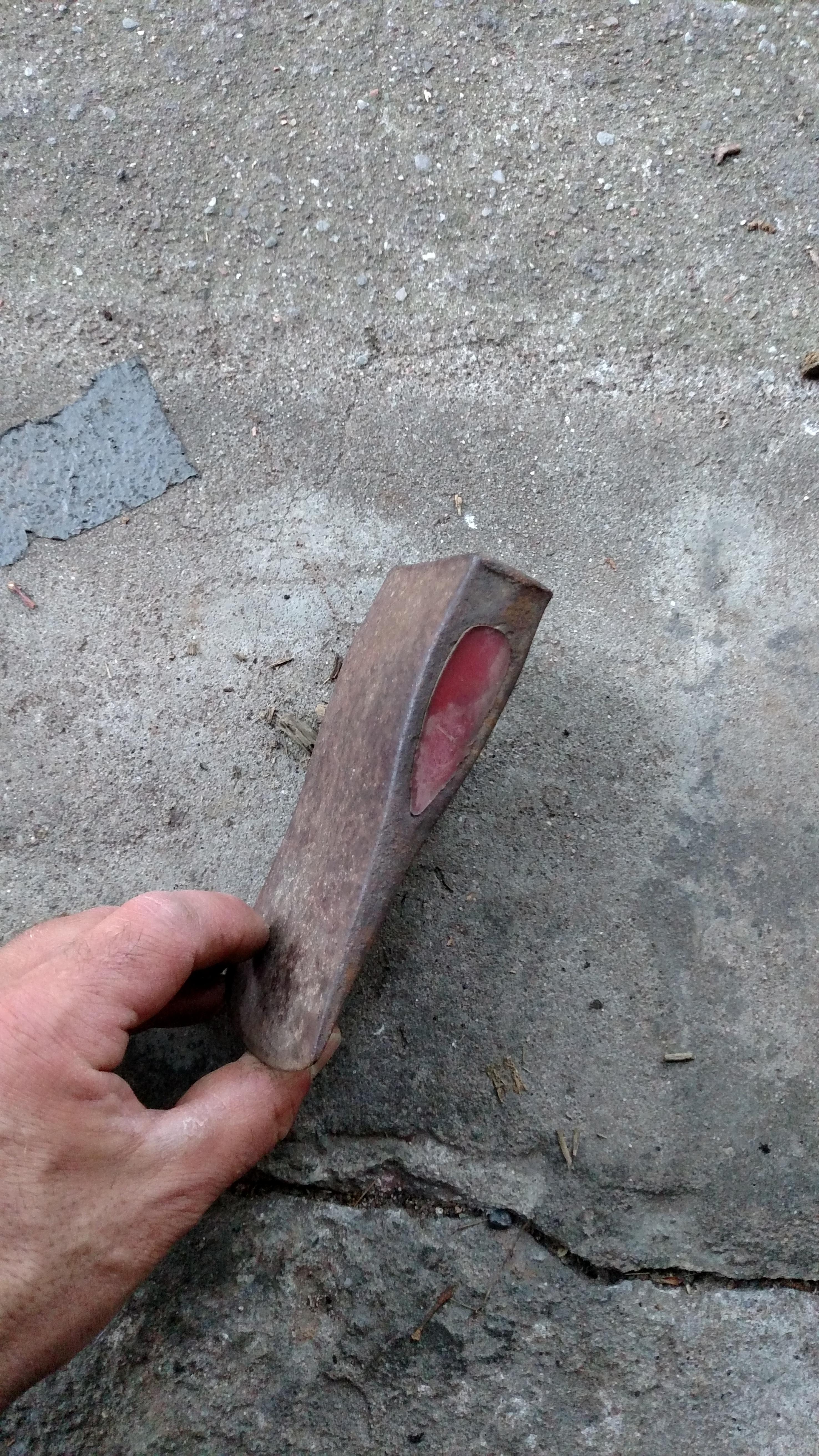

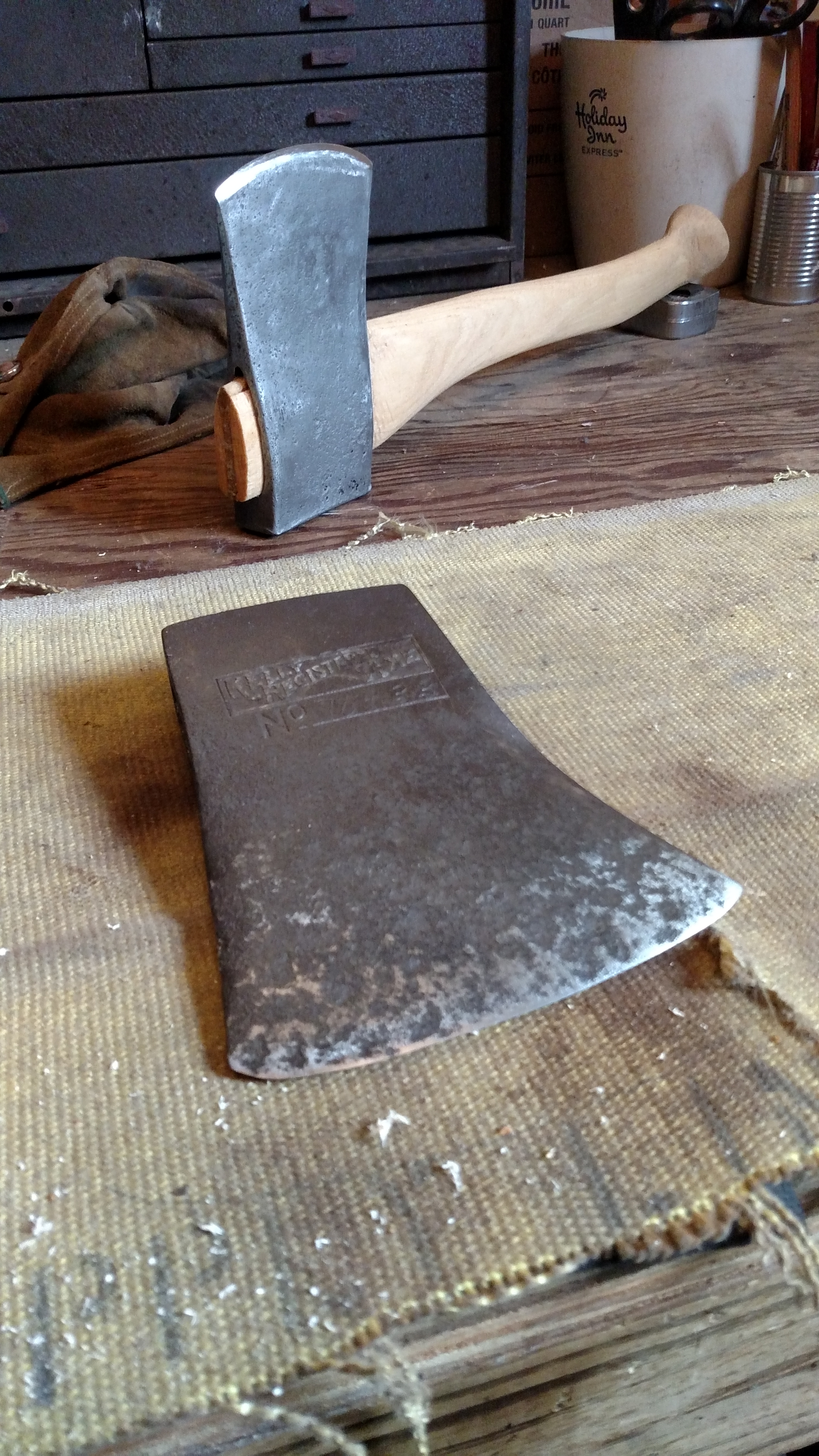

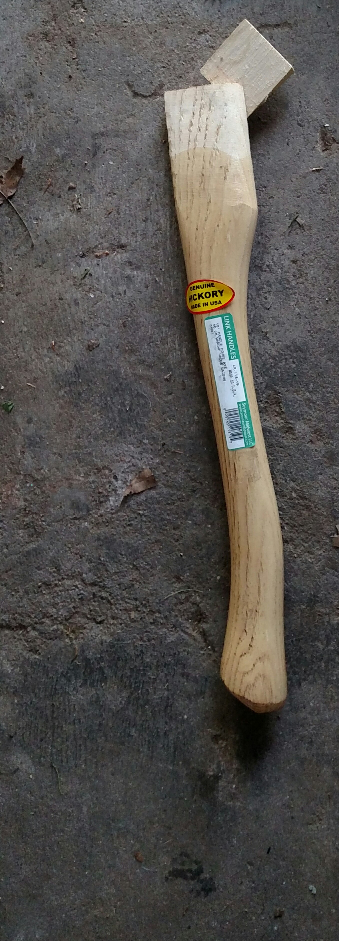

Not a rehang for me but a first hang.
...I did thin the handle a bit, delaquer and give it a knob like feel/style...
The axe head as I received it...
The Link House Axe handle, off the shelf.
Result...
Weight total about 2&1/4lb.
17" from top of the eye to bottom of the knob.
I plan to improve my skills for the next hang...
Thanks for looking.

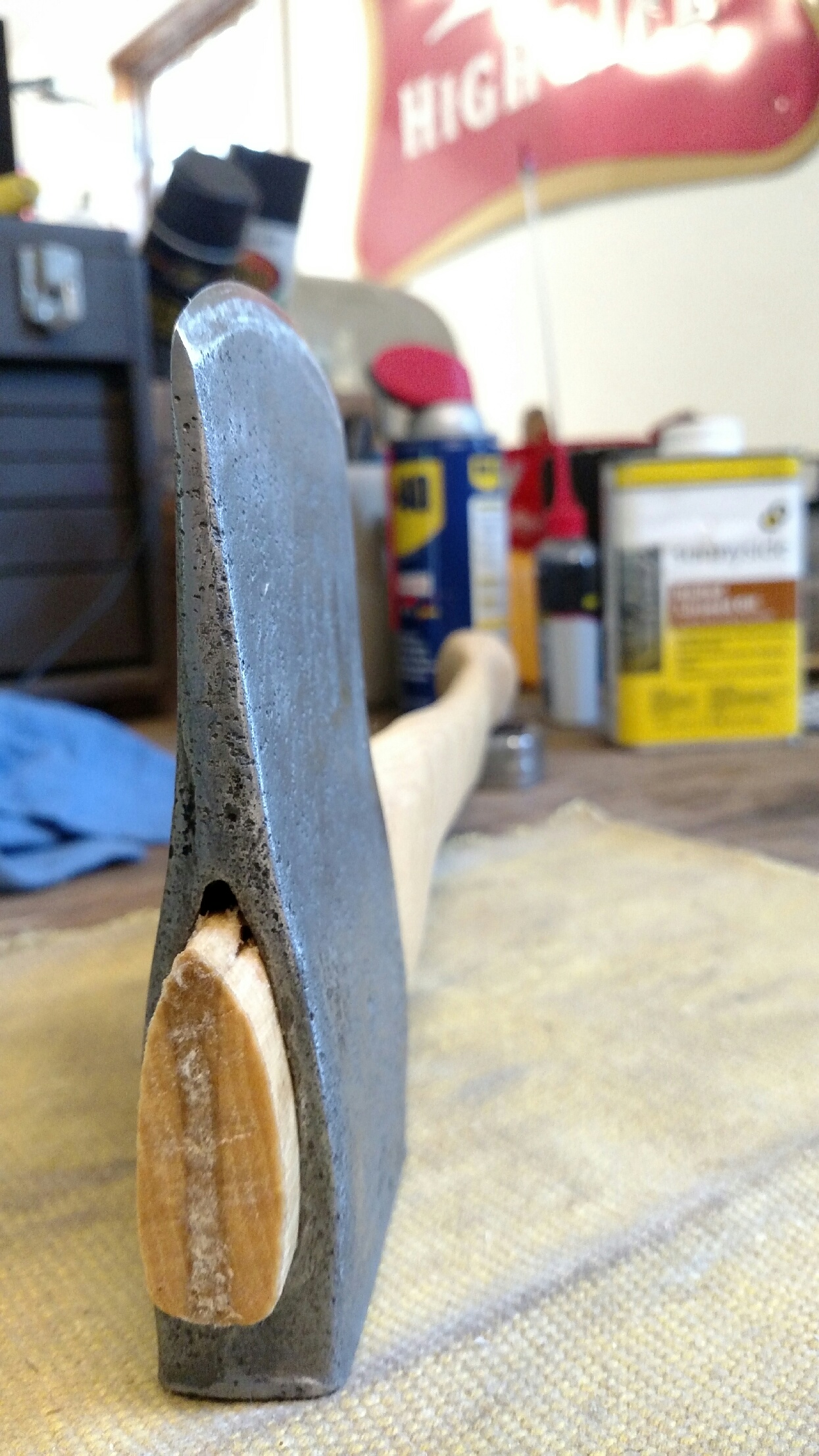

Thanks for sharing! The space there could be filled with another shaped piece of wedge material or even a small piece of hickory - just to keep the elements out.

Thanks AgentH
I wasn't quite sure how to remedy that, I have read from a few posts exactly what you suggest and think that's what I will attempt from a broken hickory maul handle I have been saving.

I can appreciate that a wedge is often not tall enough to fully fill the vertical kerf and that achieving a full length fit may require a second piece of wedge. There is lots of support at the eye sides of tear shapes but the tight turns at both the top and bottom are tough to fill. Sometimes I think the Europeans have it right when they manufacture D shaped eyes so that there's fully positive contact at the top of the eye by virtue of being able to shape a haft much more precisely.
Thank you 300
I look forward to trying my hand at filling that gap with a nice piece out of an older broken hickory handle. In hindsight using a longer wedge, even with a little shaping, would possibly have filled that narrow gap nicely. Got me thinking, I love it!

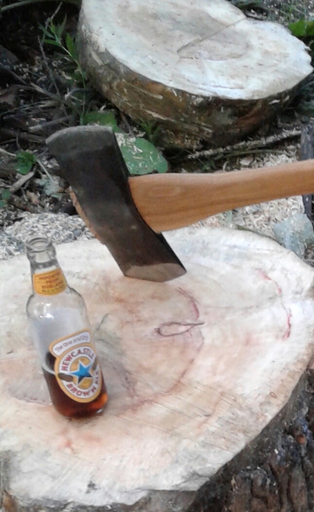

My 2nd hang.
It's not perfect but it's strong.
It feels great, weight and balance.
Kelly Registered 3lb. 28" Hickory, thinned & shaved, off the shelf Link handle...
Thanks for looking

Looks good but woud look great with some file work, maybe a half banana grind.
I like the idea, and will need to do a little reading on the banana grind . I can assume what it is, shape/contour of sharpened & polished bit, heel to toe.
I agree it would probably look better, though I do also like the look she has now, her badge as a user then stuck in a drawer till I found her. (I am just happy I didn't soak her in vinegar)
