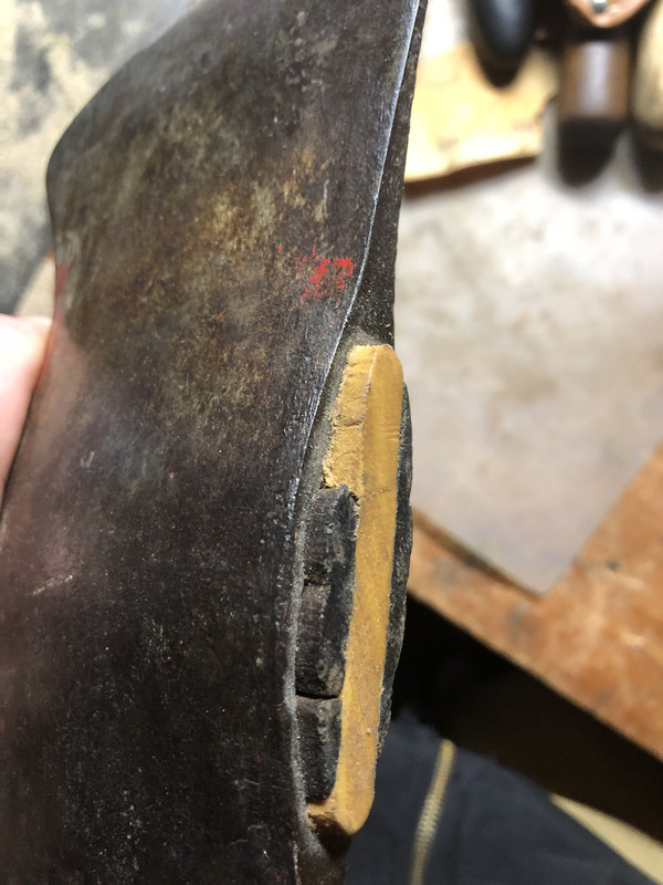

Thank you guys! I appreciate the kind words. I've had good results using paper birch for wedges. A bit harder than poplar but soft enough to fill gaps at the ends. Here's the other side. A better curl!Very nice!
I like the wedge curls there.
I'm not sure what you mean? You cut the curls off before driving it further??I don't know it it's the right way but I try for this on my wedges. The ones that start like this seem to hold well. I like to knock, follow with my knife, knock, and repeat.
