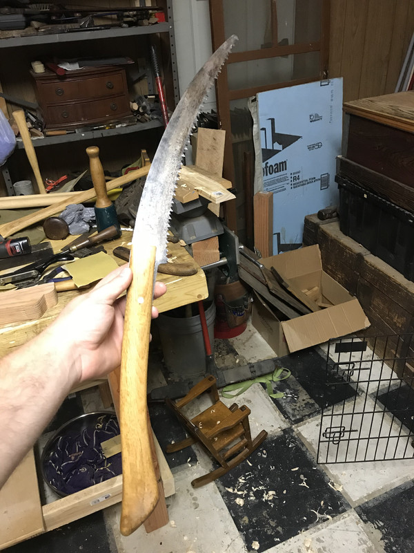

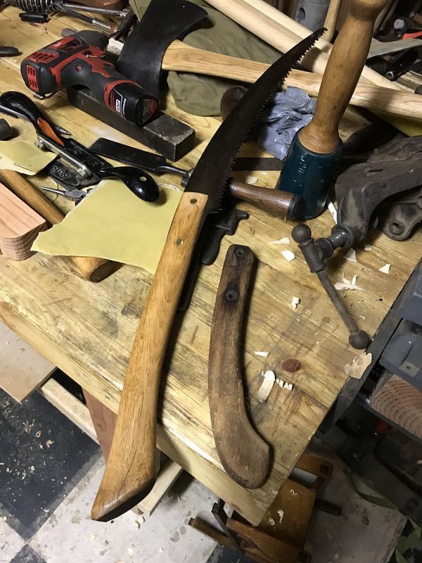

This followed me home the other day. It is not an axe but I did hang it! I had a handle from a Plumb Connie that was cracked but I saved the bottom because it just had a perfect palm swell. So I used it to handle this pull saw. Honestly whoever had this before me knew what they were doing. It feels like it was literally just sharpened and the teeth have such a wide set. It tore through some seasoned walnut I had with ease!!
I used some brass rivers instead of the nuts and bolts they had when I got it. I think it turned out good!
I have few old handles around that can’t be rehung, but I also couldnt bring myself to get rid of either. Great idea for a way to reuse a nice old piece of hickory!
I like that! Looks like an old Corona saw.

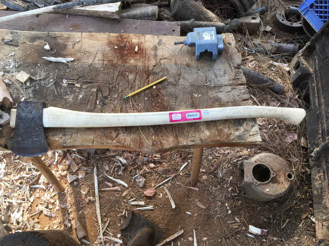

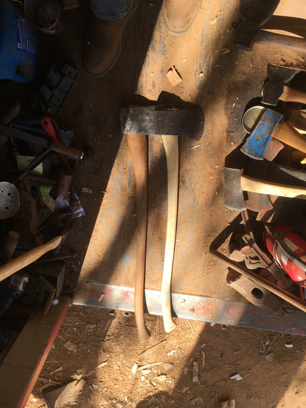

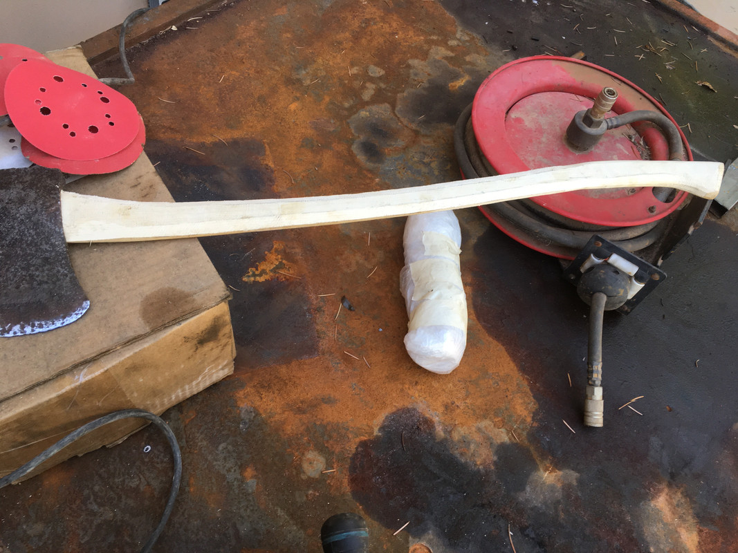

I put the head on the handle on the third then sorta lost interest until yesterday. I looked at it and decided the head was too light to be on a 36 inch handle. The eye was kinda small anyway so I figured I would drop the head down to the line as shown below. I forgot to take progress pics but I ended up doing that and taking 3/16 to 1/4 of an inch off each side of the handle and 3/8 from the top part of the handle about like the lines show. 6 hours later this emerged. I'm looking forward to trying it out. Despite the bad omen that "Dare to be Stupid" was playing when I started work on it, it turned out ok. I used the handle on the axe in the last pic as a template. I'm not sure why the handles appear to be tapering in width in the last pic.

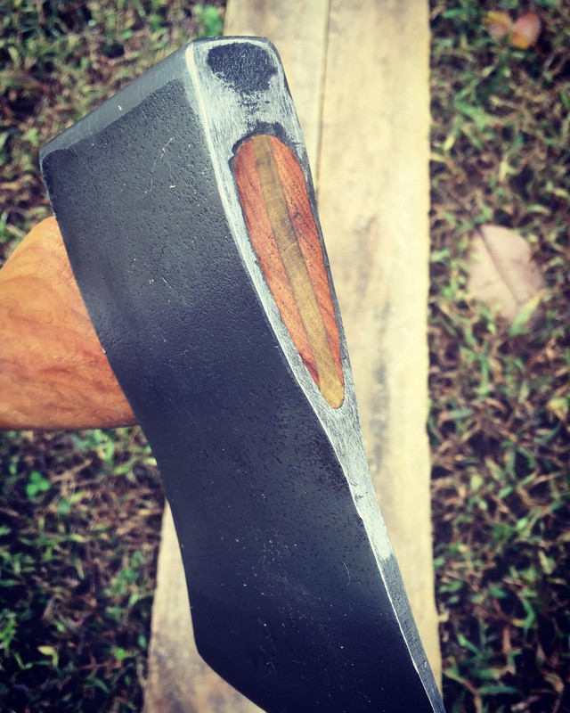

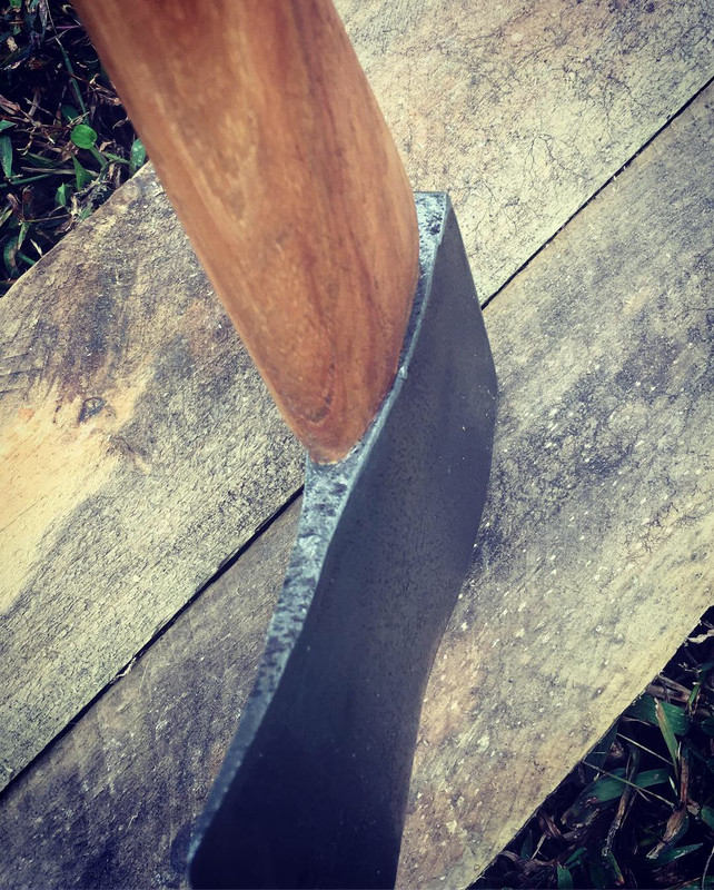

Hey fellow axeaholics! Hung another one. Bought it from €+$y. Price was okay and its a nice axe. Its fun spending a long time on these and gettin em super sharp and ready! Another haft with horrible grain orientation though...

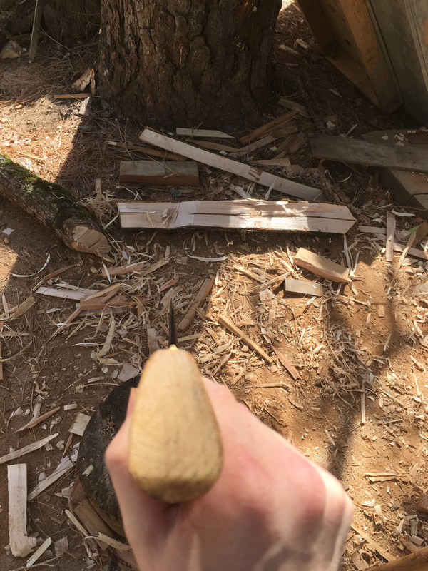

You can see a pretty good size poplar in the background. Got hung up and I've been having fun chopping the living daylights out of it!
Told ya it was awful grain...
I didn't fell this tree using this axe . just cleaned up the tall stump with it. Have a good one!
It looks better on that slimmer handle.
