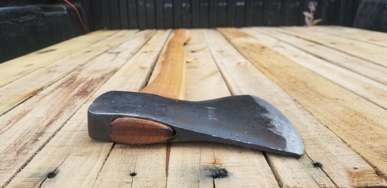

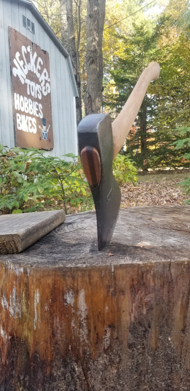

What did you rehang today?

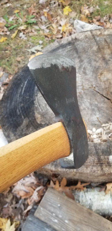

That's a classic Craftsman color from the 50's-60's. Probably a Vaughan-made broad hatchet. It's in great shape.
That's good to know about the color. I've got two craftsman single bits that are that green color. It reminds me of my father's thermos he brought to work when i was a kid. I know it was a different green but it always reminds of that anyhow.
That is a beautiful broad hatchet!
Oh it's absolutely a Vaughan.
When you see M in the stamp like that ( not a random M on the back...ect ) then it's the OEM code sears used for Vaughan & Bushnell MFG.

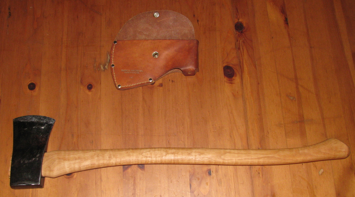

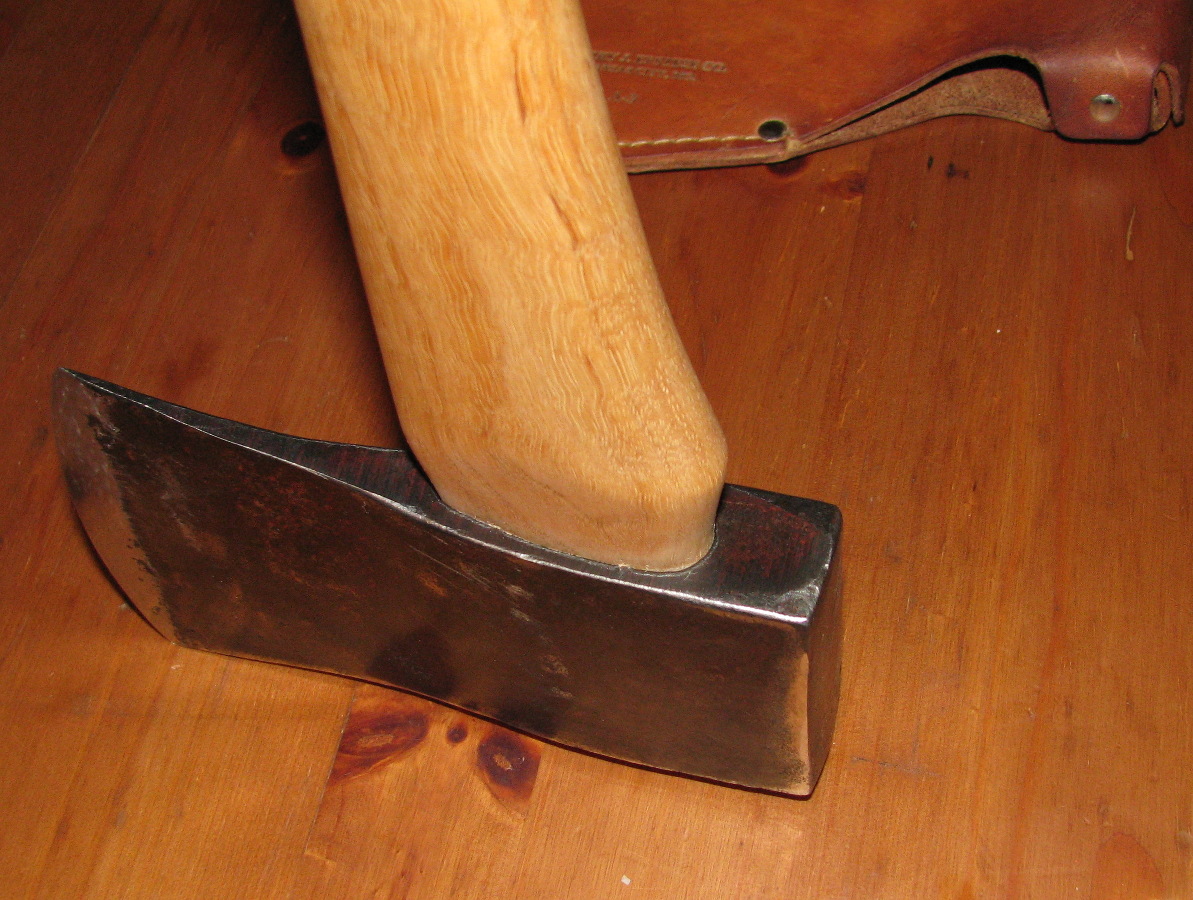

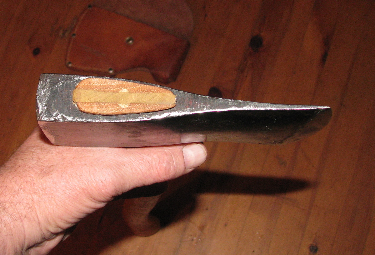

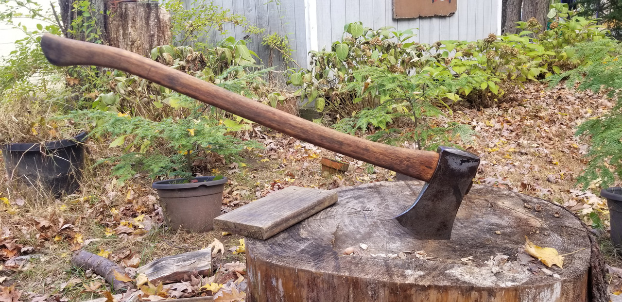

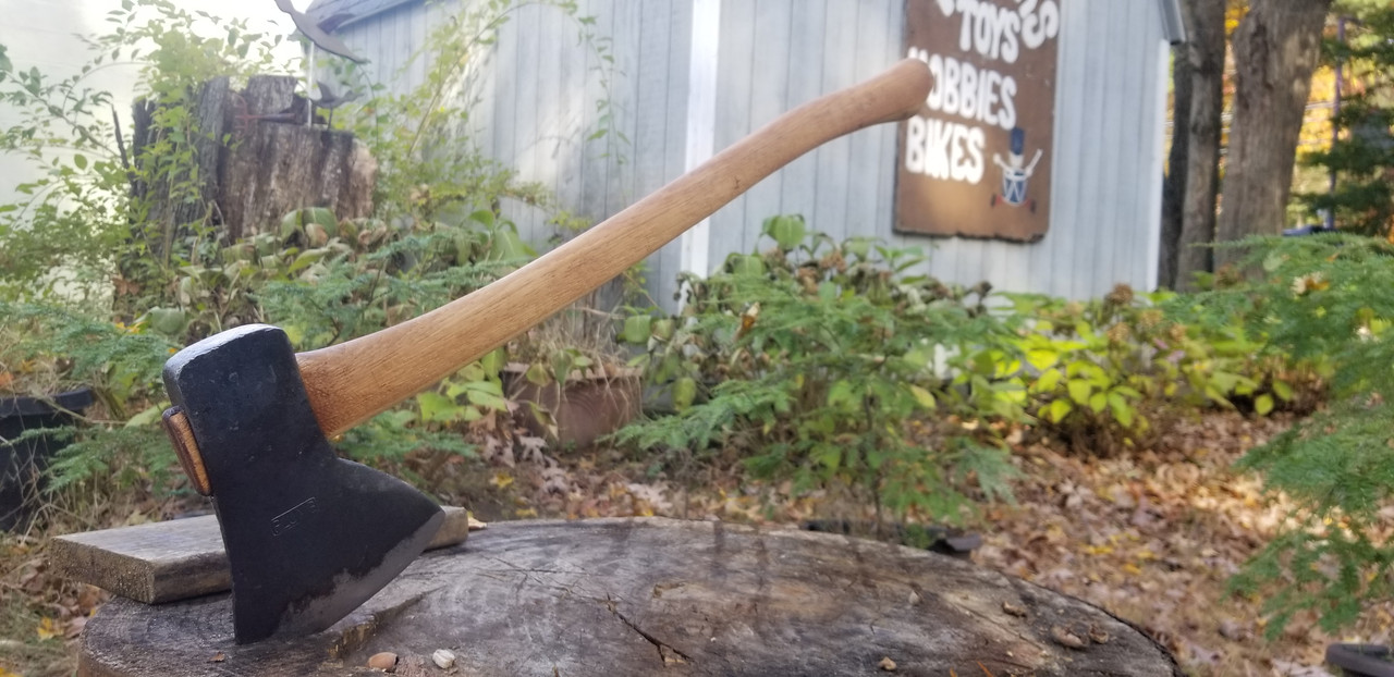

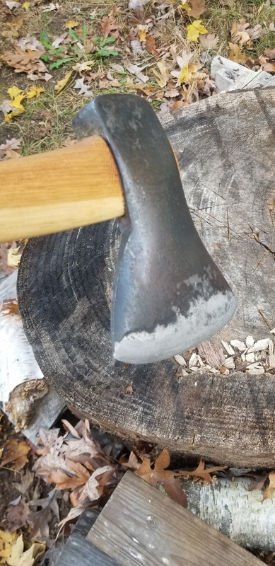

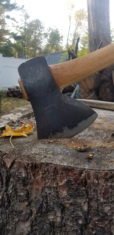

I managed a couple today. Neither came to me with a handle but these two handles I have had and waiting for the right heads.
This ones a keeper for sure...
Plumb Cedar
3 3/4 lbs.
26" Haft
Walnut Wedge (thank you Brian Rust)

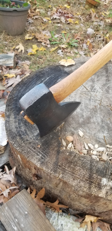

This one is for a friend that wanted an axe to chop away at stumps...yes stumps. Said he wanted an axe. So here is his axe.
4 1/4 lbs.
32"
Poplar(?) wedges

Two beautiful hangs and one gorgeous plumb! Holy moses that thing is NICE! Unique. Don't see many in that pattern. At least i don't! It's nice to hang an axe for someone. Well done!!!

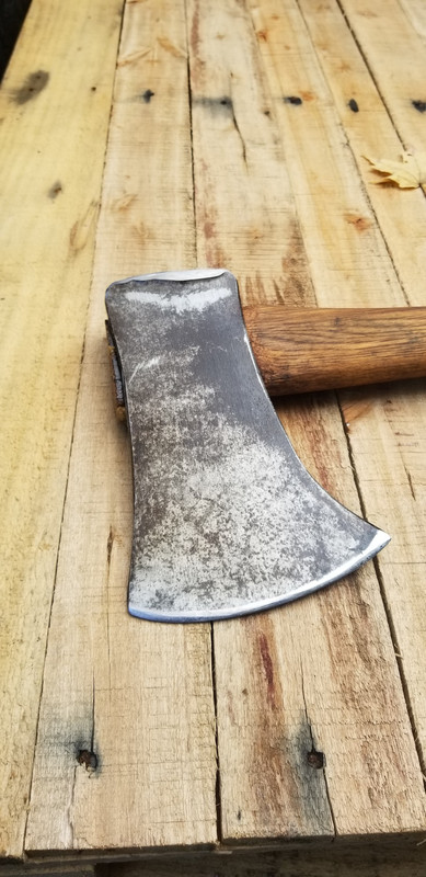

Some nice work. Today I cleaned up and hung an axe head that I can't seem to find anything about - I obviously searched, but came up with zip. Does anybody know of, or have ever heard of a Les Casey?

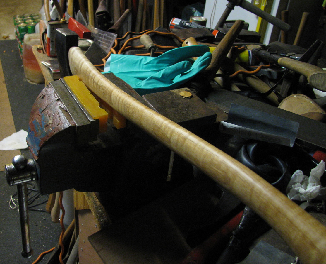

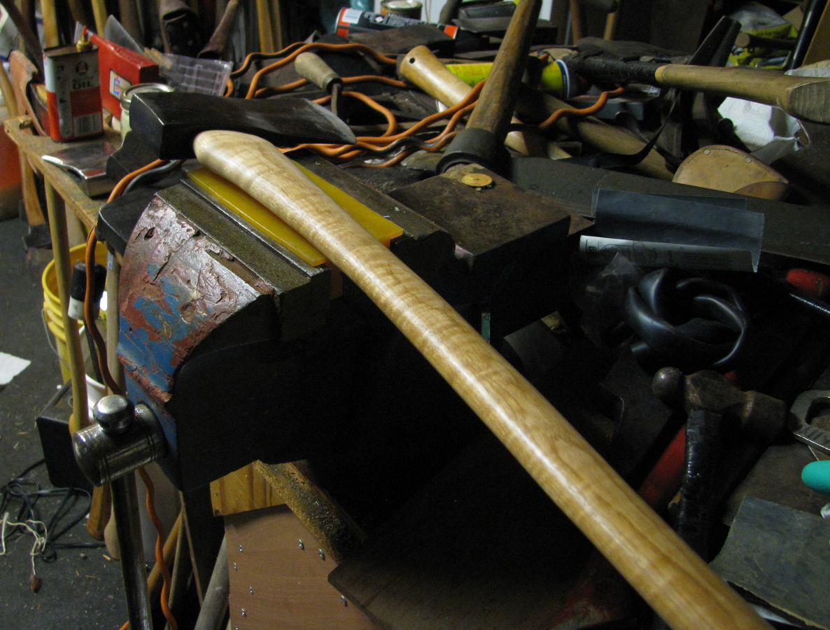

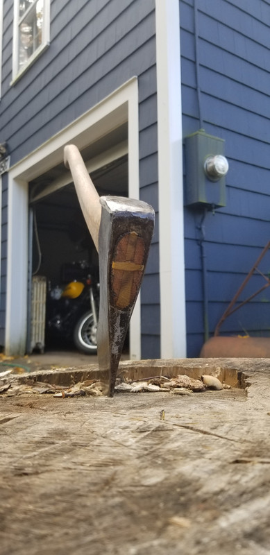

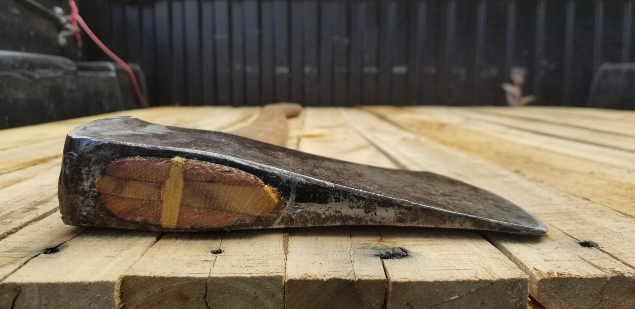

I finished this one Thursday night. I showed the head before in the 'What did you re-sharpen' thread. 1960's Woodslasher boys axe.
4 eye ridges.
This is a really nice Do-It Center handle that I'm guessing was made by Link/Seymour, maybe out of the Sesquatchie plant. At any rate it came in hanging shape, nice and slim, straight-grained, decent swell, almost perfectly shaped eye. I used the stock poplar wedge with some DPG and then coated it with tung. Mostly all I did was refinish it with BLO and tung. It shows a decent amount of curliness.
Photo came out blurry but it's perfect grain from end to end. I saw another really fine boys axe handle at Do-It Center last week. It didn't have the curliness but was otherwise as fine as this one.
