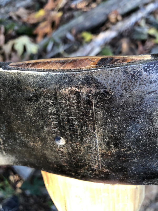

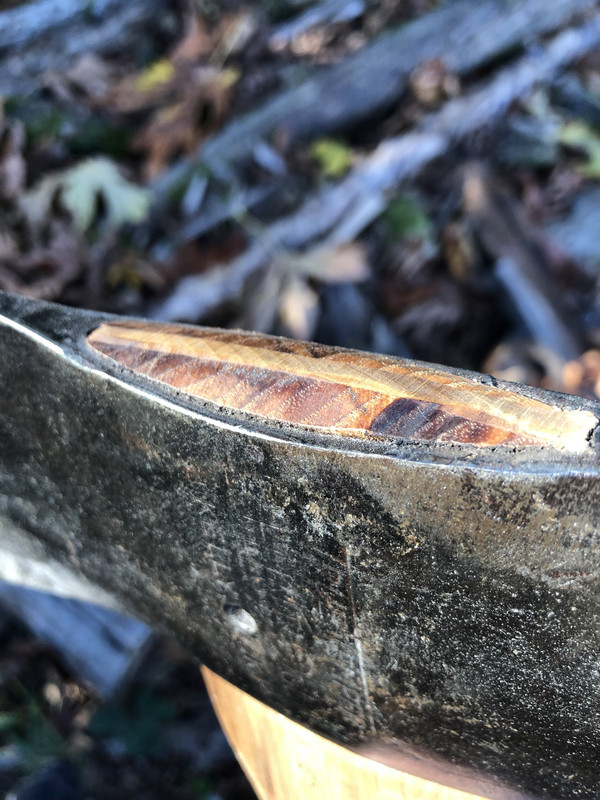

While i do get the lip that gets created when leaving the eye proud does kind of hook the head on at the same time i feel that any outward pressure that isn't inside the eye is wasted.
It's not wasted. It's in addition to the tight fit created throughout the eye. More is better.

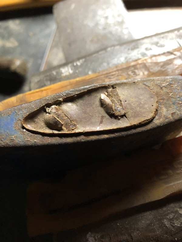

I can honestly say that the factory hang that seems to stand the test of time is the Plumb perma bond. I don't recall finding an example that had a loose head. I found one last summer at an estate sale that was leaning against the side of a shed. A very weathered haft with no sign of ever being red and badly warped. I don't know how many years it had been there but when I picked it up there was the Perma bond and a still tight haft. Those hangs are short of filling the eye to leave room for the epoxy. Maybe we should all being cutting our hafts off short and sealing it up with perma bond?
Not even epoxy can deter steel wedges ;)
