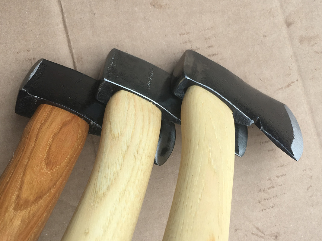

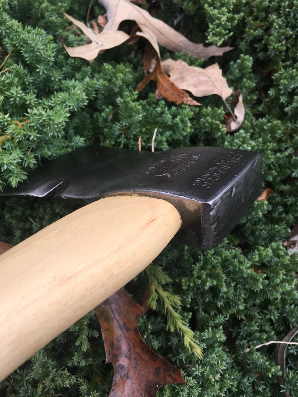

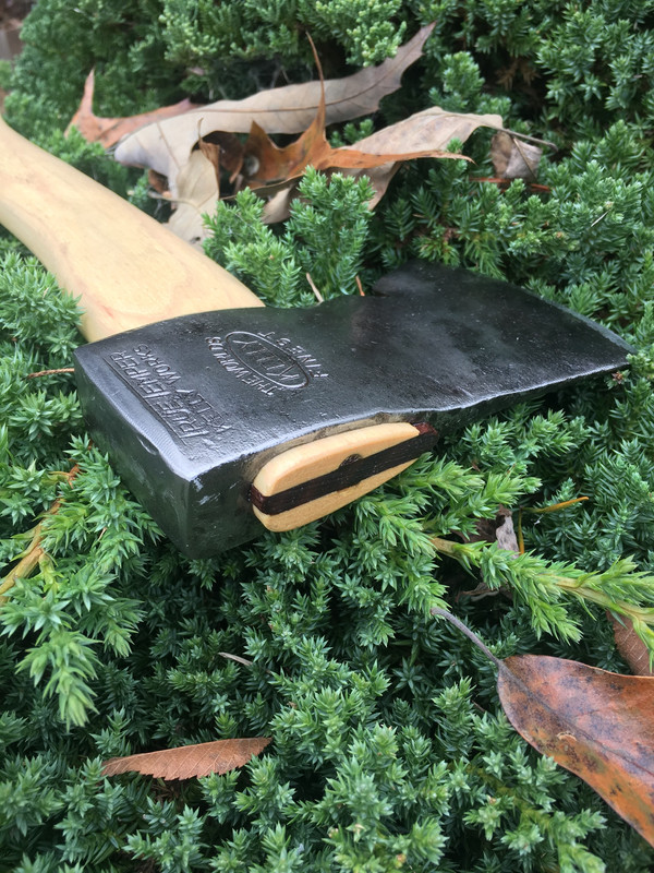

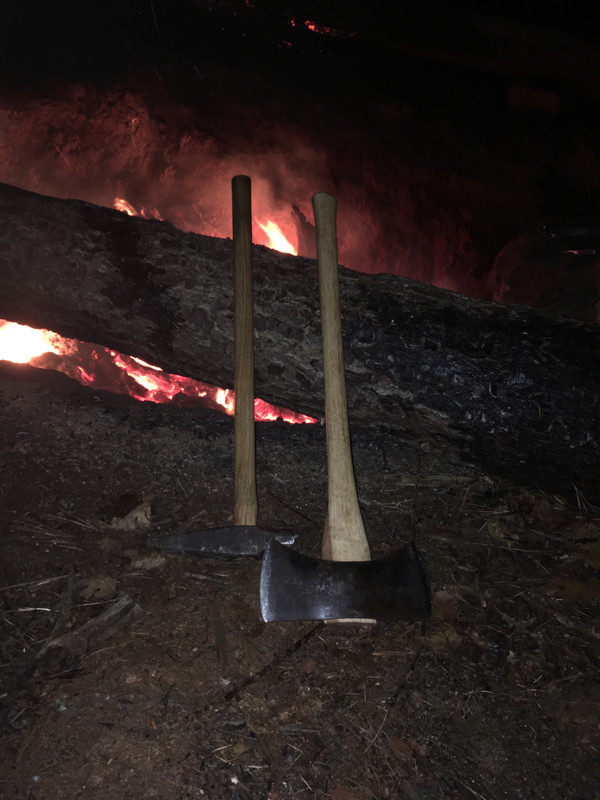

Moonw- For hewing I like the New Orleans just a little bit better than the Penn. and a lot better than the Canadian pattern. The balance is just right for me. Most New Orleans broad axes I have used have a slight curve from poll to bit and a slight curve from toe to heel. Remember, each maker does things a little different, so there is some variation in this. These curves, on the so called flat side, make the bevel side a very slight gouge shape that helps with the hewing. For a demonstration of hewing see the US Forest Service video "These Old Cabin Logs"
Thank you! I did watch the video but I'll rewatch it - should make more sense now, a few years later.
Most of the better made Penn. pattern heads have that curve. Some of them even have the poll to bit curve on the flat side. Does not look like yours has a makers mark left, but I am thinking it is a good one and should hew well after all your clean up and sharpening work. It looks like it was not abused, just neglected. Let us see photos after you start running it.
I sure will! This particular one also has the curve from poll to bit.
I was able to get a photo of that. The other curve i can't get the camera to focus! This one came out pretty good.
So these features make it a good one? It sure seems like it was made well. I really can't wait to use it. Unfortunately it's 11° at the moment. That will abate next week so maybe I'll have a chance to do it then. I appreciate the advice and info very much! Thank you!

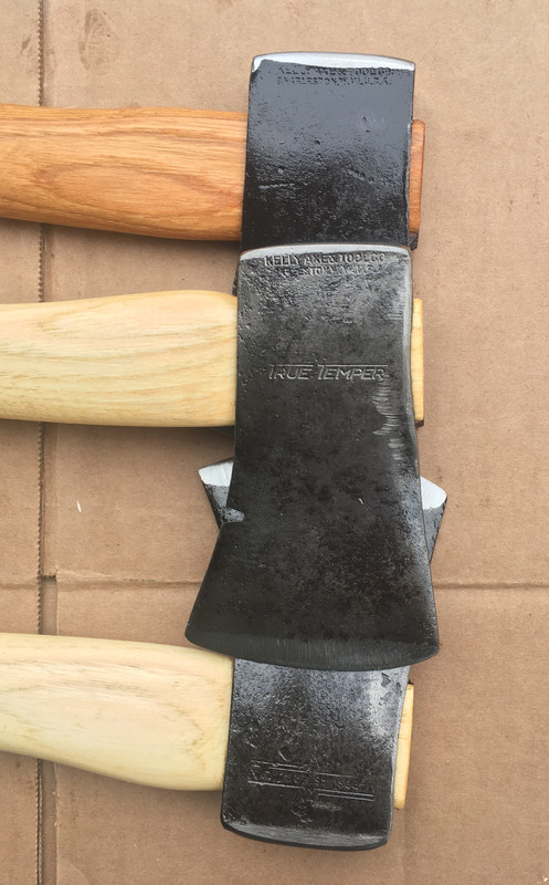

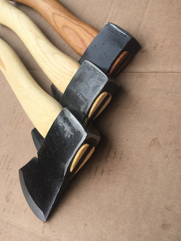

This is a cleaned and refinished army hatchet on original handle, I assume made by American Axe & Tool. The other is a 2.5lb Snow & Nealley on a 20" handle. Kind of a house axe in spirit. I'd prefer the handle to be thinner, but I left it. I'll let the future owner do it if they like. Both have locust wedges and standard BLO/turp treatment.
