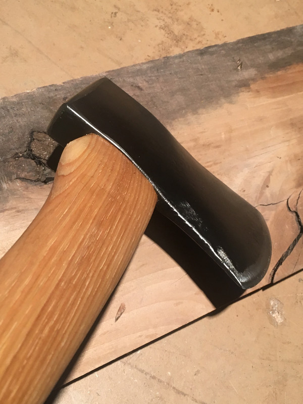

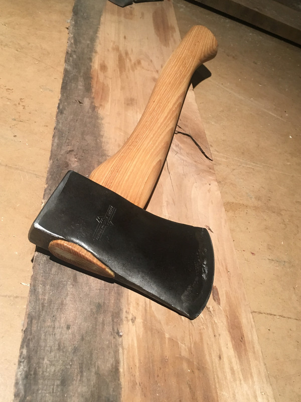

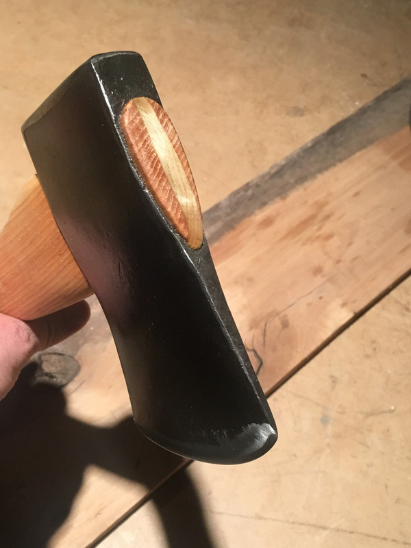

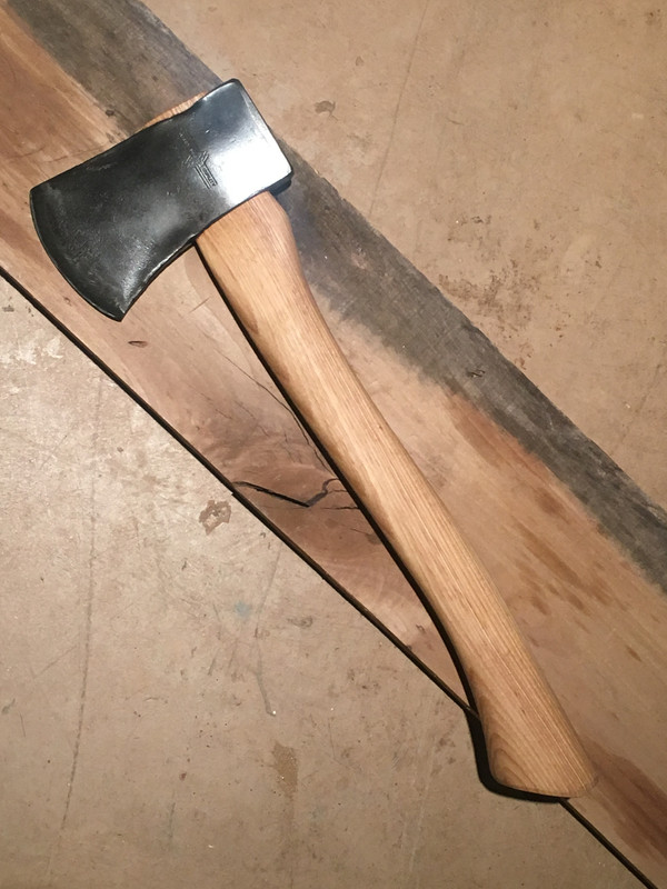

Sorry for the delay, Moonw. Things have been very busy. I live off the grid up in the Yukon and this time of year is very dark. No internet at home either so I snapped these axe photos on my lunch break at work. The first photo is the birch staves freshly harvested. The handle is 24" long, carved with an axe, drawknife, spoke shave and pocket knife. Turned out a little lumpy where the grain curled. I will need some more practice carving there.The wedge is spruce I had gleaned from my kindling and whittled down. I wanted to do this one with no power tools whatsoever. Well I guess I used a chainsaw to fell the birch but everything afterwards was machine free. Maybe my next batch of staves. This one has seen some use already and I plan on I think being my main trap line axe this year. After using it, I picked up my Gransfors SFA and it feels like and unwieldy club compared to this axe. Time will tell as to how birch will hold up but the photo from the top of the eye shows how tightly the grain is packed.

Thank you, I appreciate all the details (especially since posting it involves more effort on your part than for us living in more "domesticated" parts of the world). You've done a fine work with that handle.
