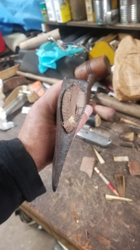

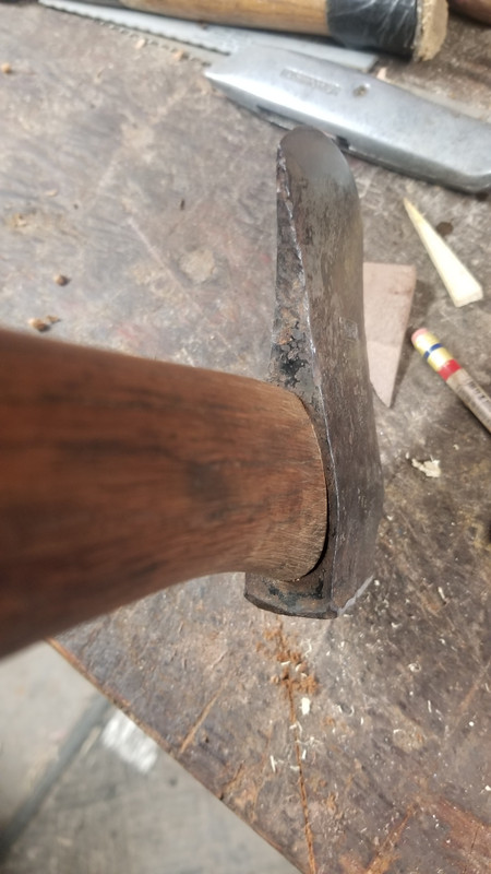

Bad mushrooming
The eye is pushed out from excessive hammering I am assuming

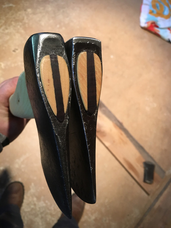

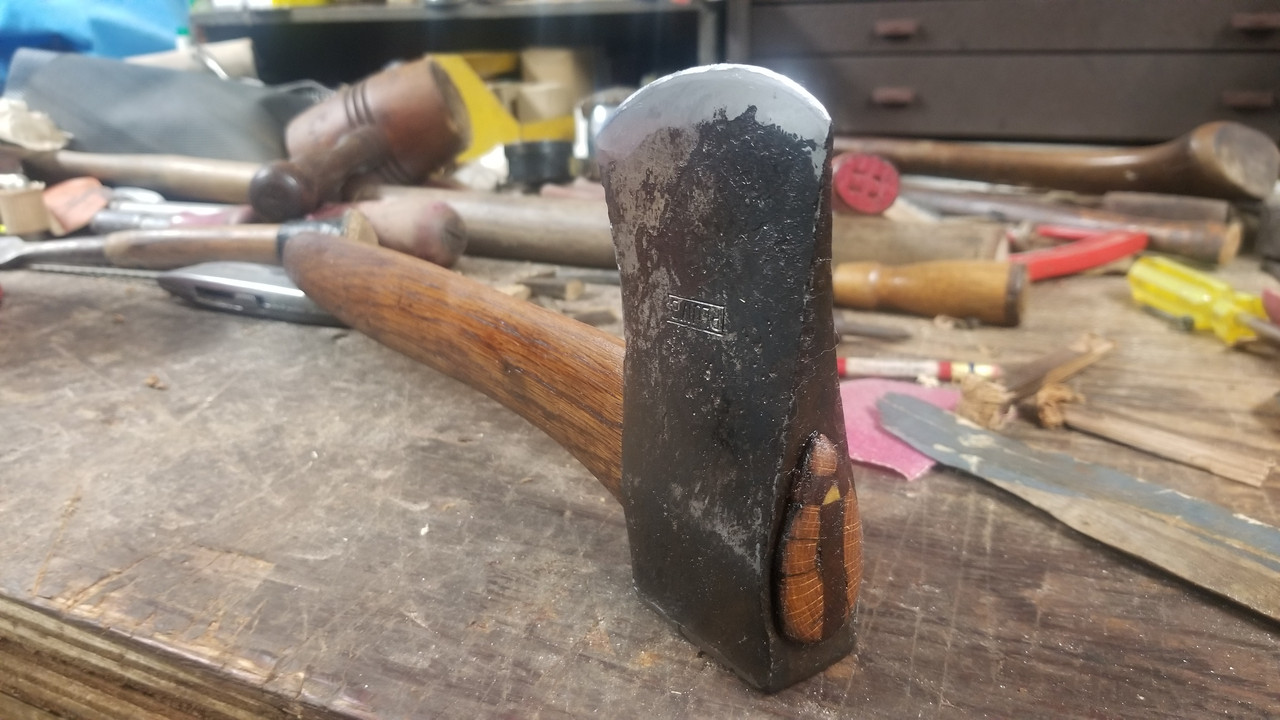

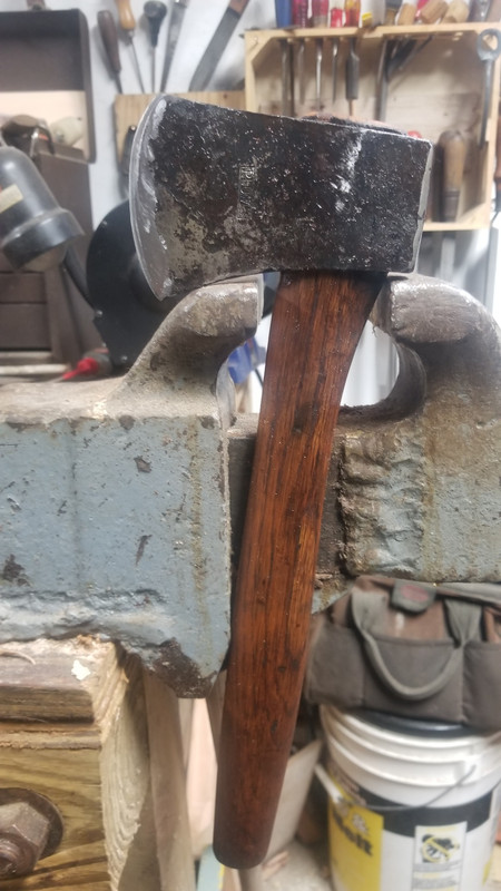

Rehung, walnut and hardware replacement wedges

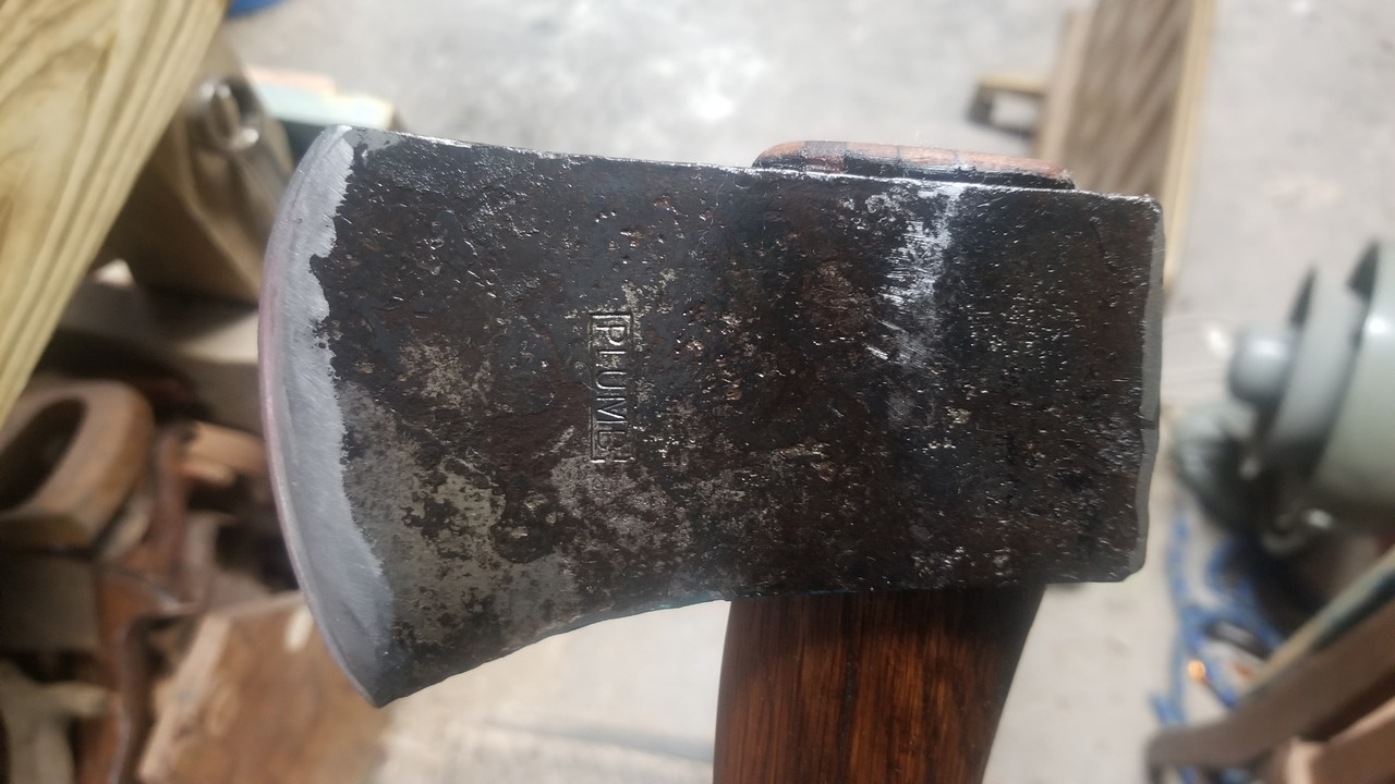

PLUMB
14" @ 1 1/2lbs
I'm about to try that with a Connie I got from JB off eBay. Worst happens I chip it, or resort to the belts to zip it off. If anyone has any tips on how much heat and force etc it'd be appreciated!

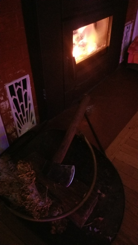

I'm really getting some mileage outta this axe. Last time I'll post it, promise. I hung it today on a less than perfect link haft. Mixed sap and heart wood and runout galore. But i bet barring an over strike it'll last a long time just the same.
Whenever you move steel at less than forging heat you're doing some damage to it. But I don't think much in this case. You're not looking to change the cross section, just push it back in shape. And recall that it more than likely deformed under no heat at all.
I've done a few of these with just a propane torch and a wet rag around the bit. Remember that whatever metal is hottest moves the most. So heat one side and beat it straight. The other side being colder will hold it's form. Then cool the first side and do the second side. If you shine up the steel a little bit and heat it until you see the first sign of a straw temper color appear than you're hot enough. You really wouldn't even need the wet rag. It's just a precaution. Even only too hot to touch will do it.

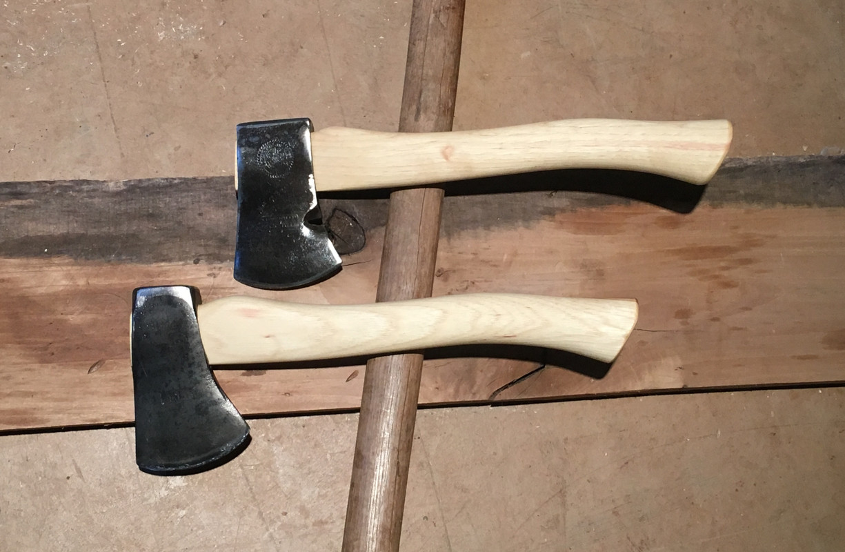

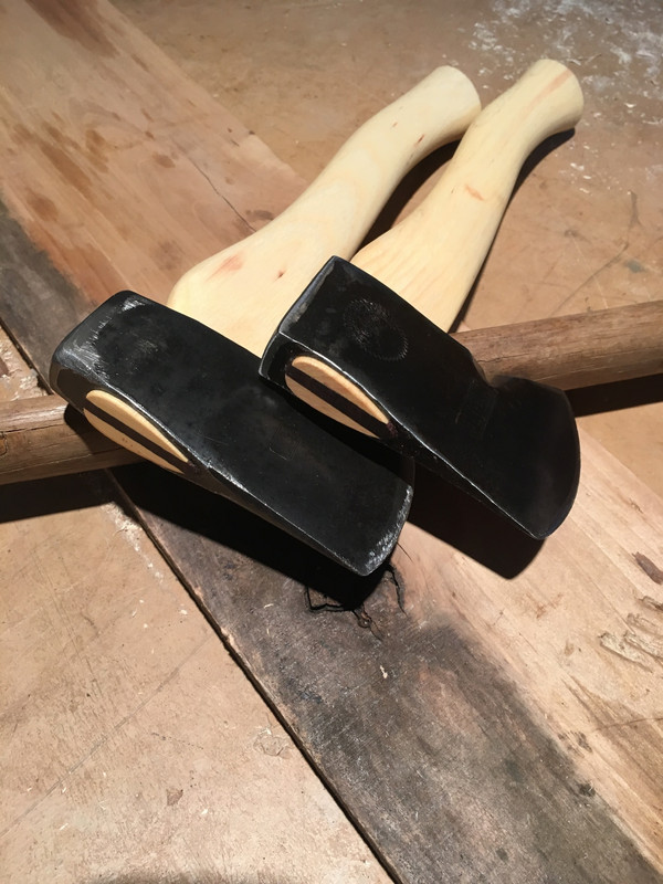

These for a good buddy that has two young boys in scouts.

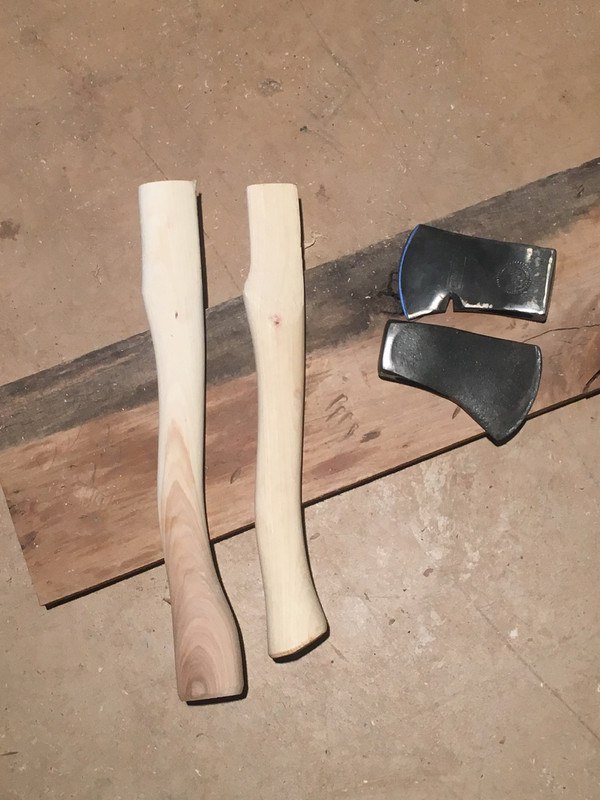

When I got to TN Hickory they didn’t have any hatchet handles complete, just blanked out like the one on the left. I took these and they sanded them for me. Can’t beat them for $2.00.
Plenty of material to make a nice swell.

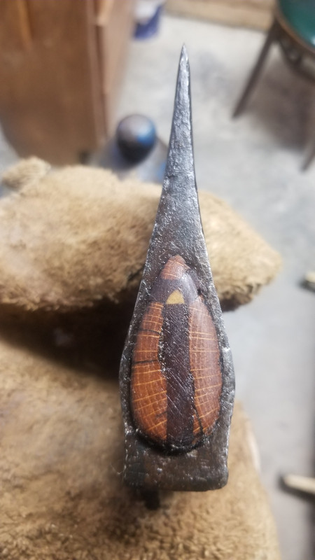

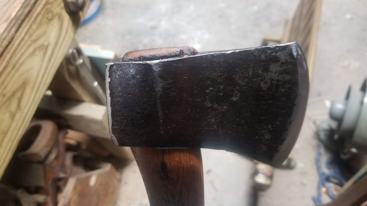

This " Sager chrmicalaxe " ( unconfirmed ) had a bit of deforming to the eye, and I carefully put it back with a 14oz ball peen hammer.
Did it cold and it's not exactly hard at the eye so it went perfectly fine, I also hammered back some mushrooming
Them Chemical axes have really soft bodies. That thing is just begging for a nice grind.:thumbsup:
