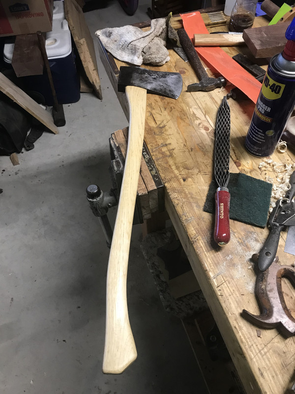

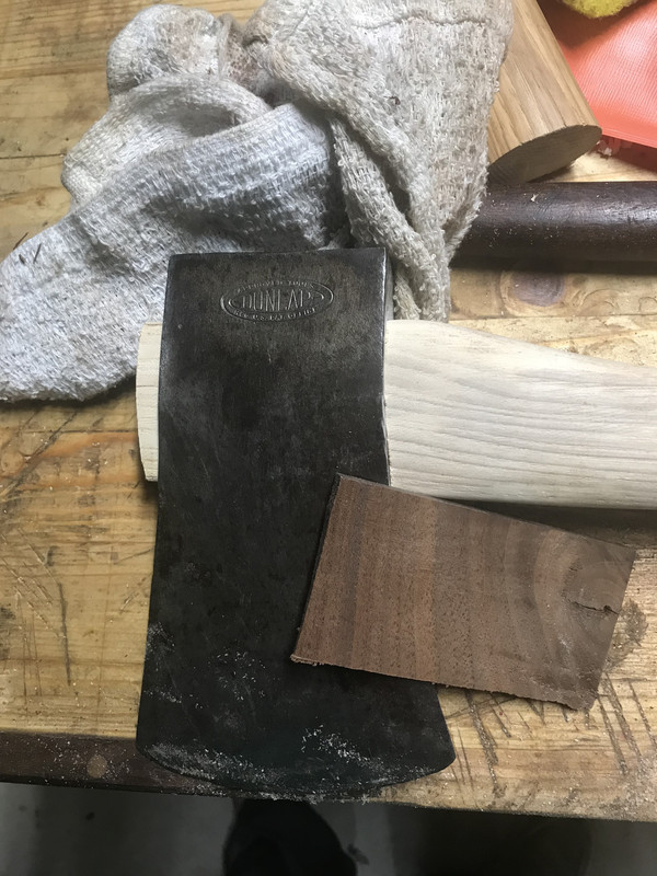

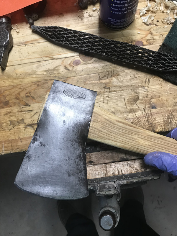

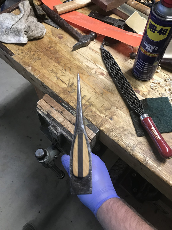

Finished this 2.25 Dunlap up tonight. Walnut is a beautiful wood and makes a great wedge. The handle has decent grain but there was some heart wood mixed in. Link has some super nice boys ax handles. Very slim with a huge swell. Grain and pure sap wood is lacking but it is much better than the fiberglass mutant someone considered a handle. I am still picking out splinters from that damn thing.
Oh by the way, this is the first time I have used the Shinto saw rasp on a handle and it was a dream. I’m not sure if they make them or not but if they also had a half round course and fine rasp it would be the only tool you would need. But the flat one does 95% of the work.
