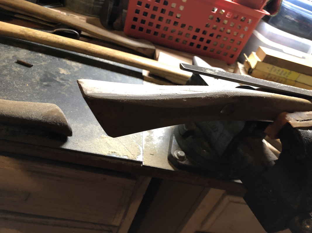

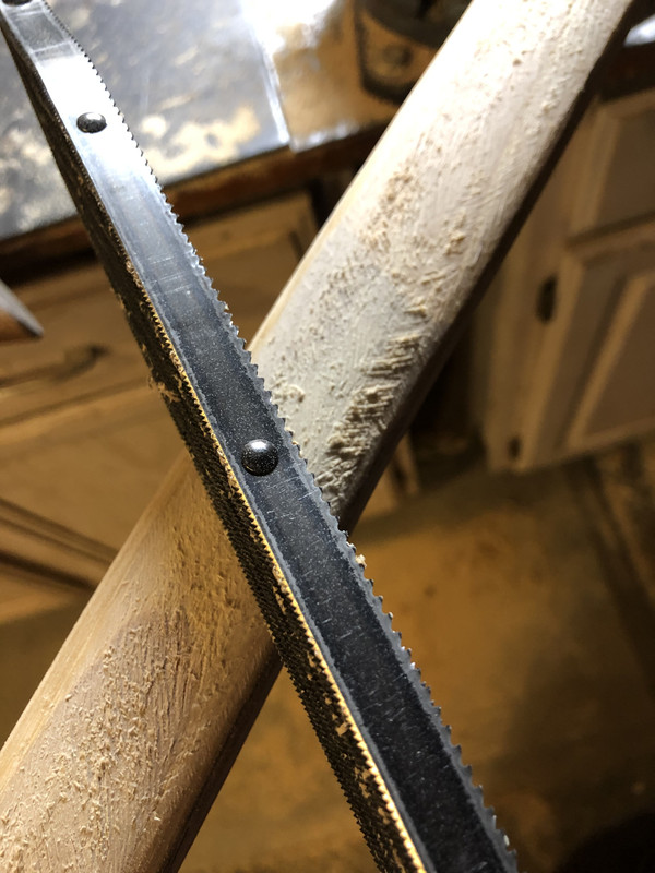

If it’s gotta be cleaned, I’m kinda liking not a high polish finish but a satin brushed look. By using 1200 Emory then directional #0000 wool. Like this..

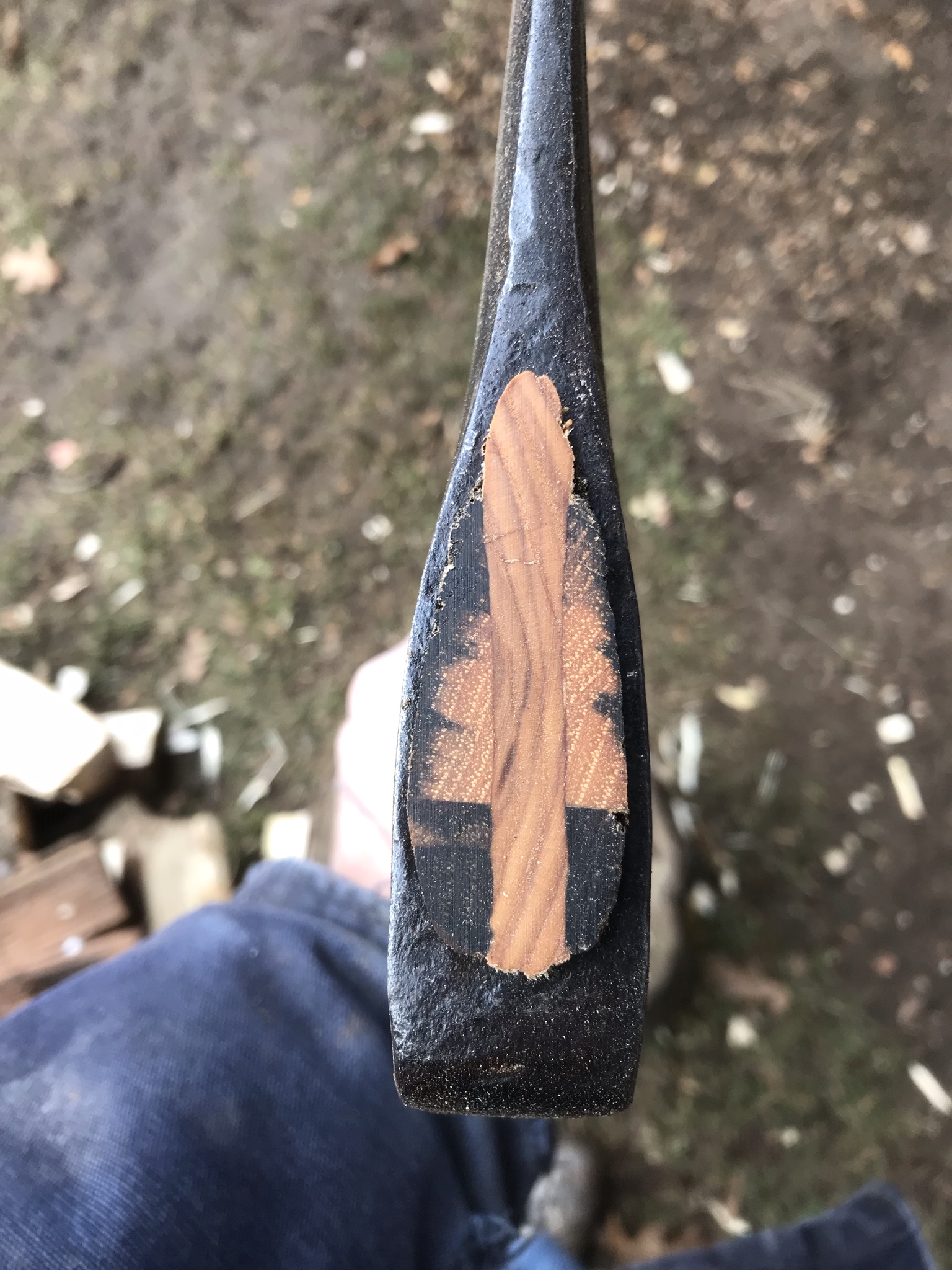

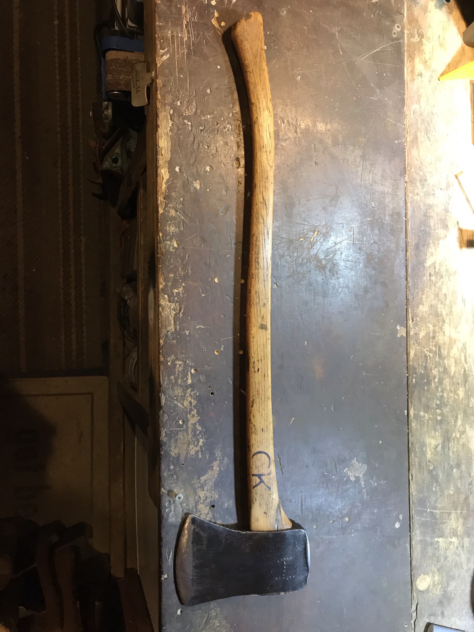

This isn't mine, but an acquaintance ordered it and after 3 hits the head was loose. Upon inspection, I saw that the handle was really too small to fill the eye and was only tight initially from the wedge. It's a very nice handle, terribly hung. I took it off and thinned the shoulder so that the head could sit lower and at least be snug on the sides. I installed a cross wedge to help fill the space front to back. Once done I put a metal wedge in just to be sure. Not my best work, but it was the best that I could do with what I had to work with. It is now rock solid and it's owner is pleased.

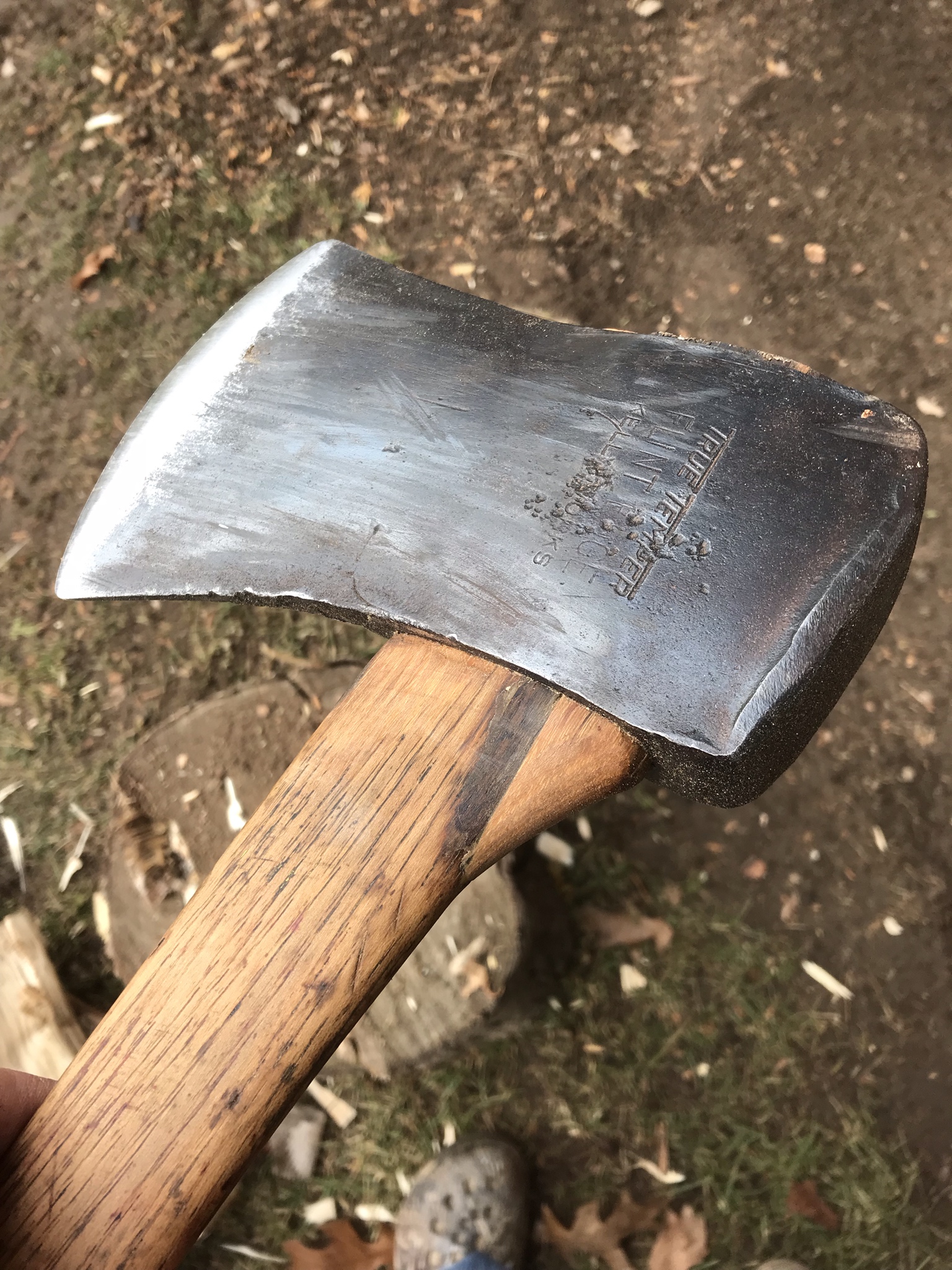

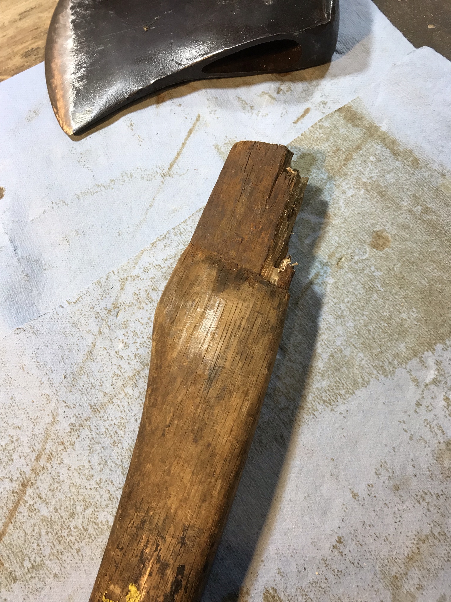

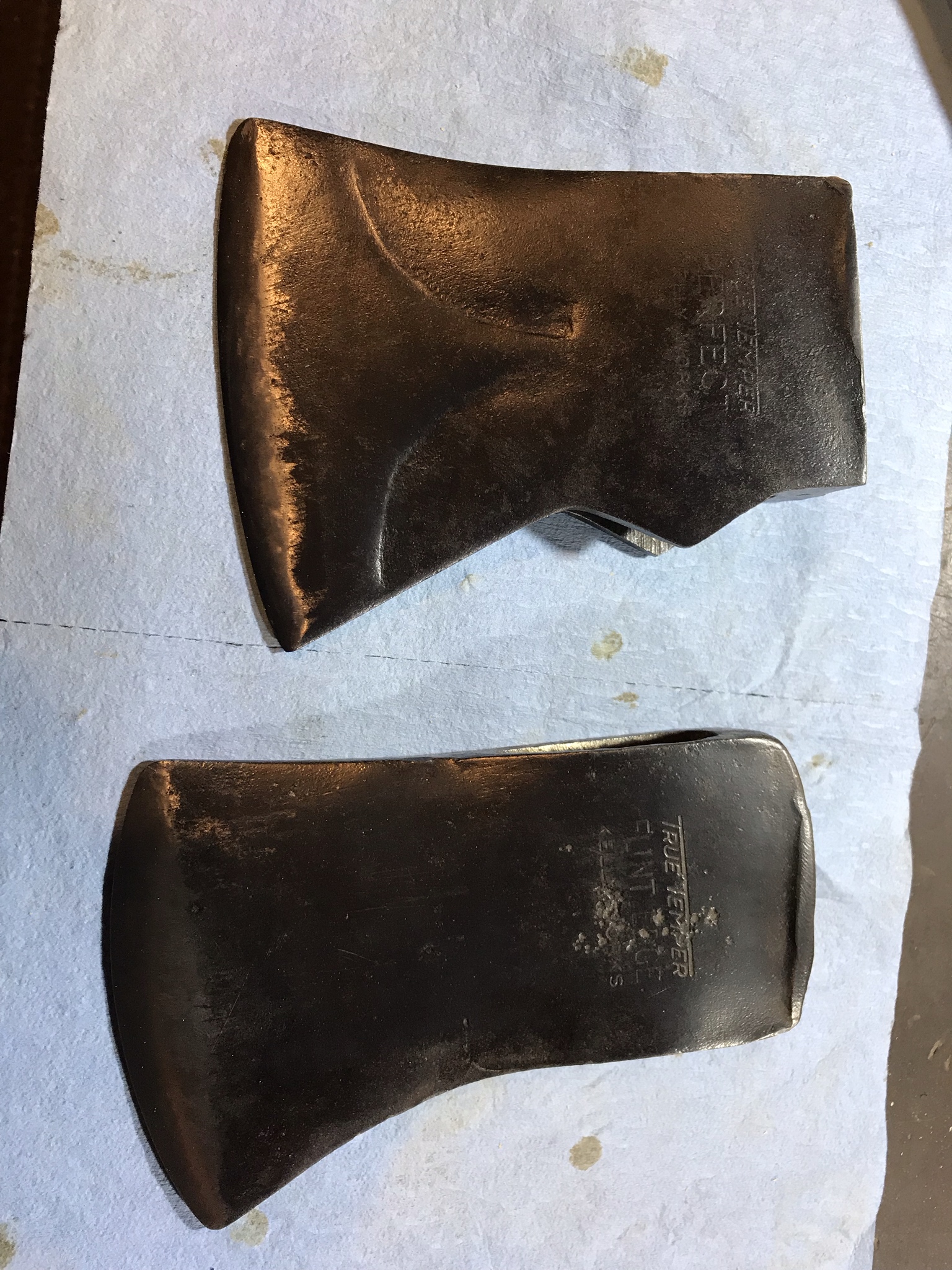

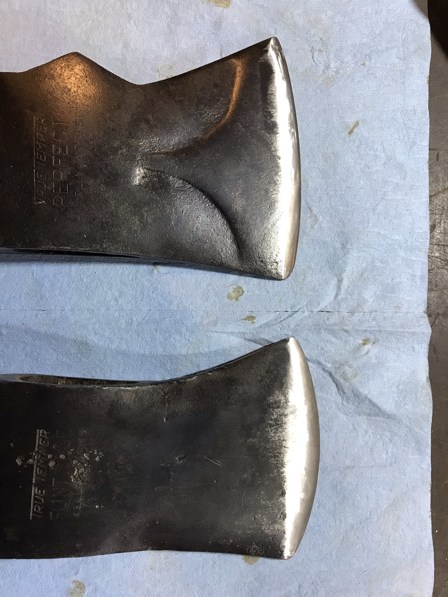

I took a chance on these two heads from the auction site a while back and finally got around to cleaning them up a bit. I left the toe and heel alone and just reprofiled the middle of the bit on the both. The Michigan is still quite round but I already removed over 1/4 from the middle of the bit.

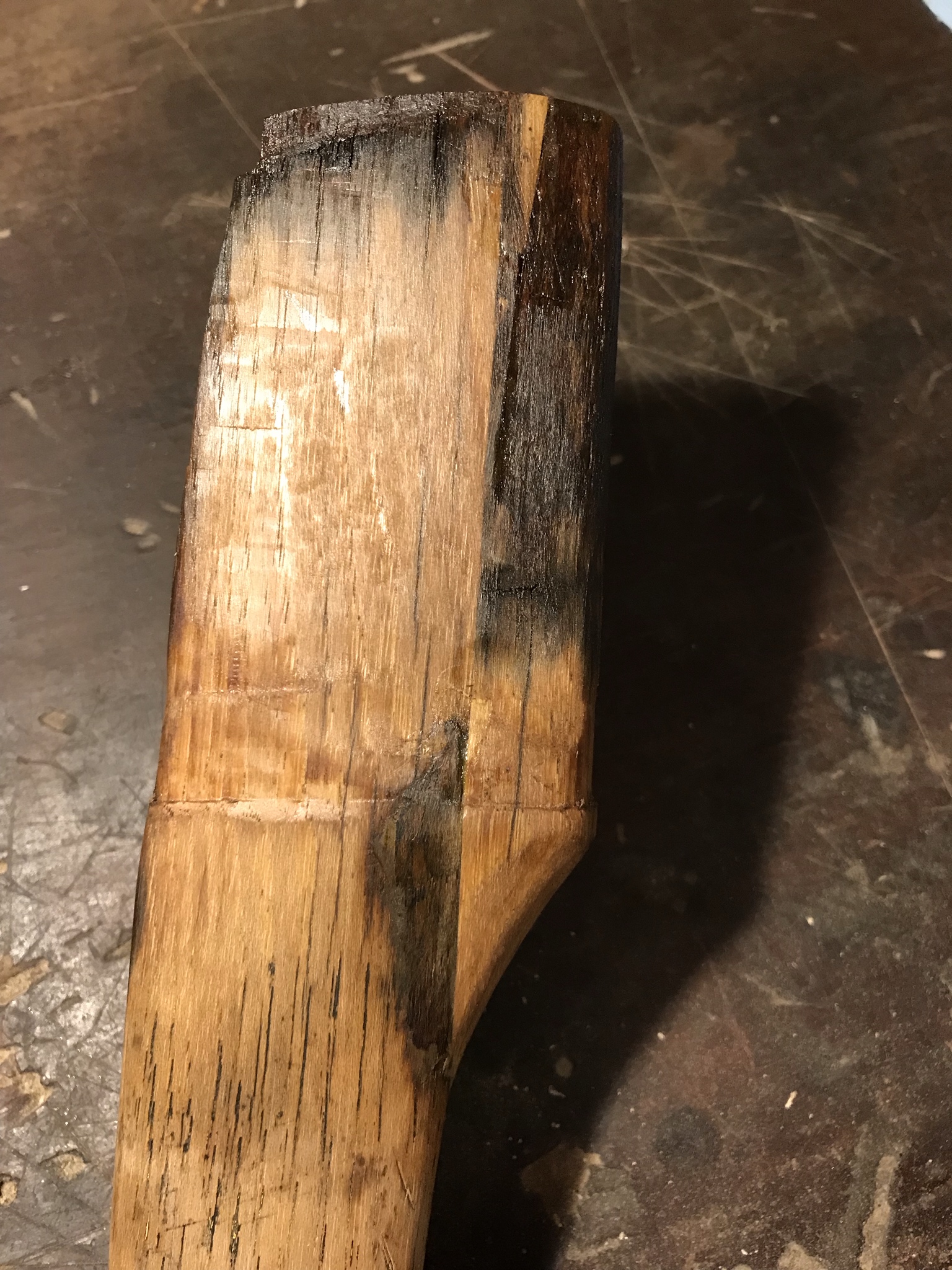

For the handle on the Michigan I was inspired by Yankee Josh and decided to try to reuse a damaged vintage handle I had laying around. I cut through the shoulder and glued it in place further down and then added a few filler pieces and sanded it all down. I did some splitting and it hasn’t failed yet, we will see how it holds up in the future.

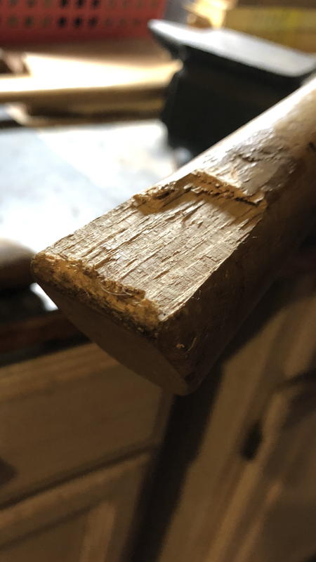

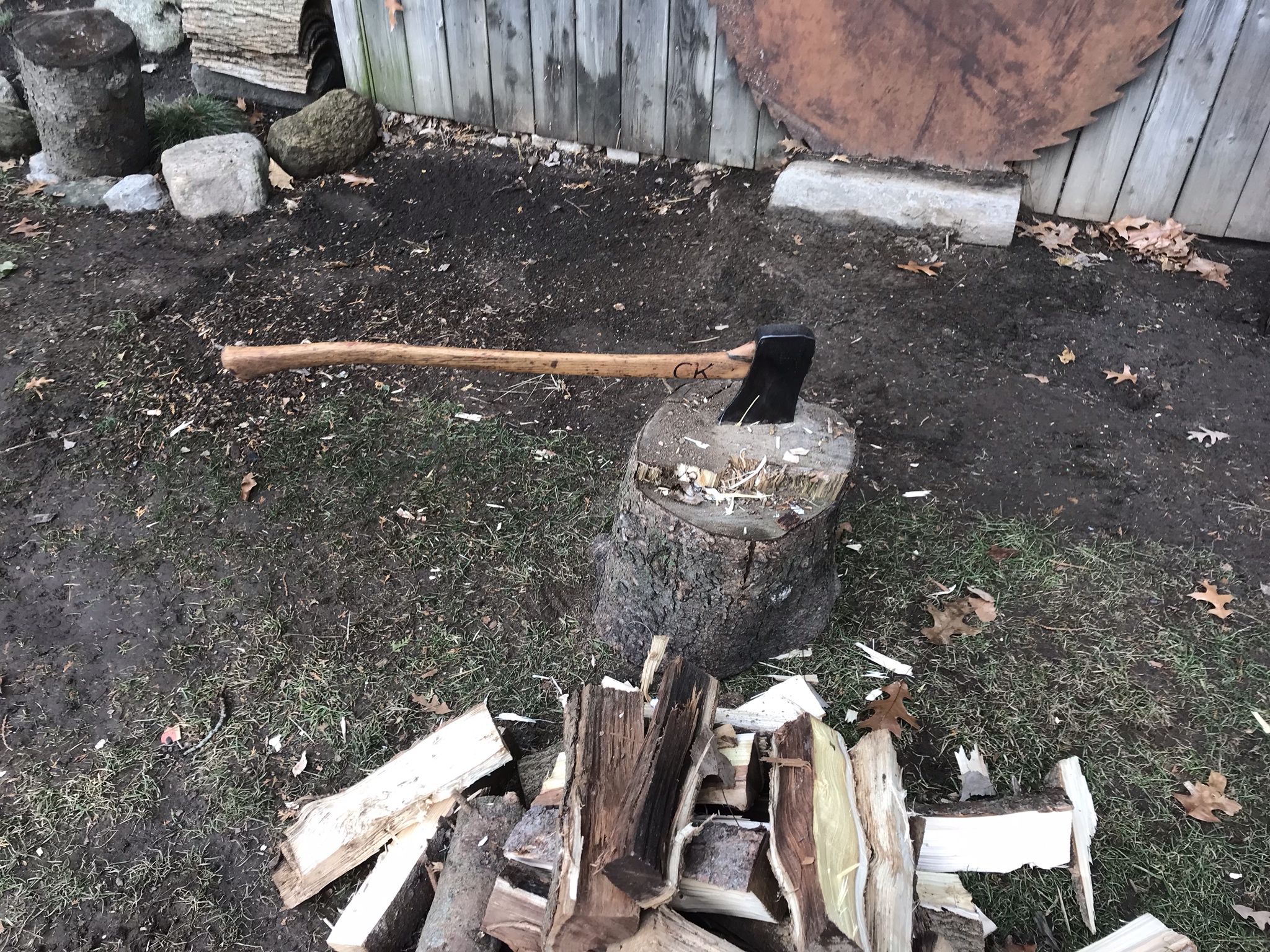

I rehung this 3J hawk on an old piece of double bit haft. The former haft shrunk too much so it became unbalanced. The last hawk pic is the new haft being tested for fitness on a fatwood stump. Also, I rehung this on a house axe haft awhile ago (That's the source for the S and N's haft, Yankee Josh Yankee Josh ) However, I just finished the haft today which is why it was only posted today and not awhile ago.
