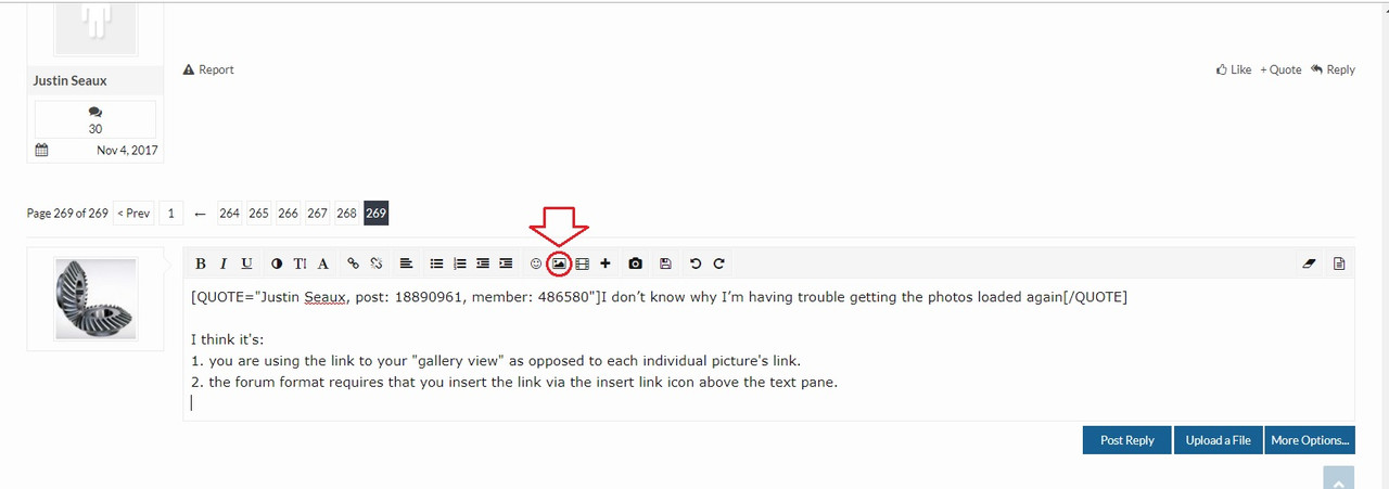

I found you have to click on the image before you drag it to your post when you use postimg. It looks like someone thinned the bit on that in the near past. Hopefully that means it was well maintained when you got it.

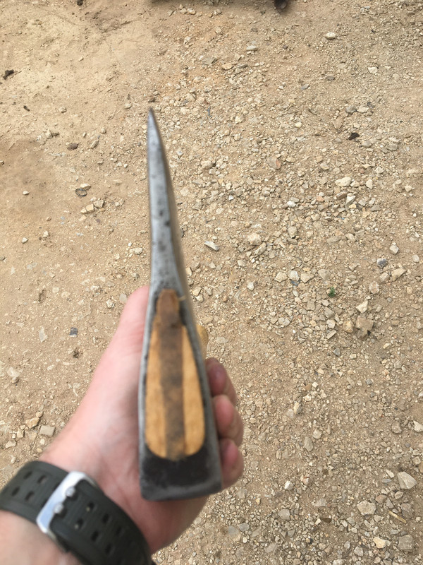

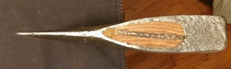

No name 4 lb splitter on a 36” straight haft. The wedge ended up being finished in a way I’ve I never done before. I decided to cut the helve flush to the top, but then the head didn’t look secure to me (it probably was), so I put two 5/8” metal wedges into the poplar wedge. I used a squared off cold chisel to drive them both in about 1/4” below top of wooden wedge (I saw that on Buckin’ Billy Ray’s You Tube channel) E755DF68-1C75-43A0-AAEA-5AF943609AE5.jpeg 999523B9-BE25-47F9-94C1-55775FF5CAEF.jpegand then sealed the whole thing with multiple layers of crazy glue. If I ever do that again (likely won’t), I’ll go get some epoxy. I’ve left the wedge proud for so long that trimming it flush looks strange. On the other hand, that head isn’t likely to come off - ever.
