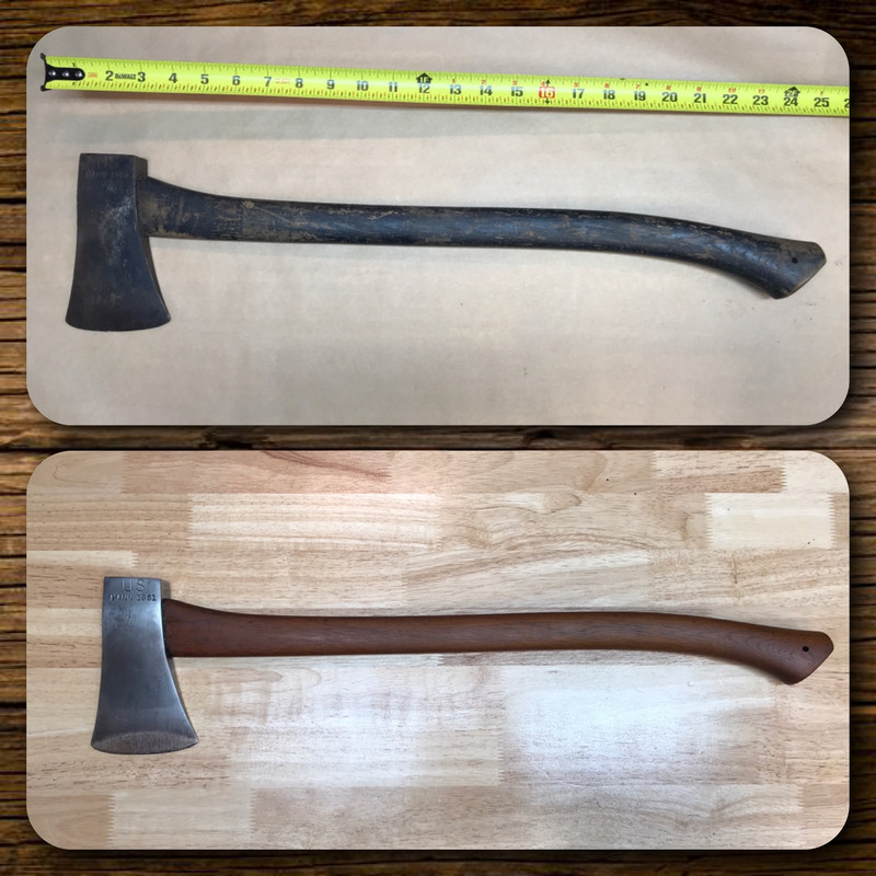

I rehung this Korean War era, Mann 1951 military hatchet. Haft and head had been spray painted black (military use?) so I removed the head and sanded both then wirewheeled the head before sharpening it. The haft was smoked in my BBQ for 18 hours and rubbed with a mixture of beeswax and BLO before reuniting it with the head.

Beautiful man! That's a handsome little hatchet. Super nice to have the year stamped right on it. What does the head weigh?I rehung this Korean War era, Mann 1951 military hatchet. Haft and head had been spray painted black (military use?) so I removed the head and sanded both then wirewheeled the head before sharpening it. The haft was smoked in my BBQ for 18 hours and rubbed with a mixture of beeswax and BLO before reuniting it with the head.
I think the wedge is poplar and I used slivers from some real dark hardwood scraps I had laying around to fill in the voids where metal wedges had be used previously.

I was going to say “They smell delicious!” But they really don’t.Yeah, that Mann 1951 turned out really nice! Smoker - that is fun. I picture myself using that and thinking, "Why am I hungry all of a sudden?".
Those Mann military hatchet all did, I gave my dad a 1944.Beautiful man! That's a handsome little hatchet. Super nice to have the year stamped right on it. What does the head weigh?
