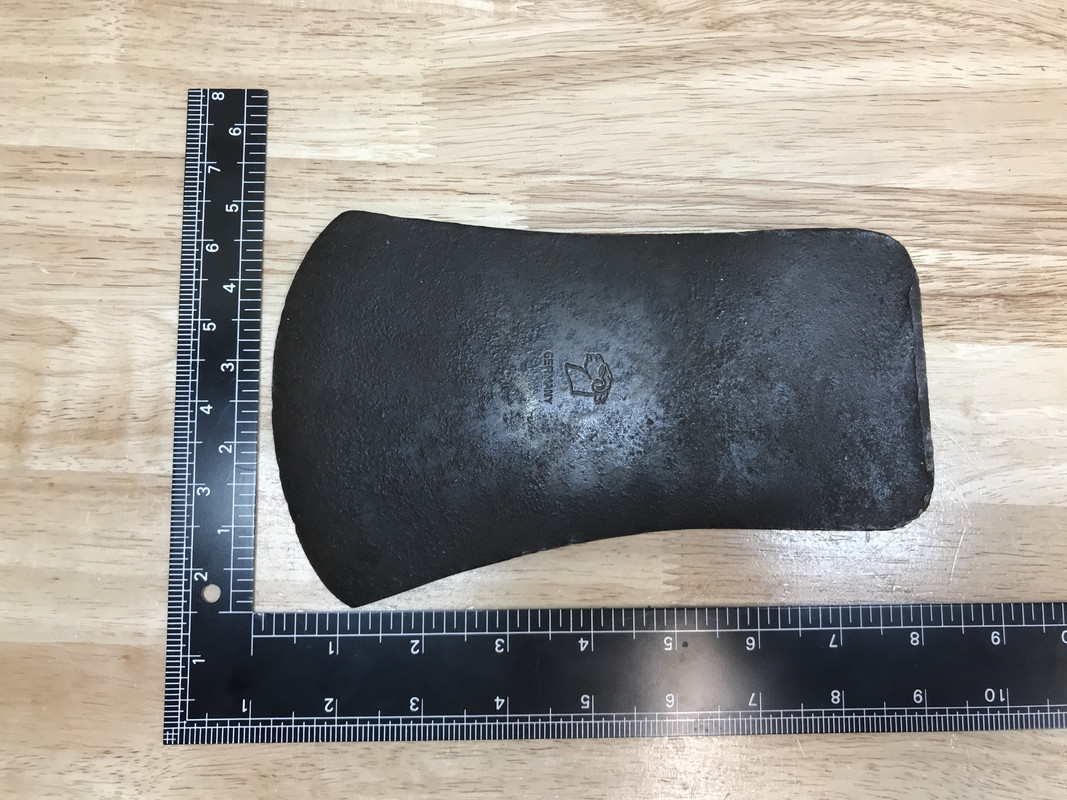

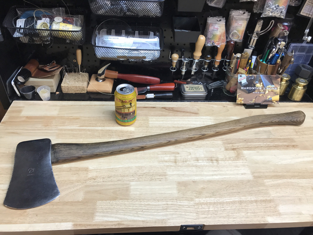

I finally got around to rehanging this Michiganesqué pattern German Axe.
When I got it the rust was thick and the poll a bit hammered.
I used the new handle I picked up yesterday from Hardwick’s, same style as the one AaronGP AaronGP got!
Unfortunately I did not take a photo of it sanded and looking bleach white nor did I weigh it before flame treating. But it feels lighter and more lively.
After flame treating, I rubbed some black wax in around the knob and up around the shoulder to hide file marks.
I used Caswell’s Cold Black Oxide to touch up the areas on the poll that I ground.
After hanging I used a little more black antiquing wax on the wedge so it doesn’t look like it was just born yesterday.
It’s got a heavy coat of wax on the handle now making it look dull. I’ll wait till tomorrow and burnish it to a low luster.
